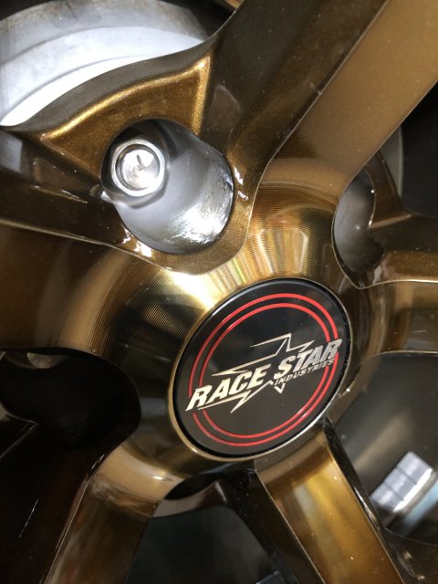

TPMS activation. Installed TPMS sensors in the new race stars, used units from summit that where supposed to be compatable with My 16 challenger. Mopar units, but car not picking them up, says SERVICE TIRE PRESSURE SYSTEM or something of that order in the dash display. These units the wrong units or just weren’t set up right when installed?
I knew I should have looked up the ones I bought and used in the 20x10.5 replicas in the spring and got the same ones BE2C14DC-FE77-454D-ACFB-660477FD8D00.jpeg image.jpg :(

Disconnect the battery for a few, then put some miles on the car.

I am not a big fan of battery disconnects. Besides I have never had to do that. All I can say is when a complete set of new sensors is installed it might take 20 minutes of driving to connect. So do 30 just to be sure. Once the car learns them they will connect sooner next time you switch them out. Car can learn and store 2 sets I think. Try hitting OK on the steering wheel. Go to tire shop and ask them to diagnose and wake them up. They have a device that will query the sensor. But the newer ones do not need to be woken up or reset. It's plug and play. But they can at least tell you if the batteries are dead etc.

Drove them around for a good while, i thought they where connected at they read 32 psi when 35 was in them but then went blank after about 10 mikes and never came back. Put the Nitto’s on and it read them before I left the drive way. There’s 8 of them in my garage pretty close to the car, 2 fronts which are original, 2 on original rims with 275 MT Street SS on them, 2 in the replica Nitto rims and these 2 new ones in the race stars. That was my thought too, take them to where I had them mounted and see if they get a reading from them. They where brand new, do they have to have a tab pulled on them to connect their battery or any thing??
