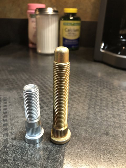

These correct? ARP on right, Stock from the dealer on left, they correct? Shoulder is shorter, will they work??
My measly .02 is that if that shoulder isn't as long as the flange is thick, I wouldn't do it...
Is it functional, probably, is it as resistant to angular torque as it could be, NO...
Again, just my .02

When you run slicks or something with good traction your stud needs to go into head of lugnut so it don’t shear off

Yea, agree, I don’t like them either. Will be spinning 315/50-17 MT Street R’s so I’ll be looking for exact match just 10mm longer then stock. Mine as well change the axels while waiting on them and spring :(
.02 always welcome
Thanks guys :)

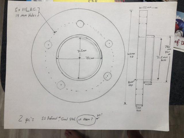

The 17x10.5 Race Stars with 315/50-17 MT Street R’s needed spaced out 12 mm so need longer studs for them.
Here’s a sketch I gave to my machine shop buddy to make me a set, adjust thickness as needed and pilot OD if a ring is needed.
That is such a perk when you got somebody in a machine shop that can make 'special' or 'just right' parts for your app. Buy that guy a nice Xmas present. LOL. Also, why can't he just make the concentric hole the right size instead of 78.1 with a pilot ring? Either way, 12MM is a hell of a spacer! I think 3 or 5MM would be my max comfort zone to compensate for rim tire combo.
3,291
7,771
Thread Starter #19
Race star rim pilot is 78.1, Hellcat is 71.5, allot of rims come with plastic concentricity bushings, the pilot on the spacer incorporates the pilot bushing into it. Yes, wasn’t too happy having to use a spacer but it’s the sidewall bulge of the 315/50-17 tire that’s the issue, a 305 wouldn’t need it. I need all the tire I can get and These are just track day combo so they’ll suffice.

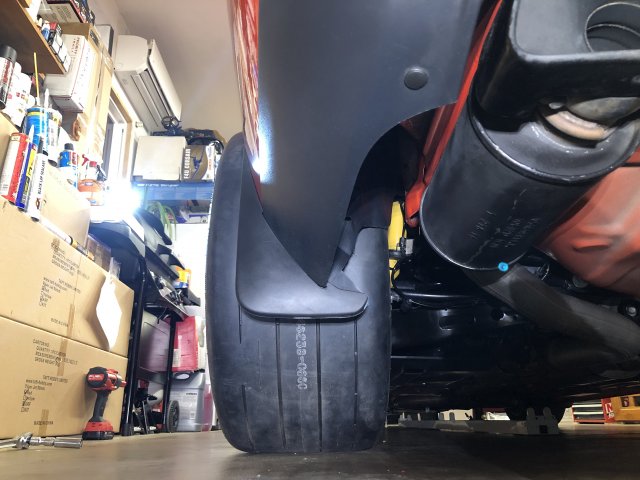

Thread Starter #20
Need wide body flares for these, it’s 2 mm from inner fender wall hard point that’s not movable, but if they hook, which I’m sure they will it’ll be hello 9 second passes 71254841-23AB-4C36-A448-F62AC1AA7BAC.jpeg C11B5965-92D2-4724-A582-7E1B6B05E8C6.jpeg 50FAEAEF-A967-42A2-91E5-E4635CD68142.png :)
