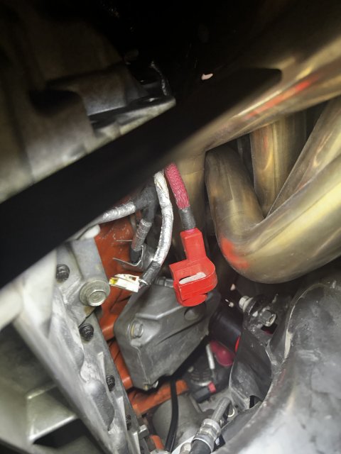

Really not bad at all to do IMG_3209.jpeg . I thank @Hunter for letting me know they don’t vibrate much

Really not bad at all to do View attachment 169248 . I thank @Hunter for letting me know they don’t vibrate much
Think you might have me confused with someone else.
What doesn't vibrate much?
Would love to take credit for it, but that's not me

I thought you got the BMR mounts installed? Sorry, maybe that was @Diboblo
Yeah... me.
Like them a lot. Not noisy. No vibration.
Just a little sc harmonic, but would do it again.

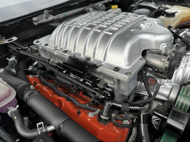

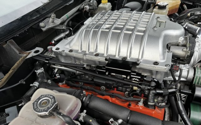

Finally cut my coupler I got for my 108mm throttle body to JLT intake and put on black clamps. Got rid of the double clamp and cut up jlt coupler I’ve been rolling around on. Got some 6an hose separators coming in tomorrow that’ll fit the 8an ptfe fuel lines for my flex fuel sensor better. Here’s better pics of the setup I made and how I routed the fuel lines/connections. Hoses will look neater tomorrow after new hose separators come in.

My car is so loud I doubt I’ll even notice lol. Taking my sweet time torquing everything down, aka as tight as I can for most of the bolts lol. Just have to tighten starter power wire nut, throw on starter heat shield, driver side mount heat shield, and bolt for steering linkage
FYI, I notice the vibration lol

Two 90 degree hose ends - 1 has a fore female 1/2” efi fitting connected to the end of the 90 degree hose end (connected to fuel rail) and the other has a 1/2” fore male efi fitting connected to the 90 degree hose end (plugging into the plastic fuel line jumper that used to go to the fuel rail). Fuel feeds to the sensor first, and then loops around via the 180 degree hose end and goes into the fuel rails. It uses a Motion Raceworks flex fuel sensor fuel bypass so that there’s no restriction in the fuel system. Fuel flows through the sensor, and around it at the same time. Hoses are 8an PTFE, with steel bearing around the PTFE liner, and nylon braiding over that. I custom made the wire harness myself, which tucks neatly into the front fuse box while it’s closed. No gauge if wires in the cabin - it uses a Bluetooth transmitter that plugs into the sensor, and is readable via an app live along with the fuel temp. I made the bracket out of 1/8th” aluminum. I need to touch up the paint on it a bit. Some low profile hex screws and nuts from McMaster, longer ARP bolts to secure it to the supercharger and the lid, ARP washers fit perfectly in the circles in the supercharger lid, so the bracket makes no actual contact with it
