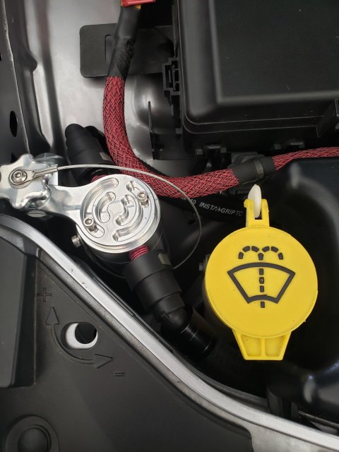

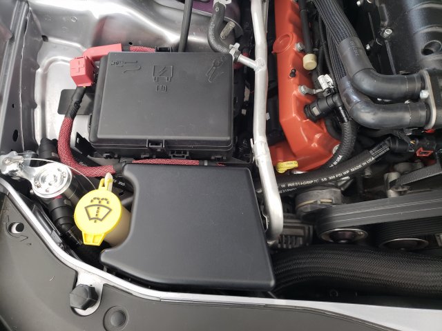

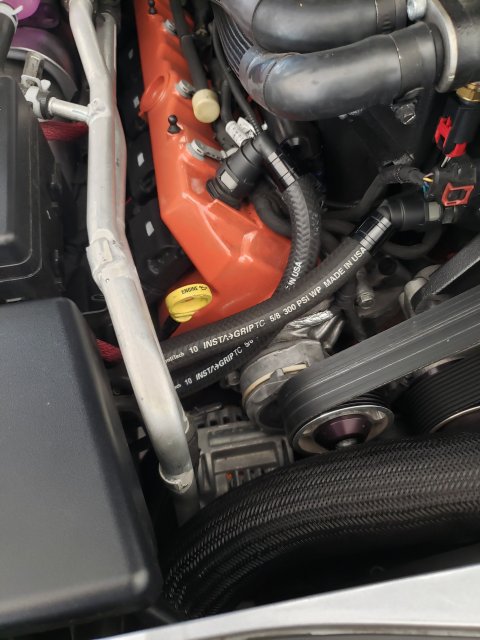

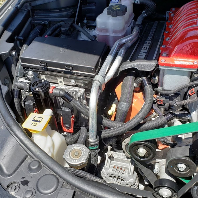

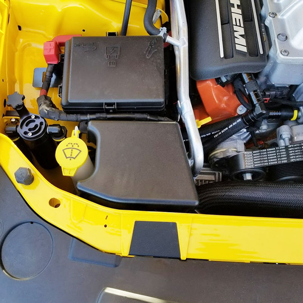

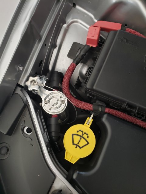

Found a great deal on a new remote UPR catch can on ebay. Only issue the kit was for a Trackhawk. It also had the check valve and knob upgrade. It would mount in the middle of the fuse box instead at the fender. It also has straight fittings instead of 90's coming from the can. There was also an auction for 4 feet of the same hose used on ebay. The hose from the valve cover actually was long enough. I had to add a longer section of hose to the blower. I routed around the washer fluid and went under the black panel covering the brake lines. I also had to buy a bolt and some washers to mount it. I'm in it $160 compared to $300.
The last 2 pics are what the Trackhawk kit looks like installed a Challenger/Charger kit
View attachment 108079 View attachment 108080 View attachment 108081 View attachment 108082
I have the same one, that’s a great deal

I’m a serious DIY’er. I tried to do a remote like that on the Challenger but just couldn’t find a good path to route the hoses, so I made a bracket and did the conventional mount. Works well, still tight and secure after 13k mi.
If anyone needs hose, 5/8” fuel line works well.
