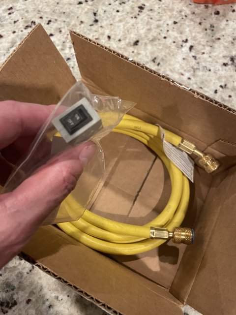

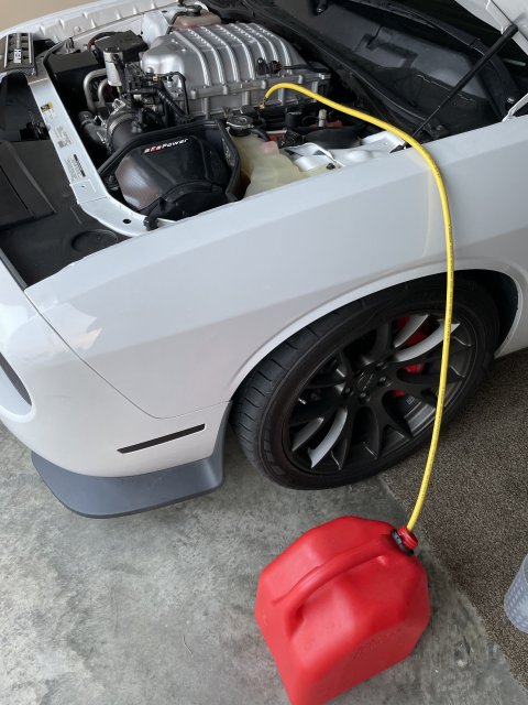

Might be a dumb question, I’m new to swapping fuels. Are you guys depressurizing the fuel system before hooking these up, or just sticking one end in the gas can first and twist the other end on at the fuel rail.. and any pressure will shoot off in the gas can? Trying not to make a mess lol

What’s the button for? I have the same line, I just screw it in it’s fine it won’t leak, put the line in the can at first if you want. Just drained fuel last week

It’s the on off switch for the fuel pump relay from hhp. Ok so hook it up turn it on and it starts flowing that’s it. I guess no worries about depressurizing like when doing it at the connection in the back

Nope, odd they sell it with a switch. They told
Me just to start the car and let it run until it stalls lll

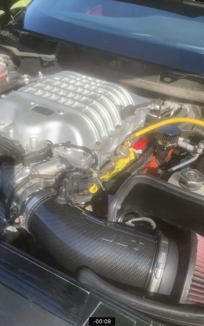

Ez fuel drain kit.

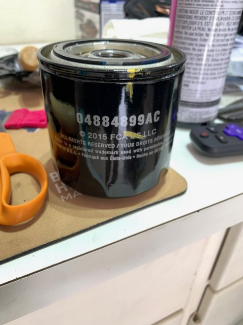

I also grabbed the Fumoto valves using the part numbers that one of y'all jokers provided so future changes will be that much faster. I already had an oil filter magnet so while I see the need for magnetic drain plugs wherever they can be used, I've been real satisfied in the past with Fumoto valves, especially if you're doing oil analysis, makes taking a sample too easy.
I had a breaker bar handy for the filter just in case and while it was snug, it wasn't on there any tighter than it should have been and came off easily with an oil filter wrench. Likewise the oil pan and cooler drain plugs came off the way they should have and I appreciate the advice of keeping a crescent wrench on the oil cooler to prevent the lines from getting tweaked.
Factory filter was black and marked as such:

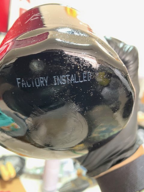

Nice shot of factory installed nomenclature
