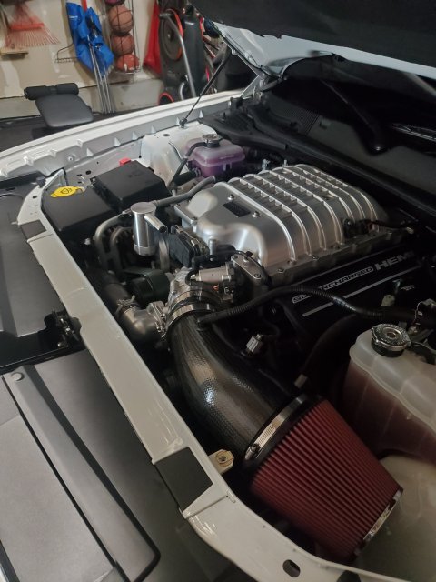

I could be wrong but maybe it is the picture. Are you able to put the splash shield on your LMI? It looks like the filter may be set to high.
Each their own on the splash shield it is just an easy way to tell
I own a redeye so it uses a different intake setup due to the hood. My hood doesnt have heat extraction vents.

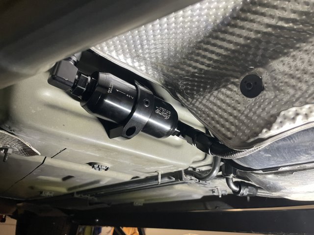

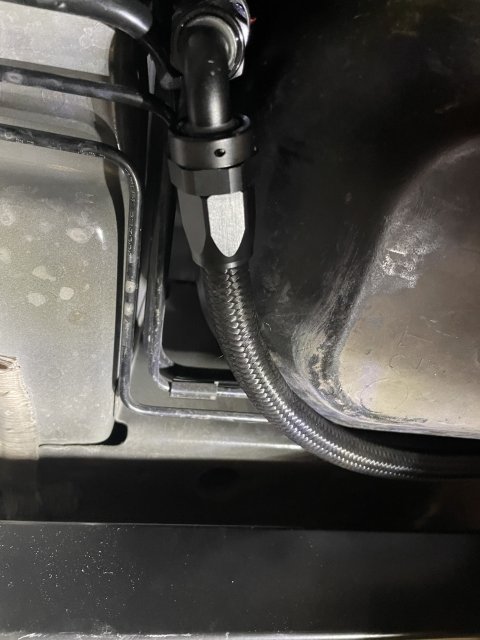

Installed my Fore Fuel filter, getting ready for that e85 life.
44853B04-799C-4934-98AE-64DC32AA24A1.jpeg F5E1A3B3-7535-4F42-8A7C-874D0A623A17.jpeg C27D8185-1E65-4A0D-9E0E-CC2E265C71C0.jpeg B7EEC94E-FCA0-4F5E-B9D0-CA864AFA5134.jpeg
Took a spin on the highway, no leaks that I can tell of and fuel pressure looked good.

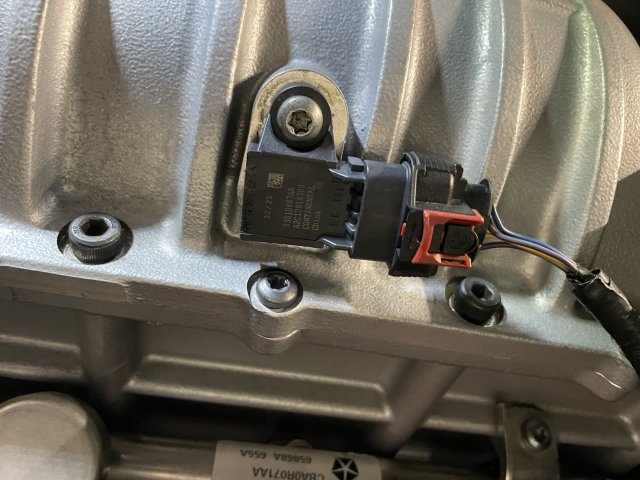

Replaced all four map sensors with demon sensors as I’m making more boost than they can read.
Feel bad for the engineer who’s wife was getting bent over by a mechanic that it made him so angry that he put a map sensor on the back of the supercharger and the only way to get to it is to disassemble the damn engine bay.
View attachment 59149 View attachment 59150 View attachment 59151
I never heard anyone doing that as it being an issue
It's actually quite common for people that have maxed out the 2 bar map sensor. The reason I have to do this is that my map sensors are dropping out at full boost with the 2.72. There are many threads on it on the other forums. As you can see my map sensor is reaching it's limit but I know I'm still making boost as the pressure ratio is still accurate. (This was a 9.7 pass so it was definitely making boost and not slipping). When you move to SD tuning it is necessary to ensure you have all the data you can as unlike with ANN you will not be able to make a mathematical model of what the car is doing.
I am working on adjusting the tune this evening, i.e. copying Demon tune data over where appropriate.
