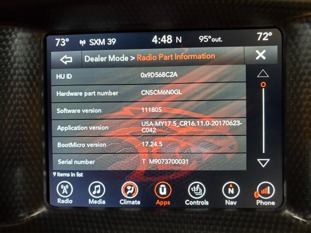

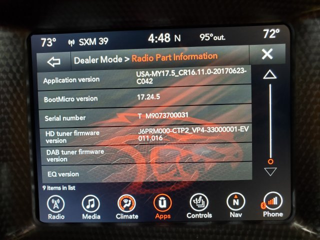

Austin
2017 Charger Hellcat
Thread Starter #20
I realize this version is older than what some are saying, but UConnect says it is the latest one for my 2017 Charger Hellcat.
Thanks
