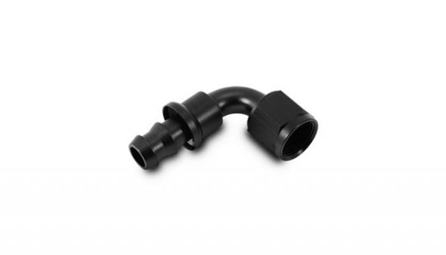

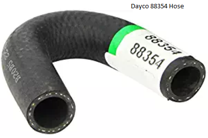

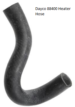

I’ve spent some time a while back looking for pre formed 3/4” hoses to help with routing in tight spots. These are my goto’s but there may be better ones that you can buy and cut up. You can also purchase hose fittings of varying degrees to use to connect around bends and curves. Less likely to leak and easier to service.
View attachment 112543 View attachment 112544 View attachment 112545 View attachment 112546
