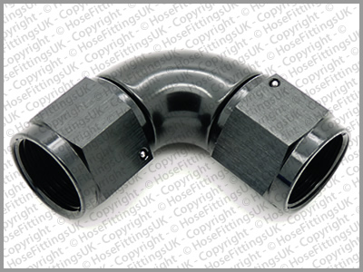

That's a lot of tight 90's .
When I built the dual 450 pump fuel system in my Monte I used these off the external filter, and before the dual feed/dual cross over rails:
Love me some full flow 90s in that -10 AN PTFE feed line. I believe in maximizing flow potential.
