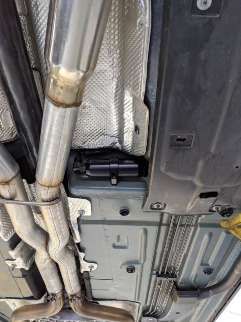

I have one installed very similar to that one but 128mm instead of 88mm. Injector Dynamics recommends an inline fuel filter especially if you're using E85. You just want to make sure you're using the micro glass filter.
Here's mine installed.
4,870
11,001
That's a lot of tight 90's .
Yea, but it's just about the best location to mount one of this style. There are other types of filters as well but would like require mounting in a different location. The 90s dont seem to affect anything though, my car put down 892whp with it.

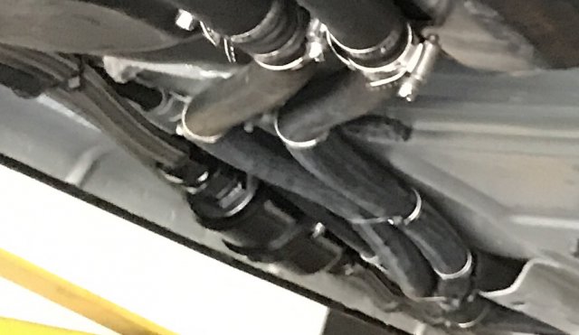

Fore is arguably at the top of the heap when it comes to fuel systems for these things and that filter is a part of their high end package. I have the triple 525 system and use that same filter. I don’t have a good picture of that but it can be seen in one I have of something else under there and I cropped it down to see the filter. I say use it. F385171D-E900-48B5-9330-15908DC9F93E.jpeg
