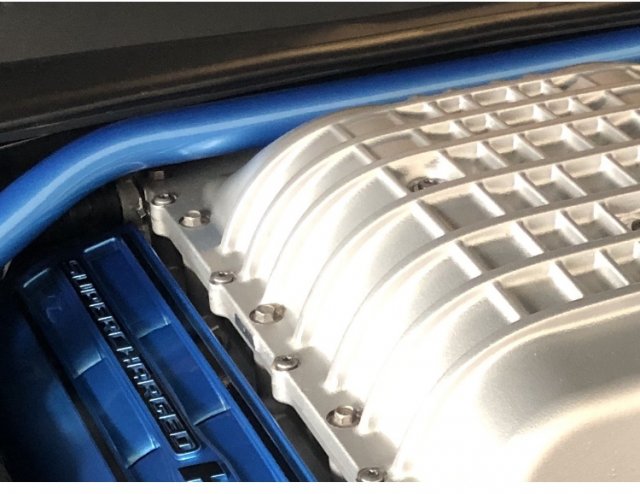

The thicker FI plates wont work, it seems, with the PG brace. These don't appear as thick, but still may interfere with the brace. Theres not much room at all between the sc and the brace, and the factory black bar above the brace.

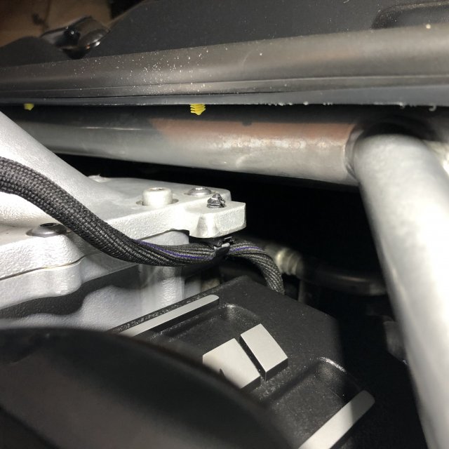

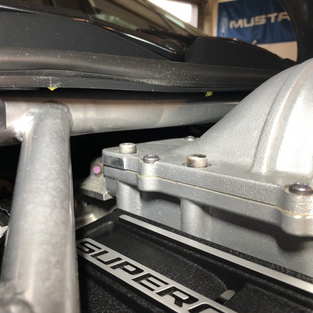

I just looked at mine and it has plenty of room. My brace is a Speedlogix. It looks further back than yours and looks to have an inch clearance between the top of the bolt and cross bar. But, it will have to come off to install the spacers.

Alain, those bolts are factory. The sc has not been off the car. The rail covers I got from one of our members here. Thanks for the kind words.

It might depend on what brace ?... but my Speedlogix 4 point strut tower brace fits with FI spacers still with 1/2" gap & even racing it & engine torqueing over it doesn't hit the brace.
