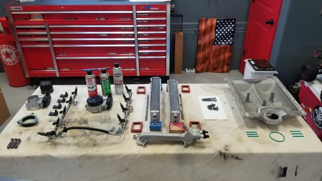

Thread Starter #159
All cleaned up.
1,571
3,922
looks like the Doc is prepping for surgery :)
