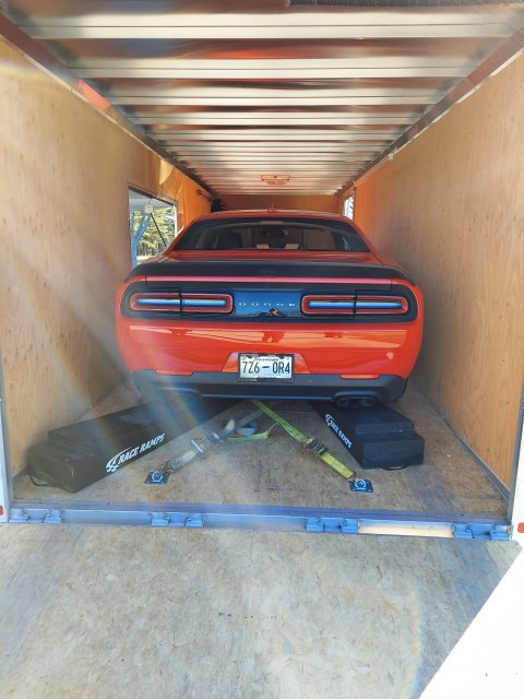

Weight is out. Car is loaded and ready to head to Houston tomorrow.

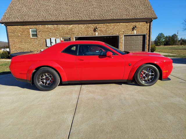

Car looks amazing as usual. Can't wait to see this thing run.
Thanks Ron. It'll be fun to get some 1/4 mile laps on this thing. I hope it runs good.

You guys have fun down south and keep us posted. Wished I was going.
Bo, you must have taken all of the usual parts off the car that are easy to remove.

Yes Mike,
I removed the sway bar, the pass and rear seats, trunk stuff and obviously the lightweight wheels and tires.
One of the first things I want to do is weigh it so I have a comparison to the '19.
