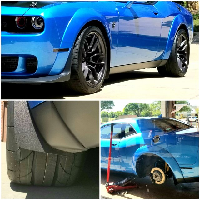

After having the 2019 Redeye for 1.5 years and 2300 miles, I could not get a good hookup under 60mph on the stock Pirelli's all season tires. Had Nitto 555RII 315 35 R20 installed on the rear. Not only greatly improved performance but think the rear profile looks better too. Have not yet driven in the rain. Traction improved, no increased tread noise and vehicle dynamics not changed.

Nitto 555RII's are the shit for daily driving.:p

Couldn’t agree more !!! I can’t wait to go back to Nittos at Some point.

Lone Star...did you keep the stock Pirelli's up front?
I've had my '19 Redeye WB for a year and 3 months. Weekend street car, good weather only and off the road in winter.
The Pirelli's are the worst on the rear. Am considering keeping the 305 All Season's up front and putting 315 555R2's on the rear, keeping stock rims for now. Anyone running like that and anything I should be aware of? What tire would y'all rung up front with the 315 R2's out back?
Thanks in advance for any inputs! Appreciate y'all with more tire experience than me.

I run the stock tires up front, no issues At some point I will put the 555G2 on the front to compliment the R2 on the back

FCA was an Italian based company and their tire sourcing was to an Italian tire company - Pirelli. Many years ago I had Chassis Systems Procurement and Quality responsibilities at DaimlerChrysler. One of which was a $1 Billion annual tire buy for the Chrysler Group. I benchmarked all US and European tire suppliers with my Mercedes counterpart and we concluded that Michelin was the world's premier tire supplier primarily based on their process and quality reputation. They are more expensive. Unfortanely for Michelin being a French tire company, Mercedes had a bias for Continental tire company being a German based company and tied support for their F1 program to tire sourcing. I have had Michelin tires on several performance vehicles and highly recommend them. I kept the Pirellis up front on the Redeye. Stock 20x11 Devil Forged Rims all the way around. Left Discount Tire with 34 PSI all tires. Have read to get better 0-60 times is lower the drag radials to 26 to 28 PSI. Next on my things to try..... Have only done a few 40mph rolls since getting the Nittos and it is like having a new car with much improved hookups....
