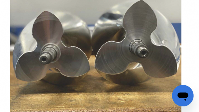

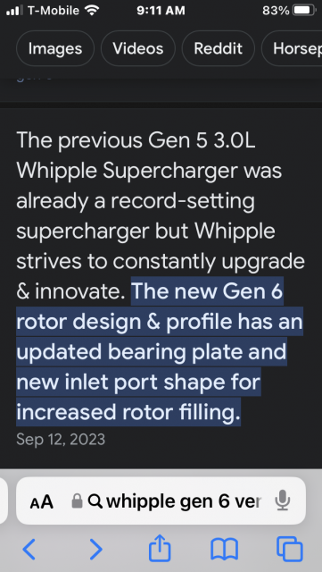

Gen 6 was developed already?
Yep, supposed to be a bit more efficient rotor design. Rotors are pinned to the shafts as well, and just a bit bigger.

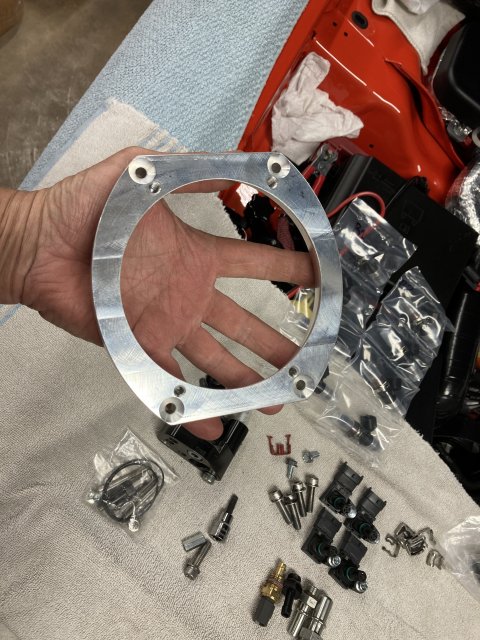

What size tb are you going to run?

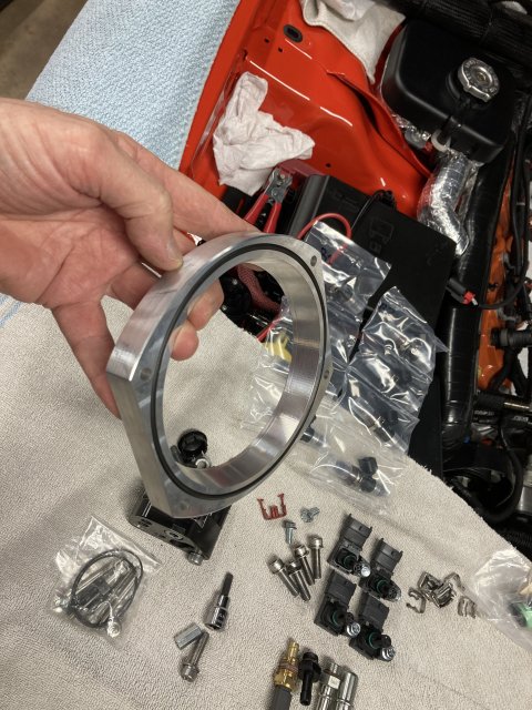

Putting the Nick Williams 112 back on. Have a specially made adapter for it.

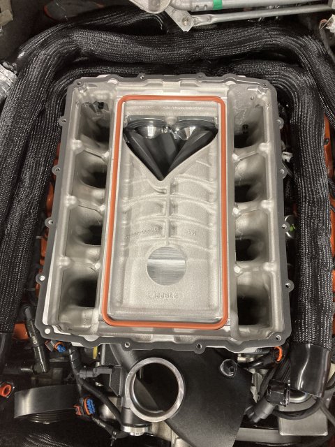

Thread Starter #1,569
Look how much fatter the 3.8 is then the 3.0, rotor case protrudes into the intake runner area even.

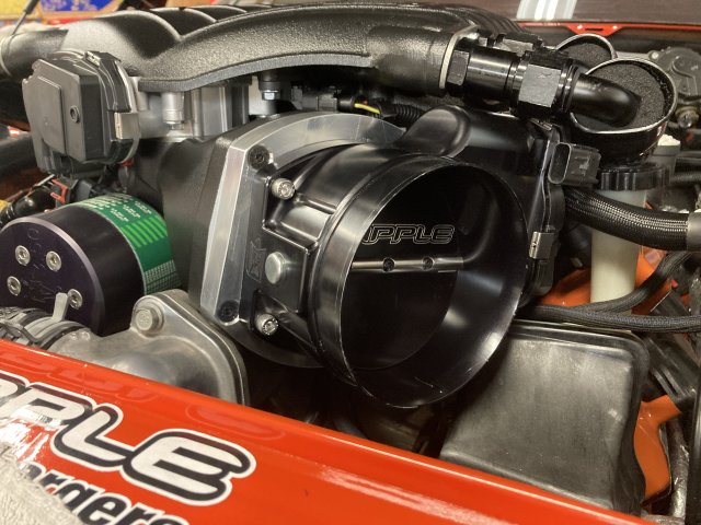

But even the huge compared to stock TB the 112 looks puny and out of place on the huge inlet of the 3.8. I may have to go to the 130 just because of that, just doesn’t look right.

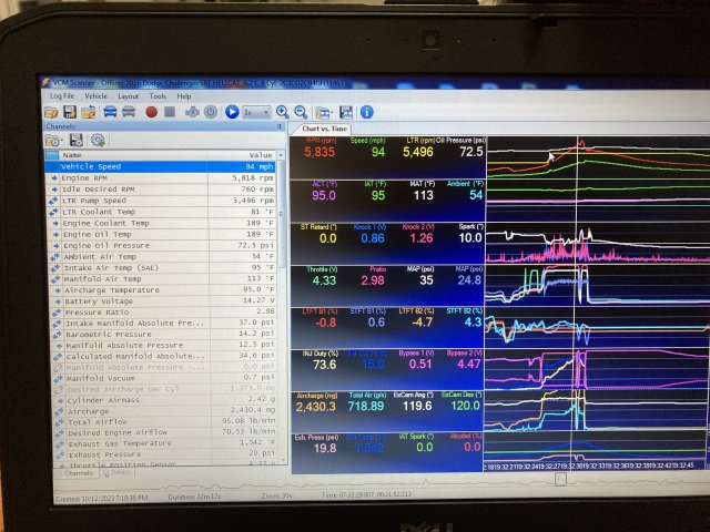

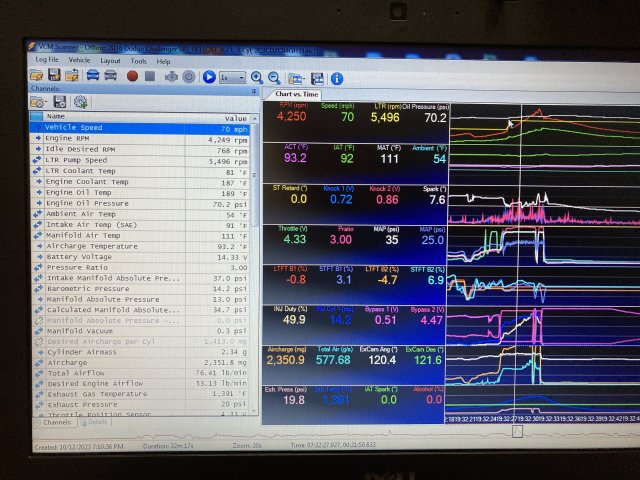

But it sure flows enough!!
3.00 Pressure Ratio baby!!

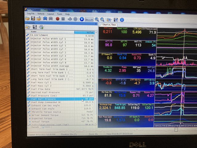

Unfortunately now I’m out of fuel pump, time for a third pump.
But man even with just 5 degrees of timing and slipping the thing pulled it’s highest third gear G force ever up the concrete test sloop bridge I do such on, .85 G’s of continuous acceleration. Felt GREAT!!!

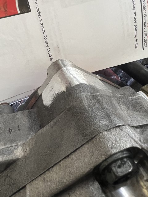

First hurdle, stock fuel rails do not fit on the 3.8, there’s no mounting points for them provided :(
Whipple cut me a GREAT deal on the Fuel Rail kit for it, THANK YOU Whipple!!
NICE kit, much nicer then Fore kits I have seen View attachment 118448
Why doesn’t yours have the extra brick in the middle?
8,745
7,679

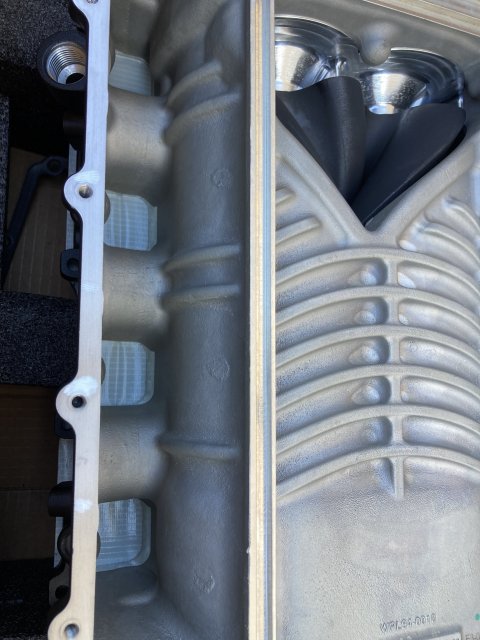

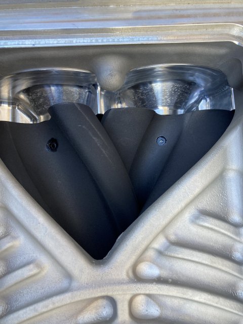

Next hurdle, without spacers blower snout is hitting block keeping it from mating to heads and sealing on gaskets. Good thing in look for this stuff. Hard to see it, I wonder how many are going to get tightened down without seeing this and have intake leaks and stress out into the blower housing!??
View attachment 118462 View attachment 118463 View attachment 118464 View attachment 118465 View attachment 118466
Surgery time
View attachment 118467 View attachment 118468
A little paint and like new again
View attachment 118469 View attachment 118471 View attachment 118470
My 4.5 hit on the same area grinder the crap out of it
Cooling bricks are in the lid, they’re all the same 3.0 and 3.8 Gen 5 and 6 unless you get the thicker ones for use with a spacer. I have never seen a separate cooling block in the middle?
8,745
7,679
I have seen several 3.8s with the spacer in the middle, specifically the billet ones. @GNBRETT’s has one, I think a few others
