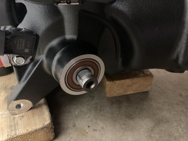

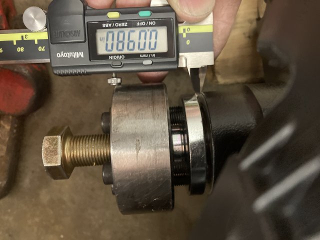

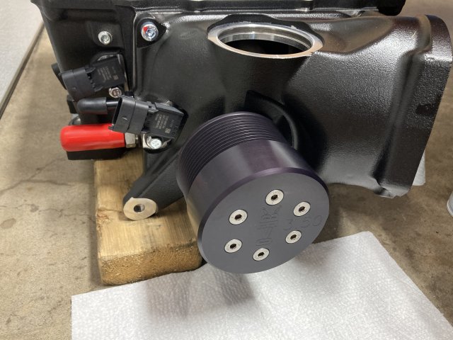

really interested in a clutched pulley for the whipple, I assume your testing one of these for them.

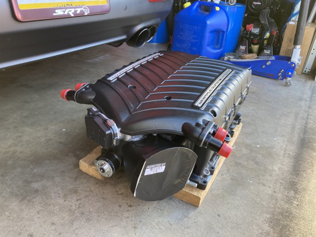

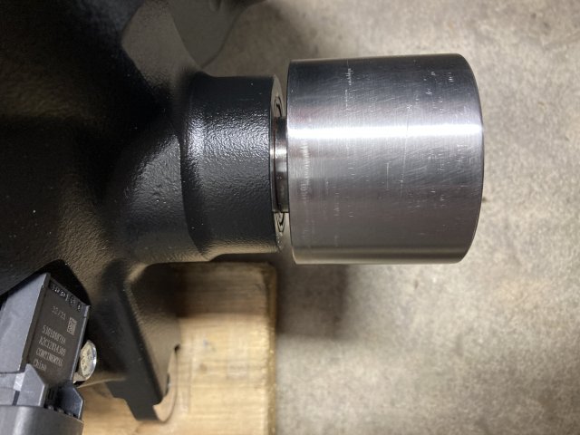

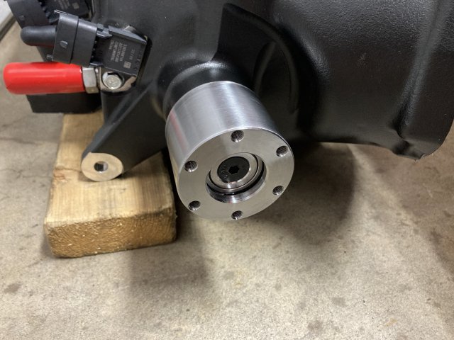

Finally installed the clutched pulley for the Whipple, but not on my 3.0, on a new Gen 6 3.8 :)
IMG_7831.jpeg 71754151422__BB90507F-C7AA-4E73-A828-A277CE43808C.jpeg IMG_7984.jpeg IMG_7986.jpeg IMG_7993.jpeg IMG_7994.jpeg IMG_7999.jpeg
Went on with no issues, spins free and true. Next, on too blower installation.

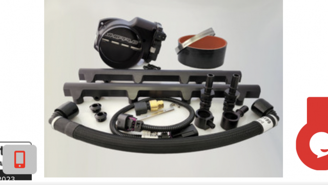

First hurdle, stock fuel rails do not fit on the 3.8, there’s no mounting points for them provided :(
Whipple cut me a GREAT deal on the Fuel Rail kit for it, THANK YOU Whipple!!

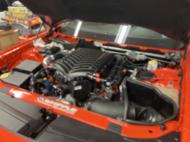

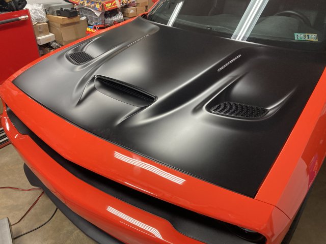

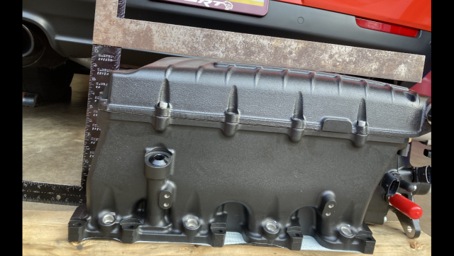

On to see if the 3.8 will fit under the stock 16 hood. Some readings on the internet say it won’t .
Yes!! It fits!! But unfortunately not with insulator spacers :(

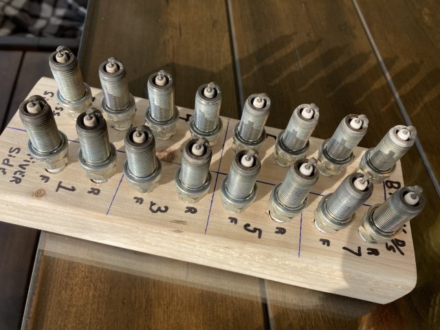

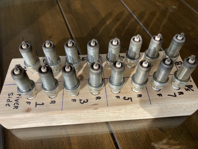

Before we get too far first need to know how engine is doing. Spark plug check and leak down test.
Spark plugs, not bad looking for about 5000 miles, these are the same plugs I started the engine up on.
For re-install Reducing gap from .023” down to .018” as planning on just a tad more boost :)

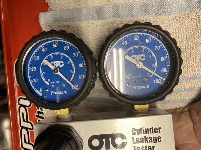

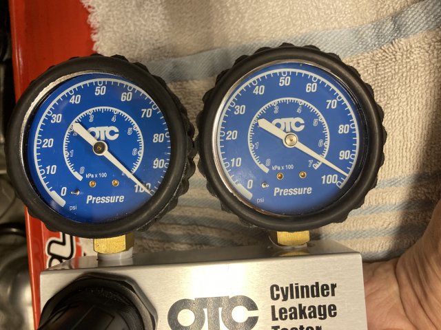

Was happy to see leak down test on all cylinders was good, whew!!!
Did it twice, just to be sure lol.

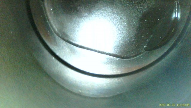

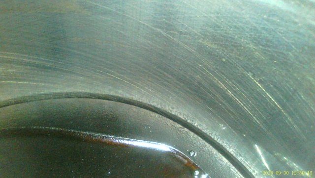

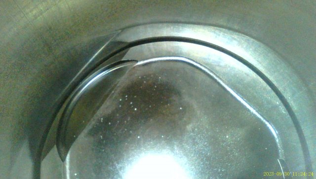

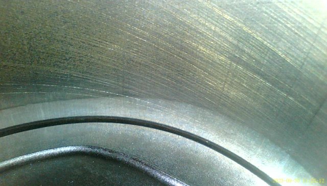

Quick look at the pistons, DAMN!!! corn runs clean!!!
LOVE this borescope!! Nice cross hatch pattern still, looking good!!

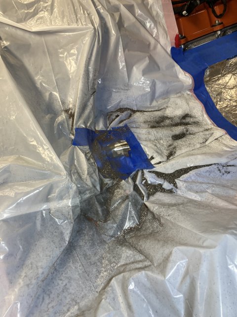

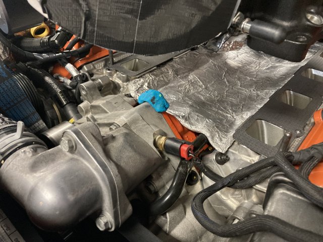

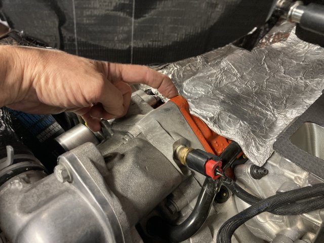

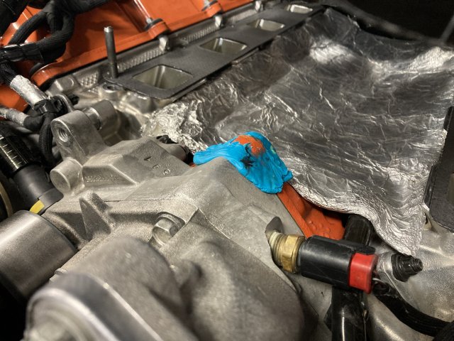

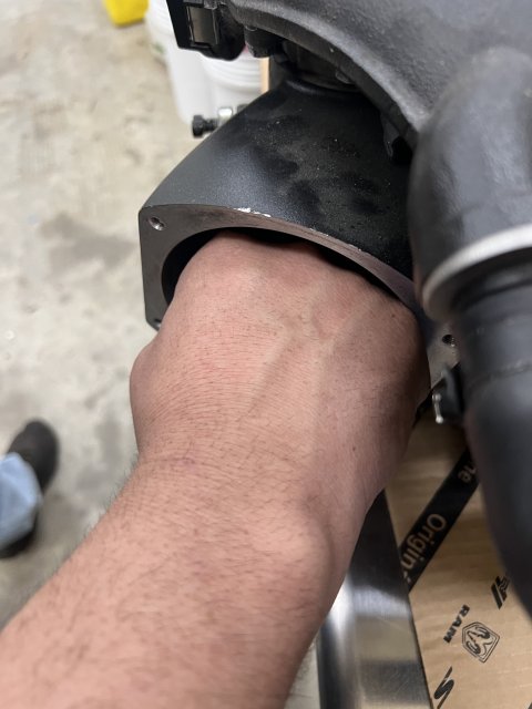

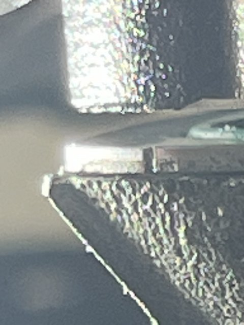

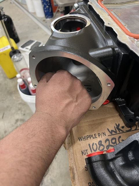

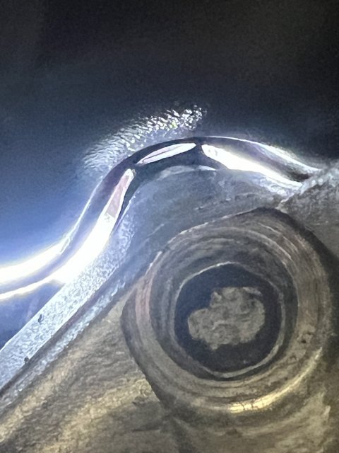

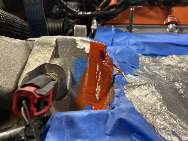

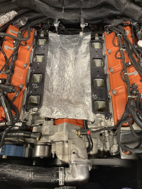

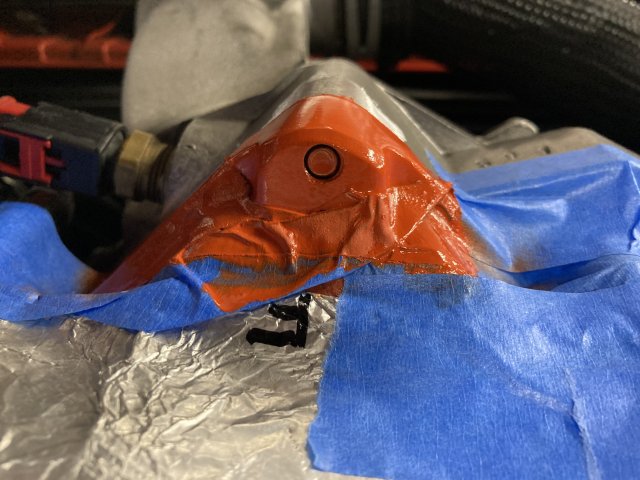

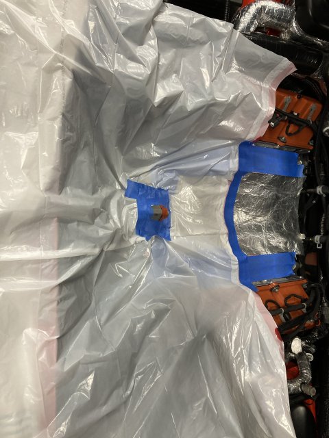

Next hurdle, without spacers blower snout is hitting block keeping it from mating to heads and sealing on gaskets. Good thing in look for this stuff. Hard to see it, I wonder how many are going to get tightened down without seeing this and have intake leaks and stress out into the blower housing!??
71798610707__54A98E89-A293-47F3-9019-3D827626A5FE.jpeg 71798613886__DFBD883E-3FF4-4192-A087-66B7EC710ABE.jpeg 71798631663__5C71F712-B1B6-4407-9D8A-ADA5A394DDE5.jpeg IMG_0604.jpeg IMG_0602.jpeg
Surgery time
A little paint and like new again
71823575581__AF735FA6-B789-4989-BDC2-678A48028600.jpeg 71823574488__98A8F478-B847-409D-8073-D558D0A97D53.jpeg 71823725465__F7FCB2CA-7272-42C5-90E4-44BFCA03547E.jpeg
View attachment 118462 View attachment 118463 View attachment 118464 View attachment 118465 View attachment 118466
Surgery time
View attachment 118467 View attachment 118468
View attachment 118469 View attachment 118471 View attachment 118470
Odd it hits. Did you let Whipple know? Sure looks the same as gen 5, whats different?
NICE kit, much nicer then Fore kits I have seen View attachment 118448
Ditch the hex head bolts for the rails. 1st time you need to take them off you will wish you did. I went with same style small head bolt you told me to use for the blower itself. I can use a ratcheting wrench now for the rails
Yes, I emailed them pictures, snout on the 3.8 is a little different, it’s got just a tad bigger inlet area.
