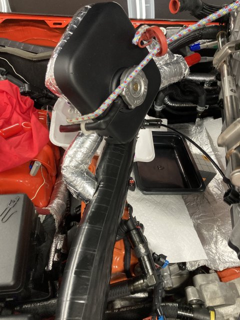

Cover ports first thing
Then work on disconnecting coolant lines, I HATE coolant!! Idea here is don’t loose much if any (ie no mess to clean up)

You got this down to a science, nice work

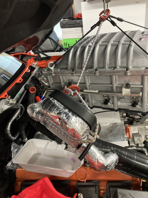

Do it with some pre thought and you don’t loose much coolant, no mess, and blower is still full of coolant for next use.
Secret is have caps plugs and small pans at the ready and in place

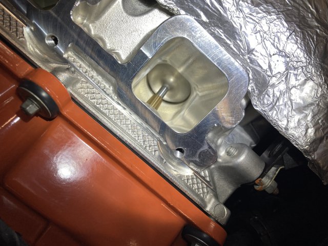

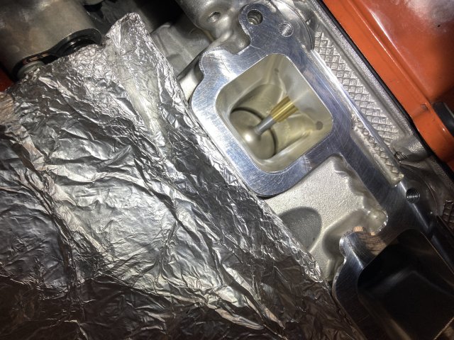

Thread Starter #1,387
About 150, about 125 of them at WOT lol
Thitek porn I mean port work for ya’ll to touch yours selfs with 😂

Mike - how long is each cable in the blower lifting setup? You have the perfect length to do it with hoist and hood on. Would like to duplicate and have ready just in case.
I think I got them from McMaster Carr and the eyelets too . I’ll look up a part numbers for you and post it.

no worries - I bought the McM eyelets after you posted before, just wondering about the cables. thanks
I searched and searched can’t find where I got them from, but they are 37” long end to end about 3/16/ to 5/32” diameter.

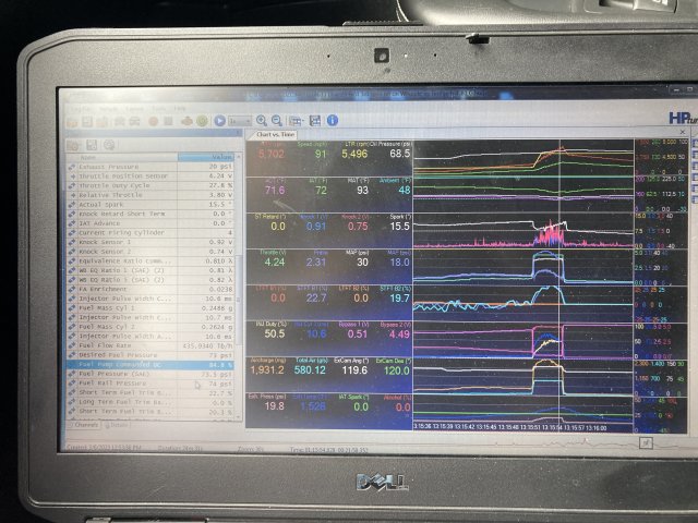

Ok, so did a quick 3rd gear hit before the snow comes tonight. Need to add some WOT fuel back in but look at the fuel pump DC and fuel pressure, I’m back to ok fuel delivery wise with my original ported Hellcat fuel rails and injector DC is only a tad higher then before with fuel pressure showing dipping to 58 psi with the ported RE rails but injector DC stayed around 50 % which tells me fuel pressure was really not dipping to 58 psi.
Any one care to make a guess here as to why? I think I know and why we are seeing lulling fuel pressure in a Hellcat with RE fuel rails.

Also only 19000mg aircharge I fired you made more than that

Went to 6100, belt is a hair too long, boost not there. I’m going to modify the AAD idler to work with the Whipple and see if that works. See how jagged the slope is? It was spinning all the way to 100

Peak boost right here, 22.6 psi, almost 22000 air charge, till belt said enough I guess
