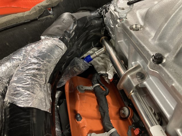

How to keep the fuel mess at bay, have a cap Ready and waiting
And cover the fuel line with a small plastic bag ASAP to keep the crap out of your injectors
