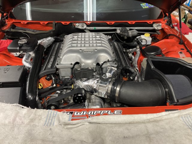

Started up today finally!!! No more tick tick tick on cold start now, damn header leak!! Roads would have been for a test hit but ran out of time. Backed it out of the garage, dumped the 3 1/2 gallons of straight distilled in the coolant system, pushed it back in the garage, will fill it with coolant in the morning and maybe take it out for a hit.

I'm confused, why do you have an IHI on there, didn't you dump that???

He's testing the Satera decoupler pulley.
What cai is that? Looks like a good gasket on there.

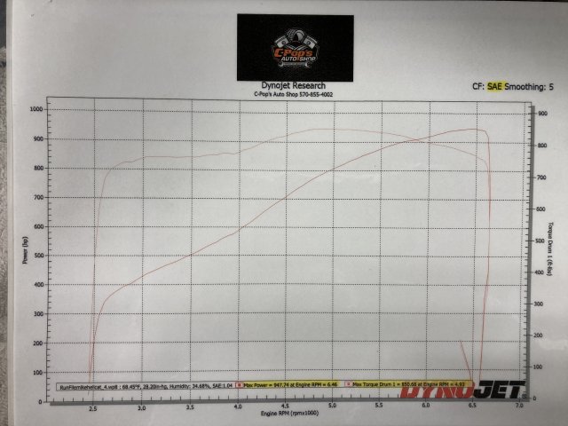

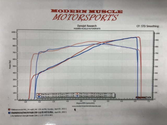

No, that my ported 2.4, I just redid it with new bearings etc and testing the Satera Rings of Hell clutched pulley to see if it helps with the over rev between 3rd and 4th I’ve been seeing with locked up Litens pulleys and the solid pulley on the Whipple. This Satera pulley clutches so free on shut down the blower whirls for 3-4 seconds after the engine is off, sounds neat hearing it whirl! Satera is supposed to be making a clutched pulley for the Whipple soon but I may be selling my 3.0 Whipple while waiting since it’s still brand new unused from warranty replacement and stepping up to a 3.8. We’ll see how a test hit goes tomorrow hopefully. May dyno the 2.4 ported heads combo also and see what it picked up from the porting since I have data from 2 different dyno’s on the 2.4 with a 2.72 which both netted right at 945-950 wheel.

Looks like 6600 RPM was the sweet spot on that setup. What picked up the 50hp/tq in the middle on that?

That’s my Whipple CIA, need a longer coupler to get the filter into the box all the way and the box to inlet tube gasket on it but it will work for now as is

Not spinning on the dyno lol, first pass cleaned the tires off
