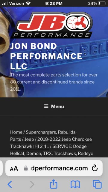

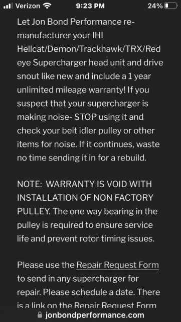

Bond has been rebuilding superchargers for 20+ years, all kinds from cars to industrial giant ones. Here’s his warranty clause on a IHI rebuild
B5737E8F-B183-470F-B9C4-01F44C64E5C5.png 18632727-6731-4895-B27E-1DF571C9A610.png
The “Rotor Timing issue” is the key issue a decoupling pulley helps prevent.

The way that warranty reads a litens isn’t covered either. Could be any smaller pulley spinning the blower harder.

He is ok with smaller pulleys as long as they are of a decoupling variety.

It says factory not factory style. Legally speaking he could deny anything he wanted that wasn’t factory

That he could and he’s not the nicest guy sometimes, he’s in business to make money not give it away, his own words.
Having these blowers apart and seeing what holds them in time, a small ring about the size of a large man’s wedding ring I fully understand why IHI used a decoupling pulley. If the timing could be pinned, which some shops say they do but pinning the driven rotor and getting its timing just right gots ta be a bitch.

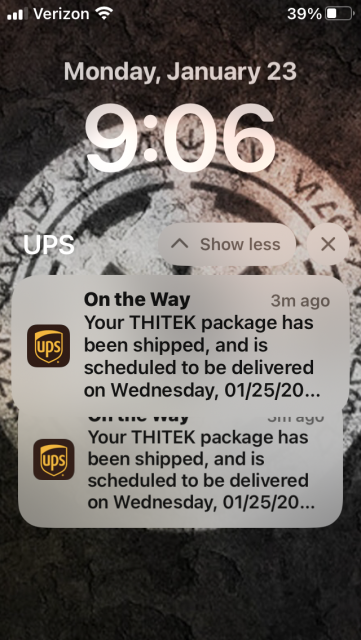

Guess I know what I’ll be doing Thursday :)
