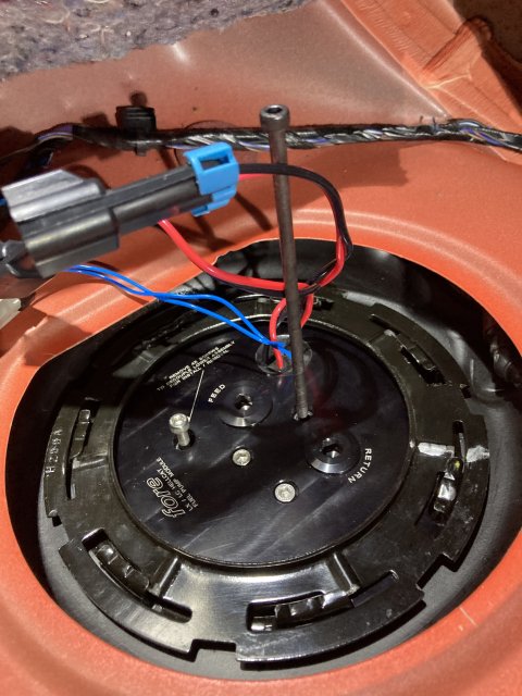

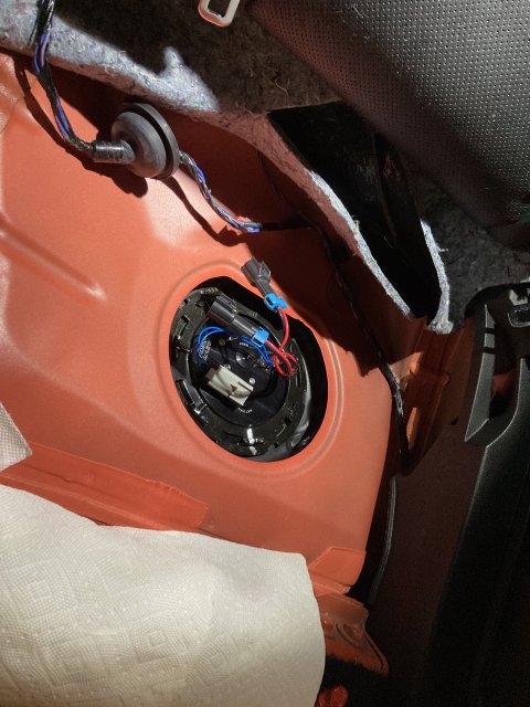

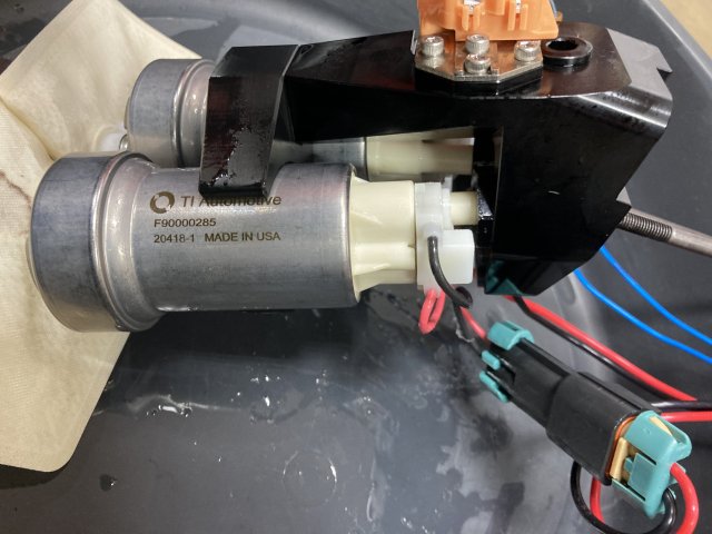

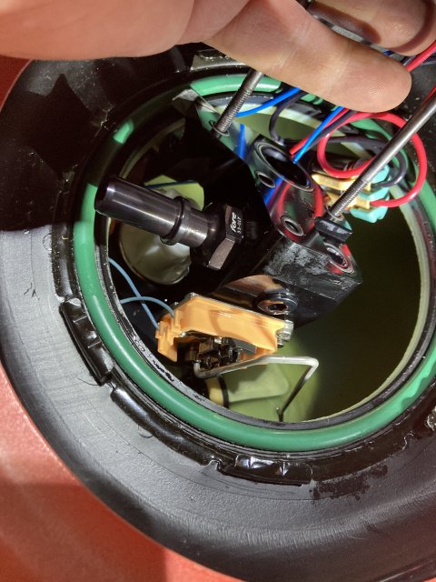

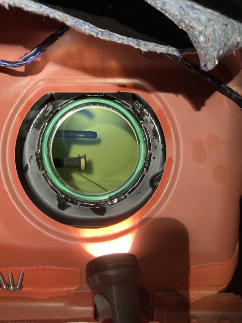

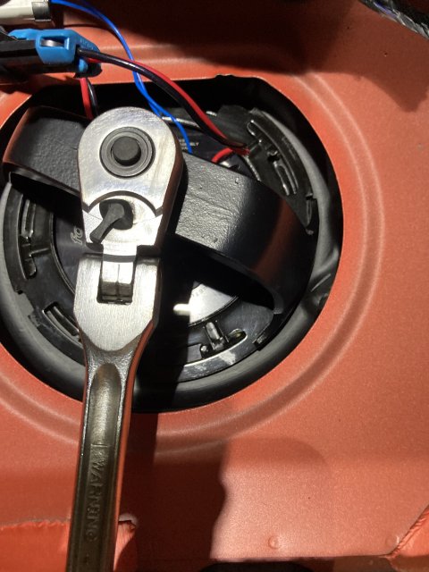

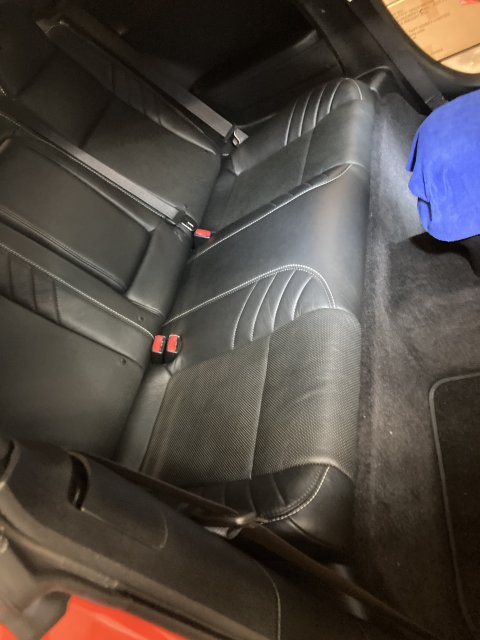

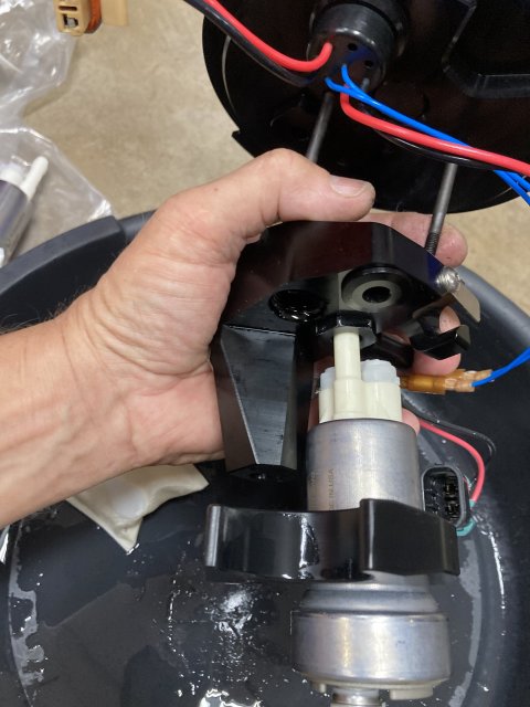

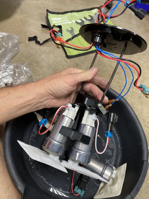

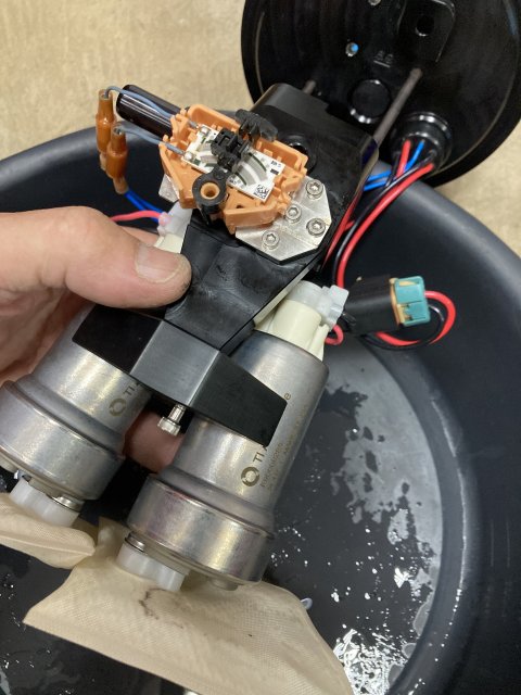

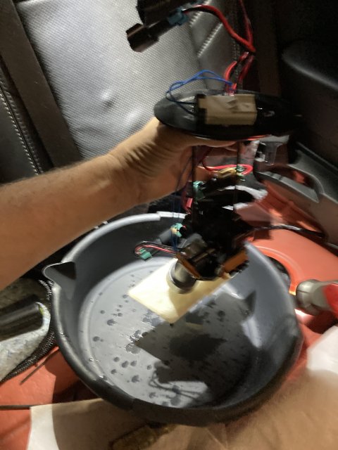

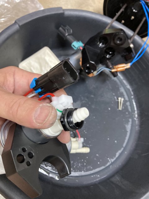

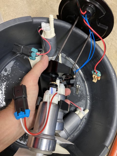

Fuel pumps changed, I took a bunch of pictures to make a step by step on how to do it, not hard, done in less than an hour.

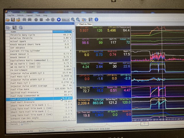

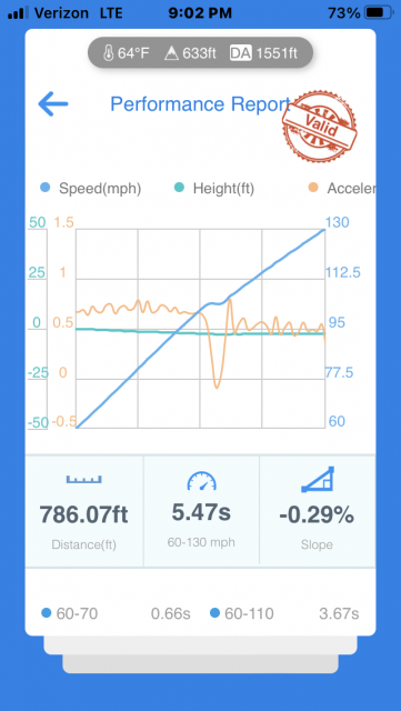

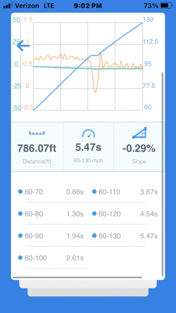

OK, here’s the results, first 3-4 hit tonight, gained about 1/2 second in the 60-130 running from prior runs last 2-3 weeks. My PB in about 0 DA 45F air was around a 5.78
C96E8388-071B-457A-9A9D-0B0D5C0DE97E.png 3556F90F-4060-4BFF-9A38-0450338B83E6.png
But this is it for the fuel system and injectors even with upgrading the pumps to the 295’s, it’s done pump and injector wise.
6ABDE4F6-3B1F-49DC-9204-9669D68F9930.jpeg 127C2626-DBC7-4180-B065-B52065DB6E82.jpeg F028753F-A189-4F83-ABE2-FEF318CA581C.jpeg
Perfect pick of pulley size, 3.00, netting a solid 22 psi accross the rpm band with a peak of 22.6 psi, PR in the 2.65 range. No doubt she’s over 1000 wheel now, dyno shop guy is on vacation, will hit him up in the near future. I see 10 second street 1/4’s on the horizon :)

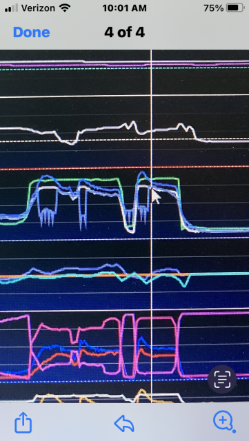

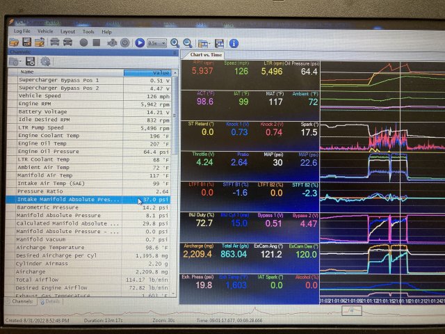

I thought you said the 3.0 pulley made 28 lbs?

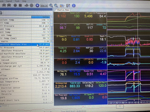

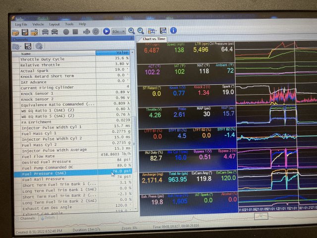

But remember I said I’d have to review that? That was at a quick glance at the laptop screen and was 28 psi of manifold pressure, minus 14 for atmosphere it was only 14 really. 22.5-23 is the real number after reviewing last nights log with a belt that wasn’t slipping
Before, the blue line is boost, see it fall off
Last night, see boost hold steady?
See the 37 lbs of manifold absolute pressure? Subtract 14.2 baro and boost is about 22.8 psi, MAP shows it at 22.6.
The guy posting pressure numbers with the pulley sizes listed being driven by a stock size lower must be mistaken in what he’s interpreting as boost numbers, he may be looking at manifold pressure and not subtracting baro if I had to guess.
