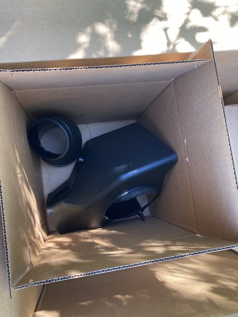

In the box yet, dont plan on using it, its smaller then the JLT. I’ll take some pictures of it tomorrow. But here it is on the reveal pics.

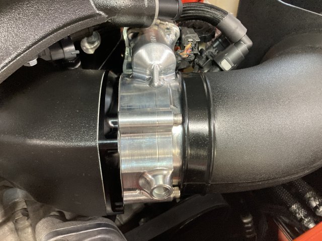

It’s the tube that’s concerning, like the TB adapter it’s sized for the stock TB. The JLT matches a 105 perfectly.

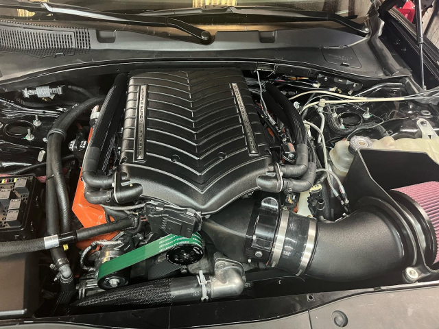

Could be because your kit is a stage 1. The stage 2 comes with the 112 throttle body and the intake looks the same size
Or the JLT is just bigger and they use the coupler to neck it down

Your probably right on that, makes sense. Be getting busy soon. My HHP 105 came with a size for size sleeve That fits perfectly on the JLT and its throttle body and looks almost exactly like the picture you posted of the Whipple 112 set up

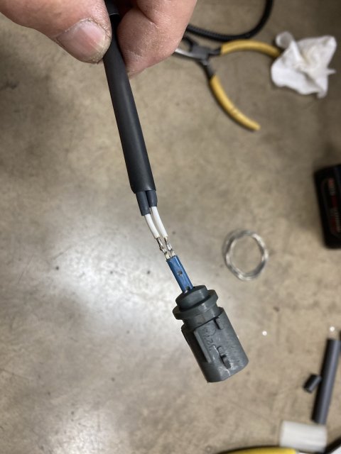

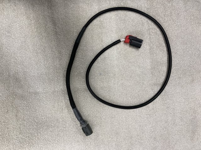

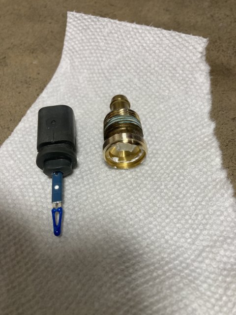

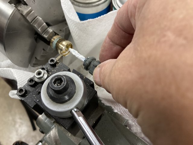

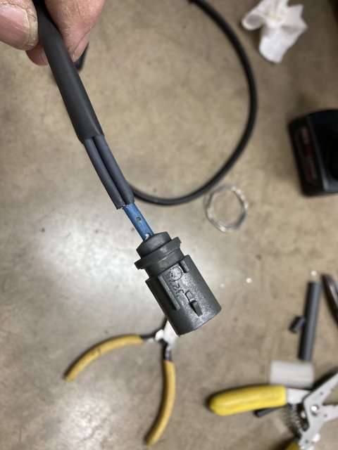

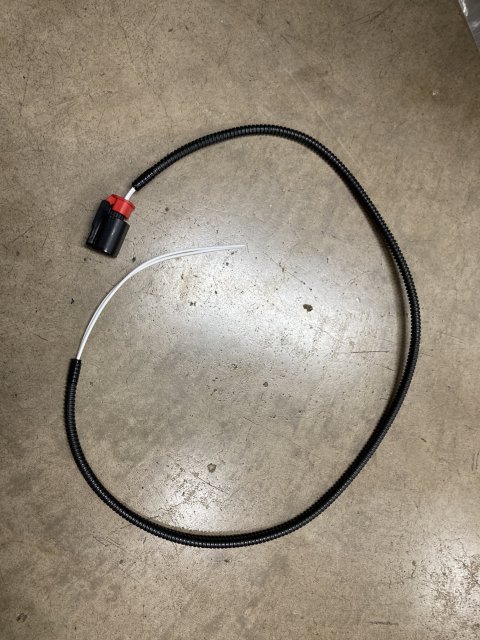

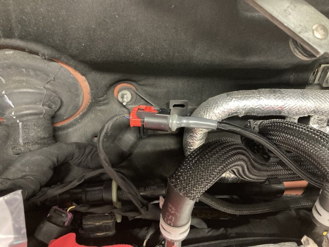

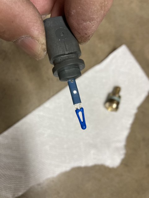

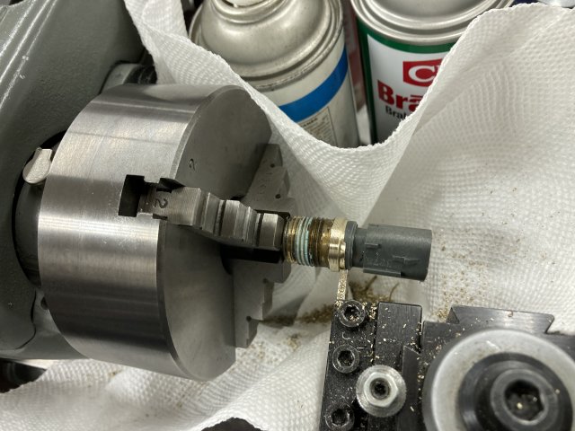

Short coming in their kit. They give you a harness extension because the supercharger intercooler temperature sensor is in the front now not in the back of the SC so they give you an extension with instructions to cut your original plug off your wiring harness and solder on this extension, well I just couldn’t bring myself to doing that. They should have just made a complete plug-in-play harness I mean how much does a plug cost? 10 bucks if that? Well it cost me 35 because I bought a new temperature sensor put the new one in the supercharger and cut the guts out of the old one and made my own plug for a plug and play harness. 1 unplanned hour of today gone but worth it.
359F06C3-0BB0-4976-923B-F6994A955F1F.jpeg 870EBDA3-768A-42D7-A1CA-3BC515812D2C.jpeg 0B083717-256A-4881-8571-D36C67536168.jpeg 028E6DC7-9A32-4E36-A6B2-A96C8CBD937A.jpeg 05D11038-193C-46D2-96B3-DEFE9AF3DDC9.jpeg C6D79192-66ED-4B9F-AF1E-E412E8256060.jpeg AF3294C5-D50A-44EF-A7FE-1B8373BB0A63.jpeg 4422909C-163E-4F3D-9437-12860C34DD62.jpeg 875E7141-27E9-4414-99F1-EB011EE109D5.jpeg 48BC2ACF-B0CE-412B-BED8-DEBBC4F95825.jpeg

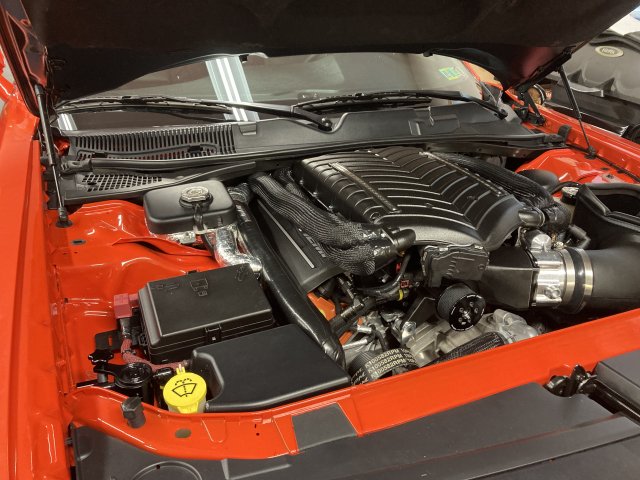

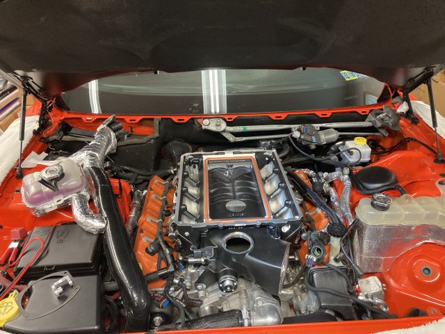

Loooooonnngggg day today, 1 cup of coffee and 1 cookie all day but she’s almost ready!! Damn it’s full under that hood now!! Tomorrow morning fit a belt hopefully I have one that will be the right size. And then change the fuel pumps and give it a whirl!!!
5C4A3F90-F306-4C19-88D2-10B173989401.jpeg 11AEDA9A-A0E9-4E6F-83BF-1447D4388E43.jpeg

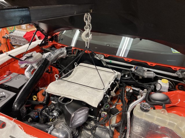

did you lift the Big W with the similar setup as removal of the IHI?
3,819
9,045
Thread Starter #1,075

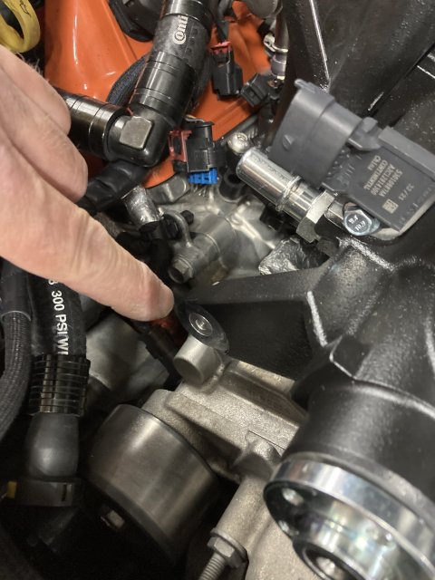

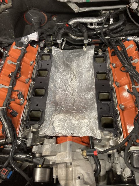

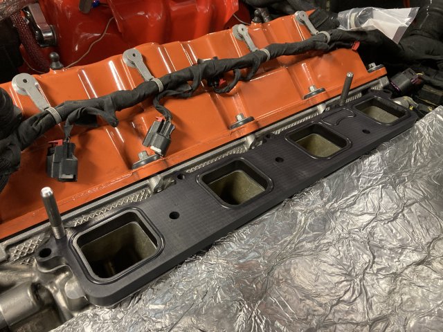

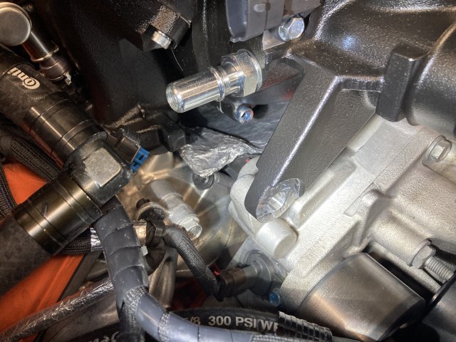

Yes, works slick

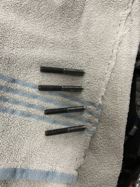

Made alignment pins to drop it down on since there’s no dowels I didn’t want the insulator plates moving.
1309A66F-D80B-4D94-8740-7B1AC2524814.jpeg B9024A8D-24E1-4CEA-9EFA-C0CB671B5851.jpeg 451D41D0-676D-4529-98A7-0DA0C118E67E.jpeg 7FBDD88C-501E-4EDC-B9A1-2B7E7993C3F9.jpeg D32999C7-C1F9-4AF7-B68B-1AF011CA3E44.jpeg

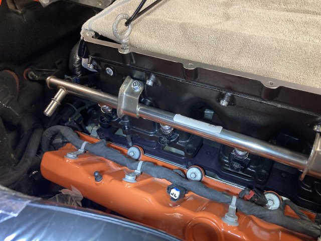

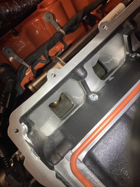

Straight shot out of the intercoolers past the injectors To get the mix and right down into the valves
47E49D34-E7F3-4FCE-8775-F4A2CD43164C.jpeg D2967BA9-8BF1-4B52-9A26-1CD84DD1B553.jpeg

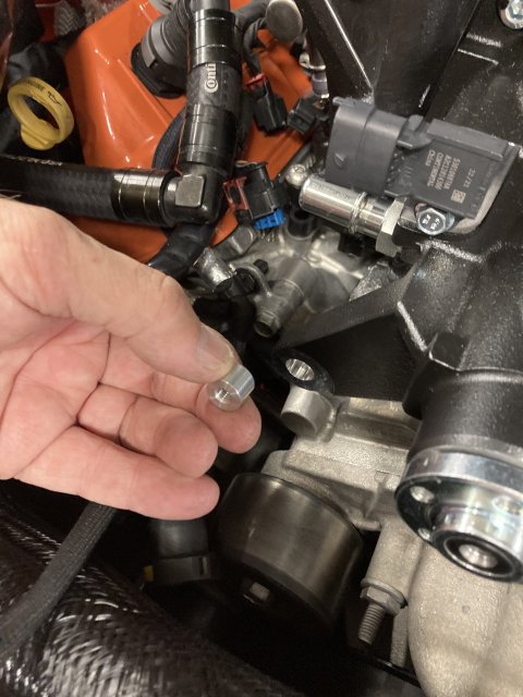

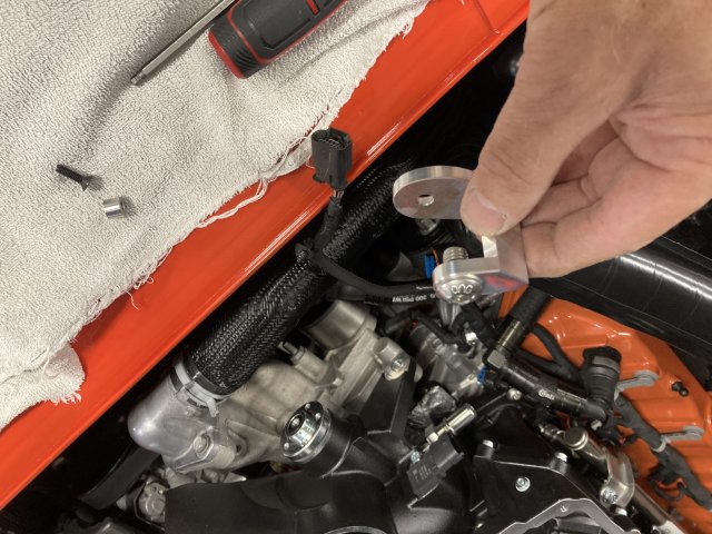

@vortecd

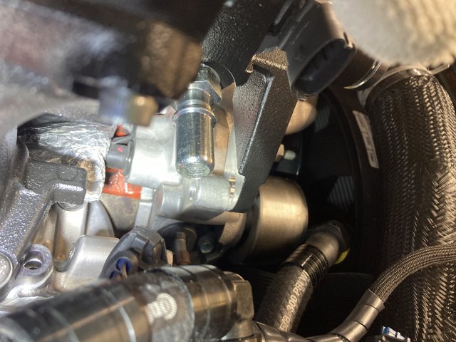

Here’s your spacer bracket you wanted to see
ACFD04E2-6786-471B-B188-B332E8AD3BDE.jpeg 54837C63-D6BC-4720-A7D6-F4FA508E05A1.jpeg 1B265470-B507-4FC8-97E0-DD9CF25D83C3.jpeg 87BE632B-45DE-4D8A-B939-9DC48BBA803D.jpeg 4B4FEA24-0453-4A16-8B39-23BE348AEF59.jpeg 9F8DC09E-C76C-4022-A2E7-2210C1D913B1.jpeg 88E2E900-E9FB-45AB-B4EF-2EA918FC1867.jpeg

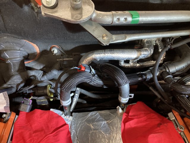

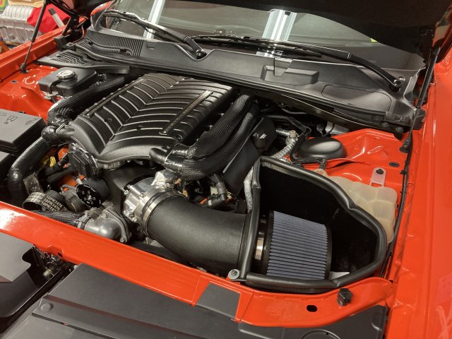

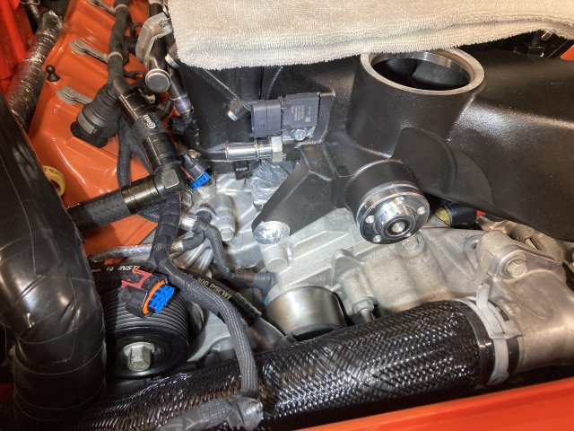

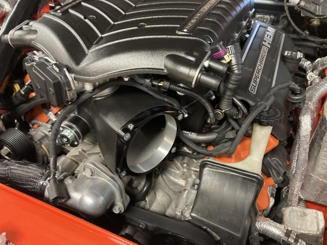

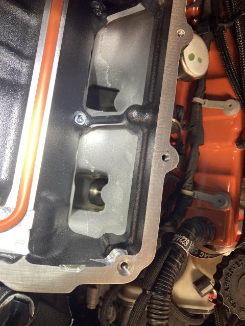

I ended up having to remove the JLT air box and snout and filter, would not work with the new position the TB ends up at. In the process of installing the Whipple air box I broke the motor actuator off the top of my chiller drag valve 🤦🏼‍♂️ was mounted to the valve with a plastic bracket. I had to massage a step into bottom of the Whipple air box with a heat gun to clear it, what a pain, Now I’m going to have to machine a new bracket out of aluminum or something so right now my chillers in drag mode only which is no biggie. This morning starting on the fuel bumps and then hopefully I have a belt that fits and then test ride hopefully :).
7296CCF5-3A71-4DFC-9361-89038B0745EA.jpeg F4E306CB-C9B9-4F99-BB86-1B915E9EF0A5.jpeg DA03705A-43C2-46B9-A94E-B1660FD3654B.jpeg The snout was actually large enough and was a perfect tight fit over the inlet of the HHP 105 but then wasn’t long enough to make it to their air box so I had to use a silicon coupler but then it all fit. The insulated lines hide the valve cover covers which do fit back on using the stock fuel rails. It’s all close to the hood, no way any thicker insulators could be used.

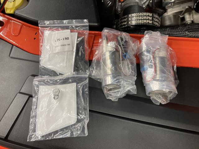

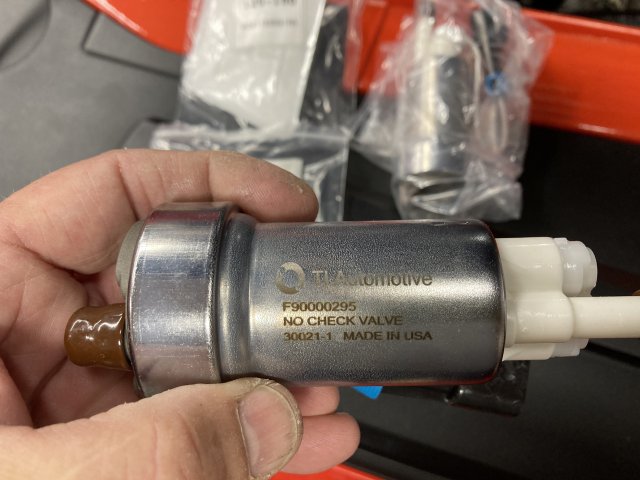

New Fuel pumps
Ti 295 pumps, 540 liters per hour at 40 psi verses 485 liters per hour for the 295’s but at zero head, They should give me a bit more headroom for maybe some more horsepower
