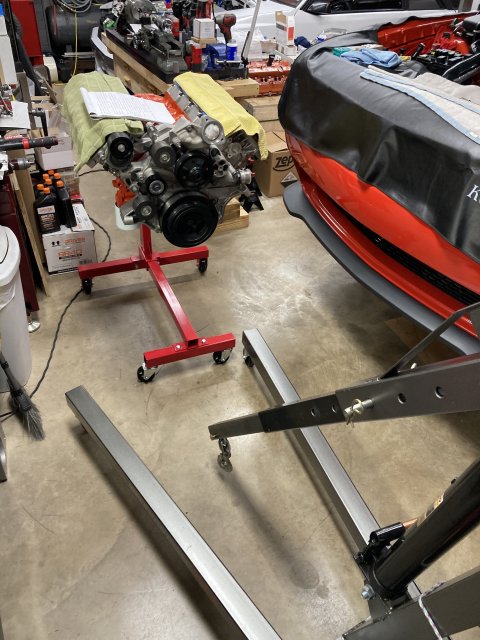

Today’s the big day going in the bay, either the engine bay or Chesapeake lol 😂
Wish me luck, I’m by myself as usual, one man band 🤞🙏 4654E703-5474-4DA9-9355-F5118FB21556.jpeg :(

Good luck man. Wish you were closer… I’d give you a hand in a heartbeat.
Wish me luck, I’m by myself as usual, one man band 🤞🙏 View attachment 48092 :(
