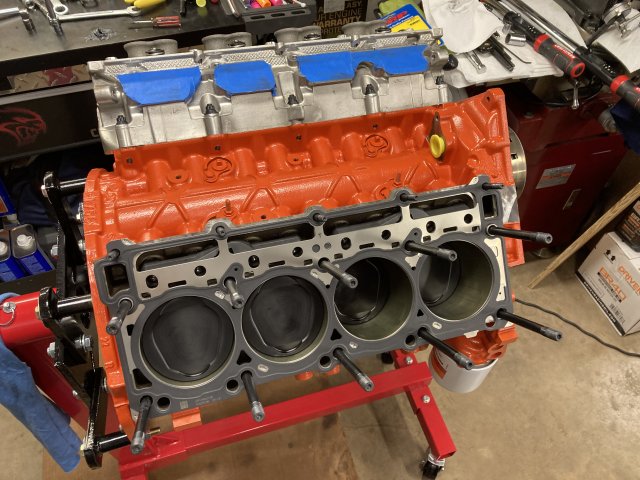

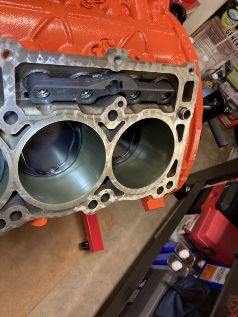

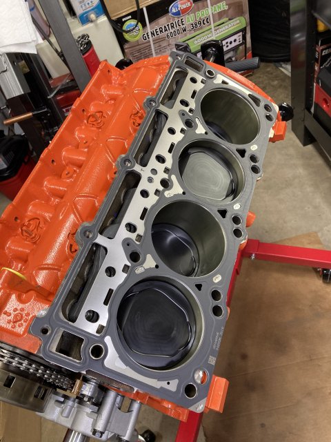

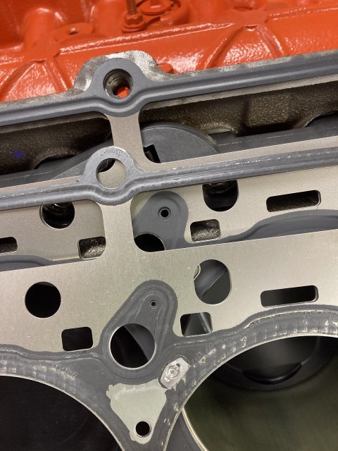

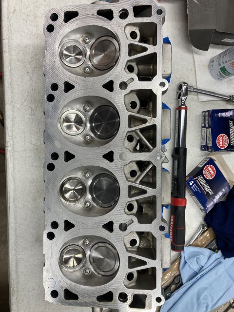

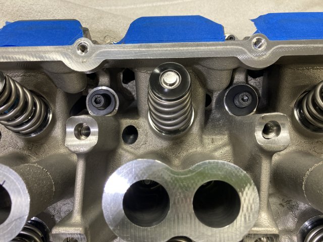

Ok, back on track here. So after being happy the cam is installed correctly time to make it into a long block and cover up them pistons!! After another application of Total Seal Quick Seat dry lubricant to the cylinder walls set #1 down a bit to get all pistons away from the heads for when rocker shafts and stuff are put on time for head one more thorough cleaning and time for head gaskets!! Take note to original 15-17 head gasket verse newest revision head gasket oil control orfice has been increased in size from .062” to double that size 118”, times 4!!! Wow that’s going to be a bunch more oil going up top to lubricate and more so cool the valve train especially the springs. Also notice the spark plugs are installed and indexed toward the intake valve and center of cylinder. This helps to cool the electrode and also keep it cleaner verses it being shrouded by the ground strap and in the shade per say of the cool clean intake charge. This helps flame propagation and travel and also detonation resistance by cooling the ground strap and electrode tip. I also installed the plugs with no never seize, NGK recommending against its use that it’s application can alter a plugs heat range characteristics and cause detonation as well. The silver color coating on them is supposed to be a anti seize of some sort built onto the plug. C86C13C3-066B-4905-A4DA-EC01009B74BA.jpeg 6930E681-6D27-4930-9640-CD6DB9646523.jpeg 5A3B2327-0961-4865-A19B-45BC93C015AF.jpeg D1CA8820-07B7-4B70-B22E-BDAB6977C3E2.jpeg

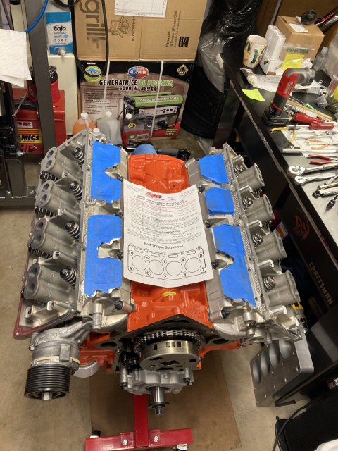

Bye bye pistons, hope it’s a very very very long time before I see you guys again, never will be fine by me!!

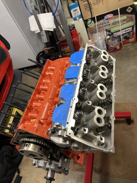

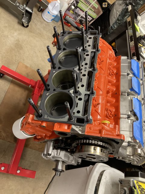

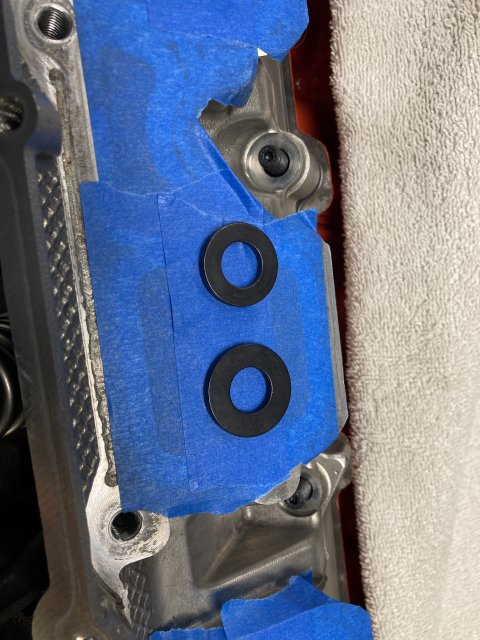

Word to note when using the ARP head stud kit. The washers in the kit are too small for the head, the ARP bolt kit comes with the right washers but the stud kit doesn’t, weird. I brought it too ARP’s attention when ordering the correct washers so hopefully they change the kits to the larger OD washers in the future. Tq’d in 4 steps 25, 50, 75, 112 ft lbs, 7 more then recommended as I’m not going back in to retorque after a heat cycle.

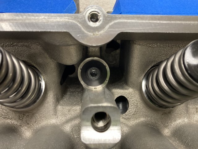

Next up valve train!!! And test timing one more time before putting front cover on and balancer. Hopefully get to tackle that today !! 🤞 F753BBCC-9BBD-4B4E-B46F-F9BBE66FEFF3.jpeg 3E4EDB04-A4DA-4EBB-B324-AFA8CF5489D9.jpeg 8EA06CC8-06C5-48FC-A2F9-EA65922DD4E6.jpeg E0A46AF0-354E-4DF1-9B24-6E6C8B884BB4.jpeg 70F05F10-1457-47D3-A09B-5131B7404B6A.jpeg 8EC4A5C1-29A4-40DC-B3B2-FB296D970AEE.jpeg 3819BE51-116B-4AD6-A452-0ED46D3EC2E1.jpeg EEFE319D-26DD-4A0A-B9A4-AA3F4BCA3C5A.jpeg C12969B9-572F-4A6E-8F40-47A16039870F.jpeg 64D7582D-9763-49BC-B706-6F6C57002604.jpeg
