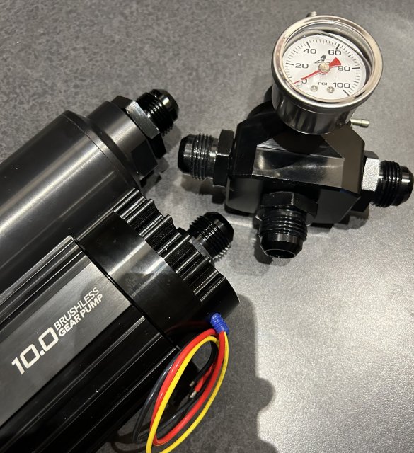

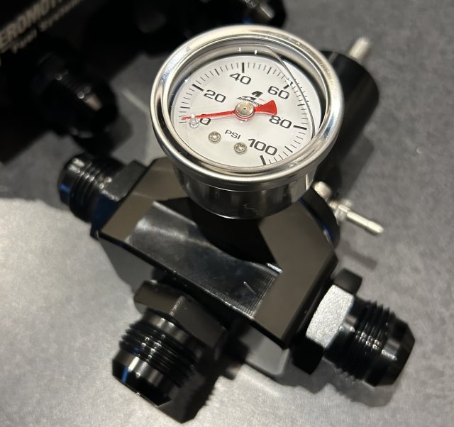

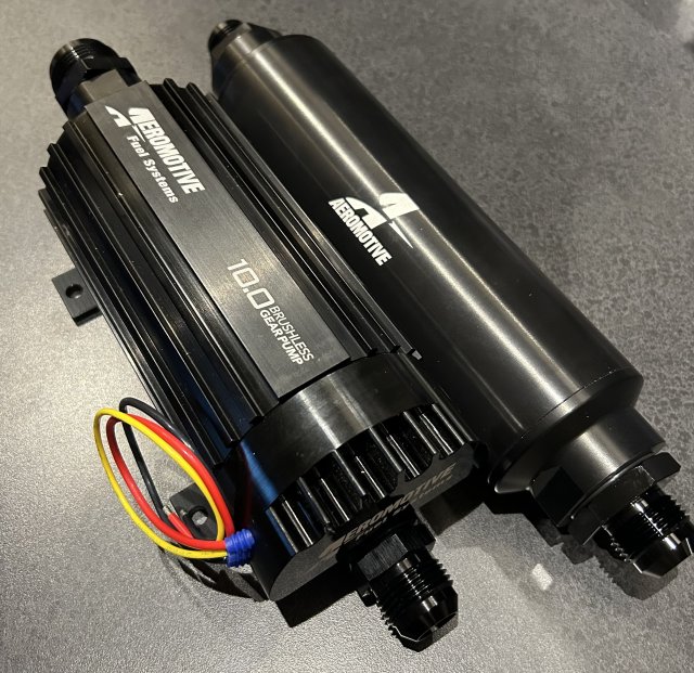

As the tubular structure to support the rear suspension starts to be fabricated, mounting for the fuel cell and system needs to be designed in. That includes the pump. It needs a solid platform and proper placement because it’s gravity fed. There also needs to be a filter to protect the injectors. While I will still be running ethanol for the near future, this system needs to be properly sized for the move to methanol in the future. That will require twice the volume. So…. This setup is being built beyond what is currently needed. Thats so I’m not looking at replacing everything and starting over when the time comes. I made the decision to stay with Aeromotive. Their TVS (true variable speed) pumps are a wonder. The biggest 12v brushless gear drive unit is 10.0 gpm. That will support 3400 hp on ethanol in a forced induction engine. This is basically the same as the 7.0 gpm system I’ve been using except bigger. Not just the pump. Everything. I sold that complete 7.0 system to someone here. You might be able to guess who 😆. This one will have -16 feed from the tank to the pump. From there forward and back is all -12. The fuel rails on that manifold from LME are -12. The Aeromotive tech people are so knowledgeable that there isn’t any question about whether what you’re getting will do the job. When the time comes…. a second 10.0 pump, run in series will provide the volume required to work with the rest of this system. I’ve had discussions about the need to go with a mechanical system for methanol. No room for a front tank and belt driven pump so a hex drive cable was the option. Those have recently been shown to have issues of their own so that became questionable. After talking with Aeromotive (they also make mechanical pumps), they convinced me that for my car, the dual electric pump option was the way to go. IMG_6513.jpeg IMG_6510.jpeg IMG_6511.jpeg

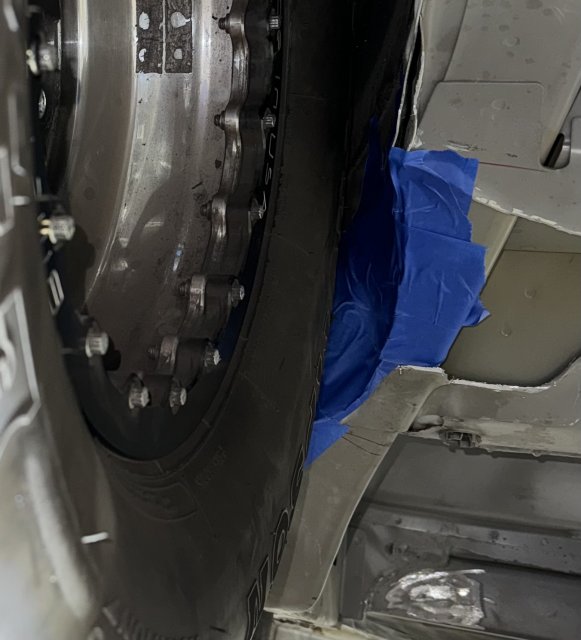

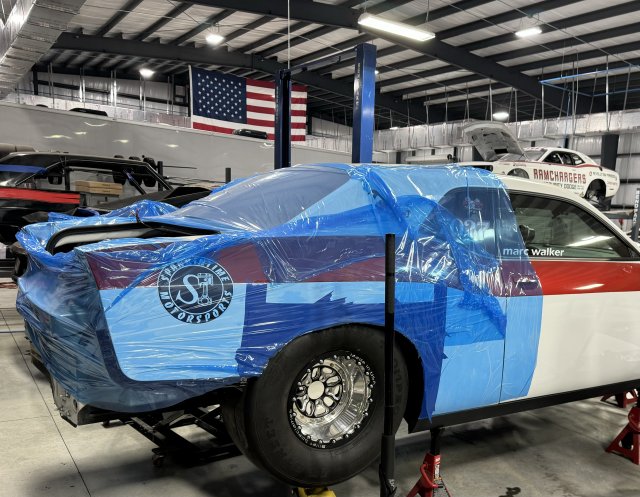

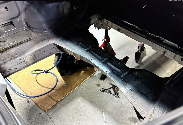

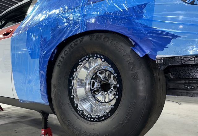

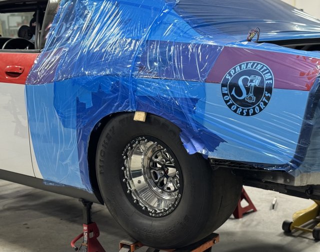

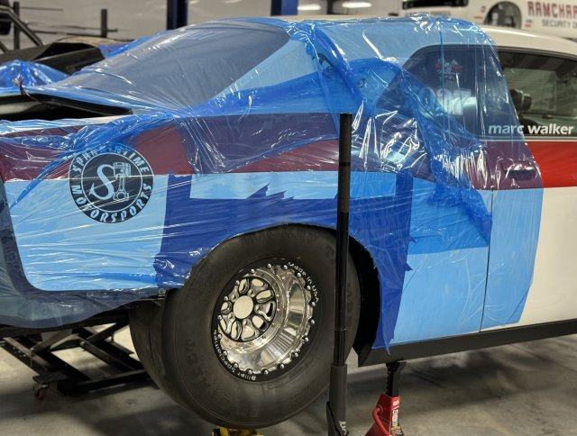

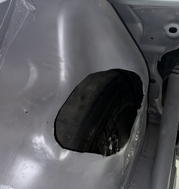

Got the rears placed where they want them to set the width of the axle housing. To do this with the 315’s, a serious notching of the frame and wheel well modifications are necessary. But… no tubs. I’ve always hated the La Bomba wheels sticking out look. Clean, low and tight 👊 IMG_0585.jpeg IMG_0582.jpeg IMG_0586.jpeg

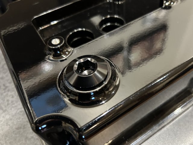

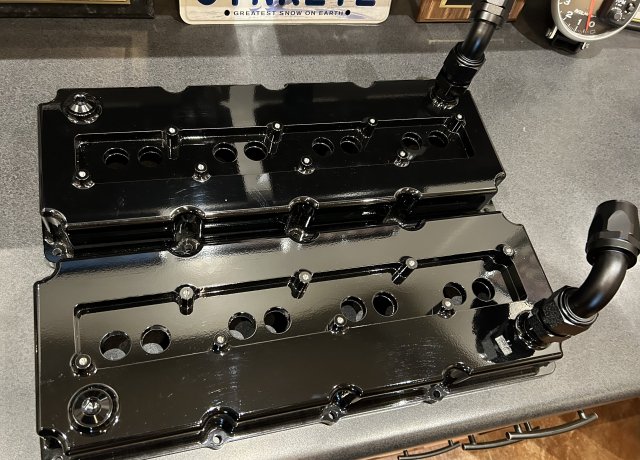

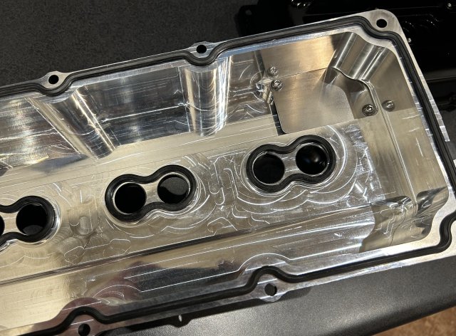

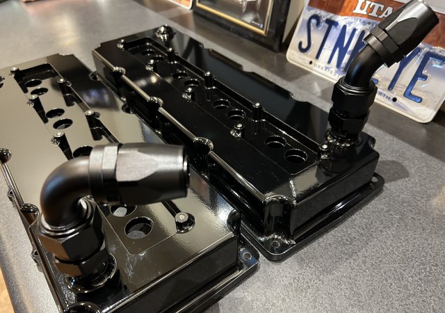

Getting these things ready for the new motor. Cornerstone Billet. I know there were some issues to start with rocker hold down bolts not having room. We will address that. Full machine shop capability at Spankintime now so no problems with stuff like that. I did talk to him about it and they are addressing the issue in their CNC. Spankintime is a dealer now so….. 🤗. Price was right for me. Got the special shiny black powder coat so I think they’ll look good with my red MSD coil packs. IMG_6525.jpeg IMG_6527.jpeg IMG_6526.jpeg IMG_6528.jpeg

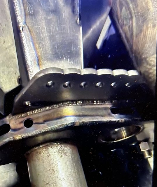

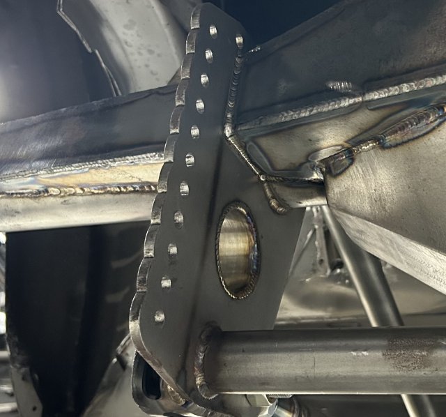

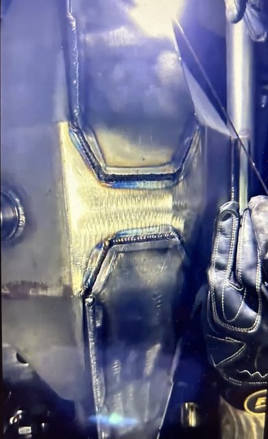

Back on track after a two month hold. A seriously broken arm brought the fabricating talent at Redeye Racecars to a screeching halt. The tig fired up again this week and we’re moving forward again 🤗. More to come IMG_6806.jpeg IMG_6809.jpeg IMG_6804.jpeg IMG_6811.jpeg

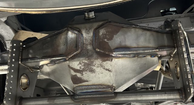

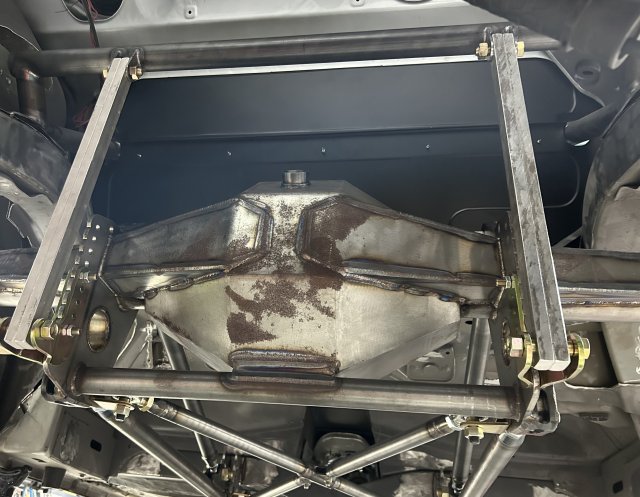

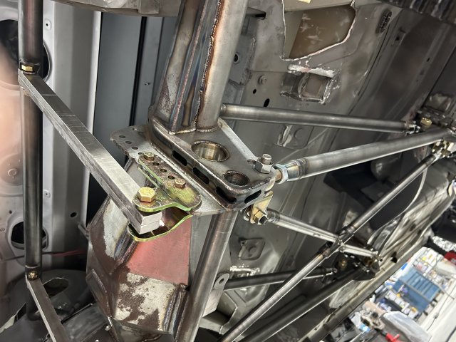

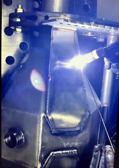

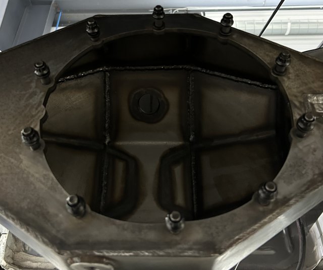

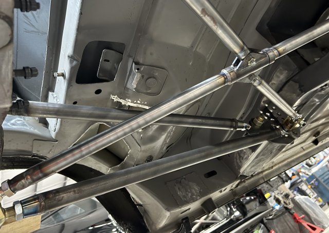

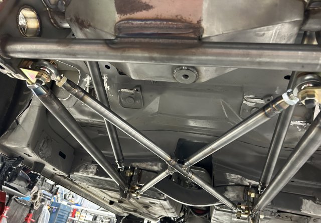

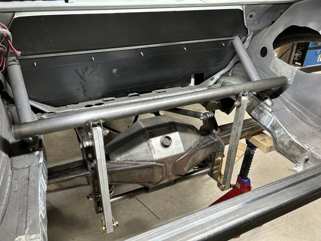

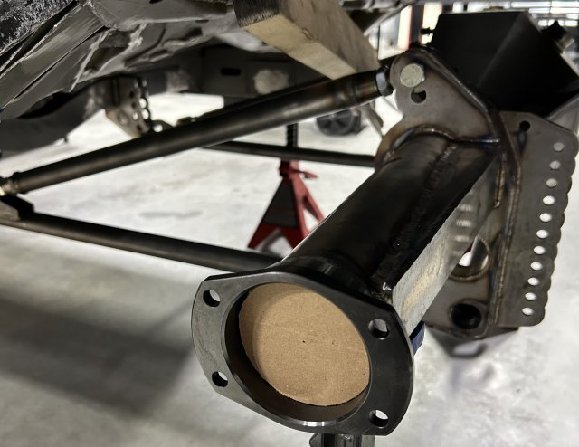

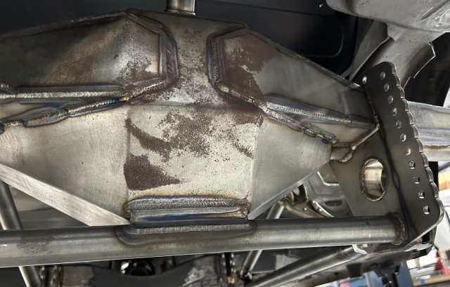

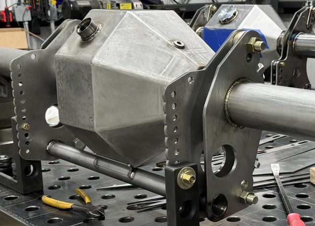

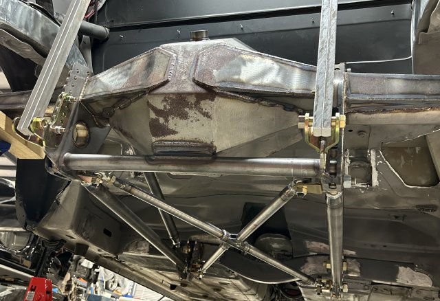

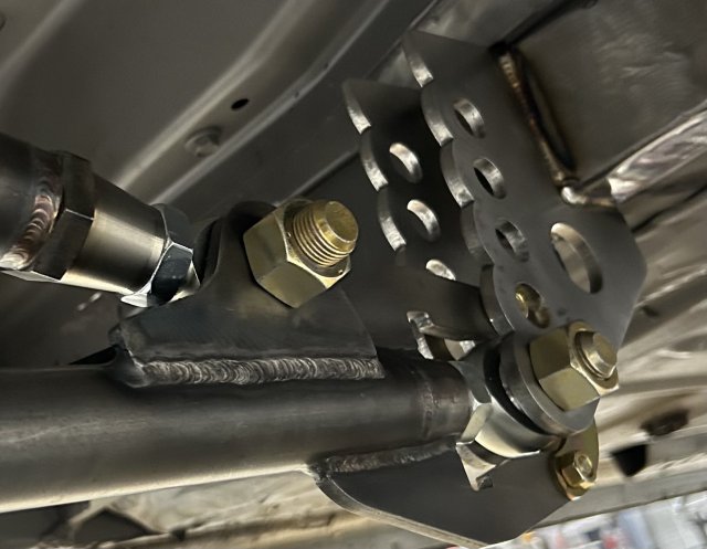

Took a little trip out to sunny Florida to marvel at the stuff going on at Redeye Racecars. Damn! Took some snapshots of the fabricated rear end that is sitting up under mine now. It’s getting there 😎 IMG_6925.jpeg IMG_6924.jpeg IMG_6923.jpeg IMG_6922.jpeg IMG_6919.jpeg IMG_6920.jpeg IMG_6921.jpeg IMG_6916.jpeg IMG_6915.jpeg IMG_6927.jpeg

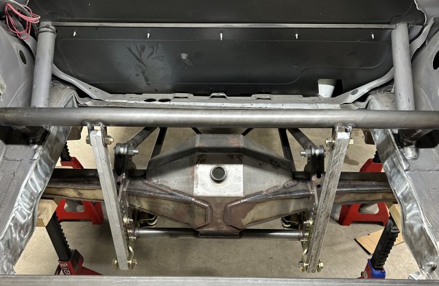

Thread Starter #1,560

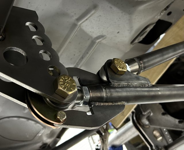

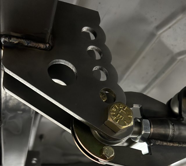

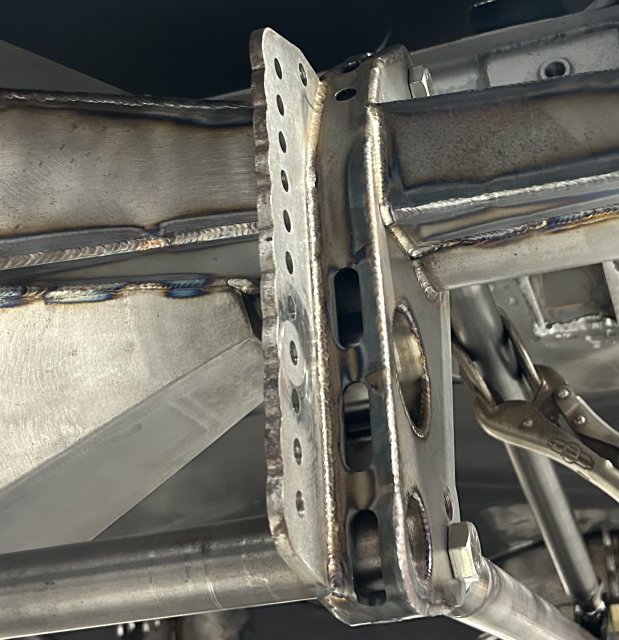

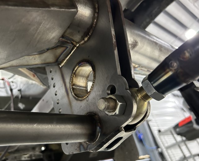

Location and ride hight is set. The hard part is done and it’s ready for shocks and axles. Still need the tubing to place the fuel cell, battery and catch can but that’s the easy part compared to what has been done to this point. IMG_7119.jpeg IMG_7112.jpeg IMG_7106.jpeg IMG_7105.jpeg IMG_7114.jpeg IMG_7116.jpeg IMG_7103.jpeg
