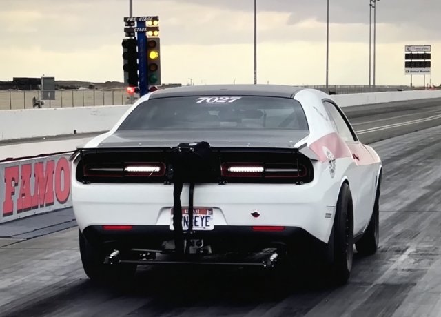

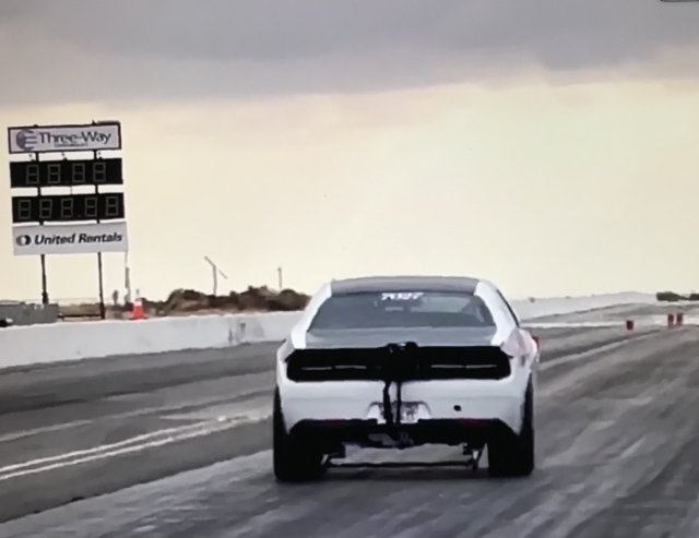

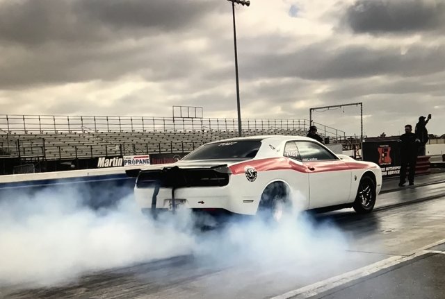

Can’t post vids so a couple sequence shots. THIS is fun 🤩 B3A46BB0-8373-45A9-8BB3-F2C3CC7CE8C5.jpeg CD18AEE4-0F84-4B06-A1BC-E9FB0F69DABD.jpeg 66FAAA2B-469B-4ADF-B837-3D653BB98B97.jpeg CA1E3C23-63B2-404C-B90A-6937FD00C9AD.jpeg B800D8FC-DEE4-4BDA-89BE-2182CCE0B5A3.jpeg E02DC1F5-7EBC-42D8-9165-8356E80CC8CE.jpeg FFE6A4F6-9AAF-49D0-B0CE-42DDDED09546.jpeg

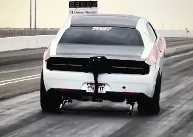

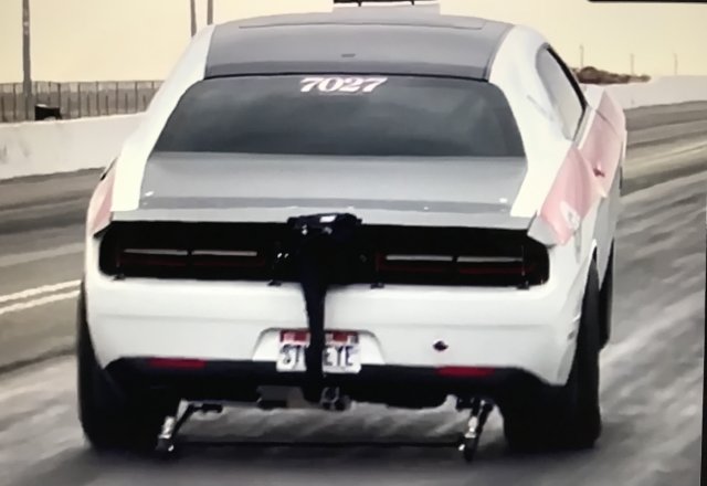

Internet trolls suck 😒. “Why do you need the sissy sticks? “Coyotes run sevens without them”. I pretty much hate FB so I just don’t respond. Ever seen one of the Utube videos where the big wheelie goes bad and crashes the car? There’s plenty of them. Guess how much money that costs 😒. Ever see what happens to the front suspension, oil pan and headers when you pull out of the gas when it’s on the rear bumper? Guess how much money that costs 😒. Getting the no bar traction control tuning and chassis settings dialed in is a trial and error process. In the mean time those bars are insurance. Sometimes they’re a hindrance. If you hit them too hard, they will unload the tire. If you hit them just right, it’s a thing of beauty. My best pass this week was one of those. It carried the wheels on the bars just right for about 150 feet with no fear of it going bad. The sixty was a 1.25 with the rear wheels. I’m going to guess that means the fronts went over the light at about 1.19. Trolls can suck it. 🧌 675F3240-7062-4542-ACAC-2A9209893E57.jpeg

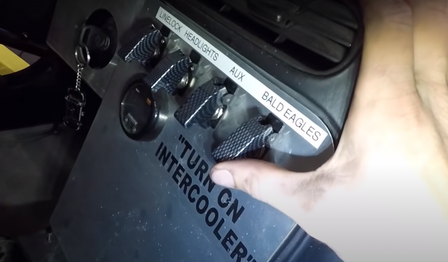

I’m sure it was on a 8.1 pass but I screwed it up. When I was pulling into the burnout, a car on track in front of me had a problem down track and they shut me down to wait. When I was cleared to restart, I hit the ignition on switch and forgot to turn on the icebox pump. The sixty foot was a 1.25 with the rear tires and I was on my way with a big grin going. Then I could actually feel the timing being pulled at mid track. After the chute was out and I was under control I looked up to see the intercooler pump was not on and was saying F, F, F at the turn off 😑. The 8.24 I ran on that pass was down 3 mph from what it otherwise would have been. Oh well. Dumb ass driver is always a factor 🤡
4,087
10,234
might need one of these signs (cleetus old school video)

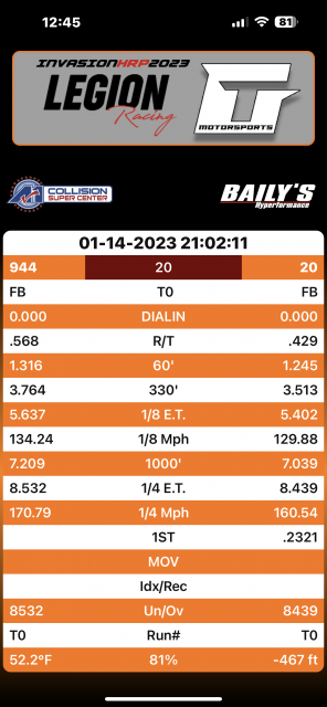

This was mine on the back tire pas the 150 foot 3.0 whipple. I was told the 60 don’t change really IMG_7818.png

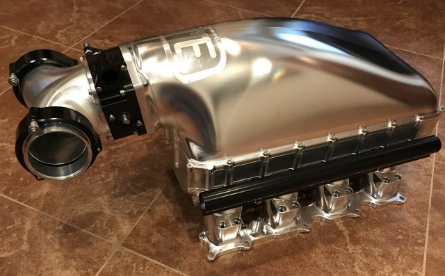

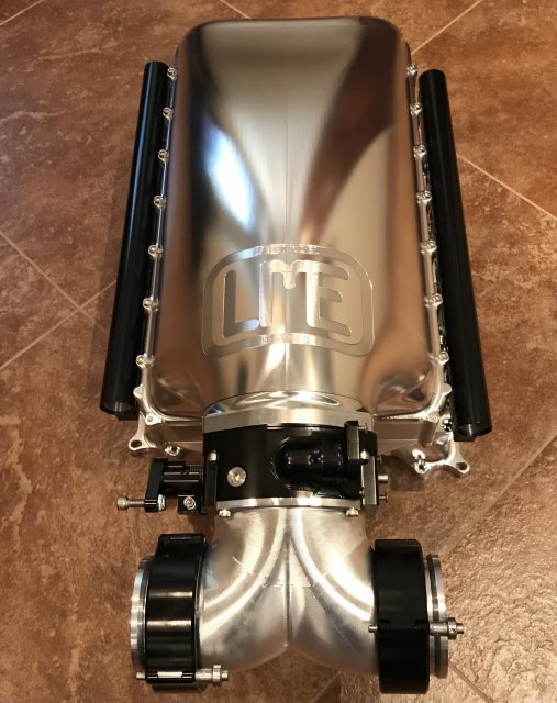

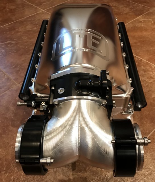

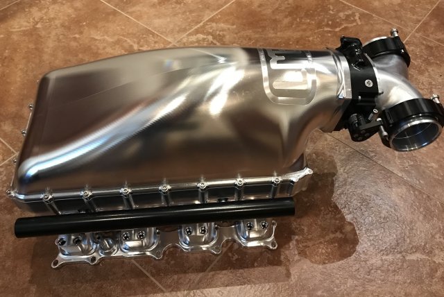

I showed some pictures previously of my LME ((Late Model Engines) intercooled intake for the turbos. . One thing I had to have redone was the throttle body attachment. They pushed a wrong button in the CNC program and I ended up getting it setup for a Nick Williams 108. Not what I’m using so back to the machine shop for a do over. Just got it back and…. Nice! That will work 👍🏼

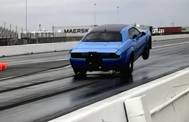

Sorry to hear that about your block, glad they got you fixed up. Where are the wheelie bars connected to on the blue car if it’s a stock frame car? Does that mean independent rear suspension?
