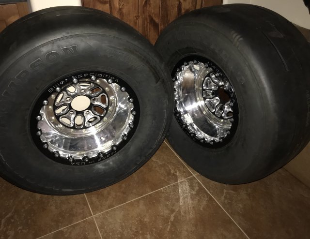

Fresh set of mounts ready for In-N-Out Fest. Mounted them up in my office yesterday and torqued the beadlocks this morning. These things are like a big Double Double. 🤤 635FF236-3C38-453B-A35B-9933BED54010.jpeg

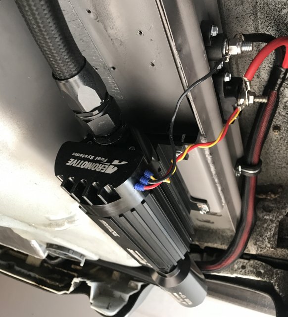

So…. Fuel systems 😵‍💫. Going to the turbos has required several new learning requirements. At this point we’re staying with the ethanol (Ignite E90). The 2200cc injector I’m running now will not be enough for 2000hp. I’ve been told (unofficially) that neither will the 2600’s that are available now. The goal with a twin turbo at this level is to move to Methanol. A bunch of reasons to do that. So we need to be looking at a number of ways to do this. It’s one of the reasons I went with the new LME intake. It’s rated for 2400hp with the water intercooler. It has a dual injector option that will allow for Methanol with dual 2200cc injectors. I’m already using those now so I just have to add the second set. That will be a huge cost savings over what I would be looking at with a single set of atomizers. I’m currently using a external Aeromotive 7gpm gear drive pump that is gravity fed from a rear sump. Adding another one of those would provide the volume necessary for the switch to Methanol. I will have to make some changes to my fuel lines to work with that but once again, a big cost savings over the alternative. 8636CE8E-F8B9-438B-9775-F3107C0B8D16.jpeg

That’s one of the reasons to go to Methanol. It is more tolerant in rich/lean conditions as far as something that can hurt the engine. It runs so cold that detonation at the paltry power level I’ll be making isn’t going to happen. We’re not talking anything even close to those 4000hp levels. In conversations with others running a similar setup (turbos) they’ve seen issues with EGT’s beyond a certain power level with ethanol that is requiring they move to the Methanol.
Basically going to dual anything doubles the chance of a failure. Fuel pumps or injectors. The dual pump idea is just that. We’ll have further discussions on whether that’s a good idea or not. A belt driven pump is another option. Problem is I still have the accessory drive for the alternator. I’ve decided I don’t want to go to a 16 volt system. There’s all kinds of ways to skin the cat so I’ll probably end up with something I don’t even know about yet.

That’s what I have. The Aeromotive 7.0. It is rated for up to 2400hp on ethanol but only 1200 on Methanol. That goes to show the volume necessary for Methanol. They have a 10.0 but a single one of those still isn’t big enough. That why I’m thinking two together might be a way to go but I agree that a failure of one might be catastrophic.

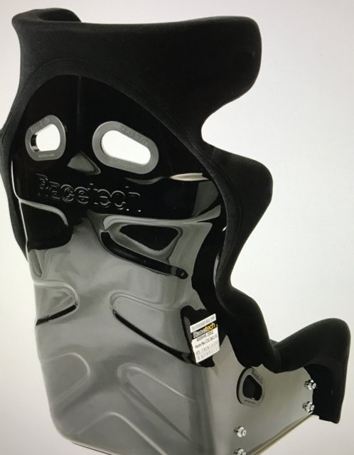

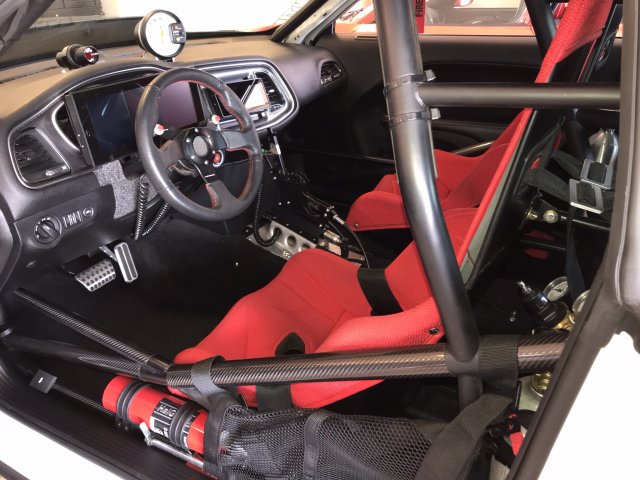

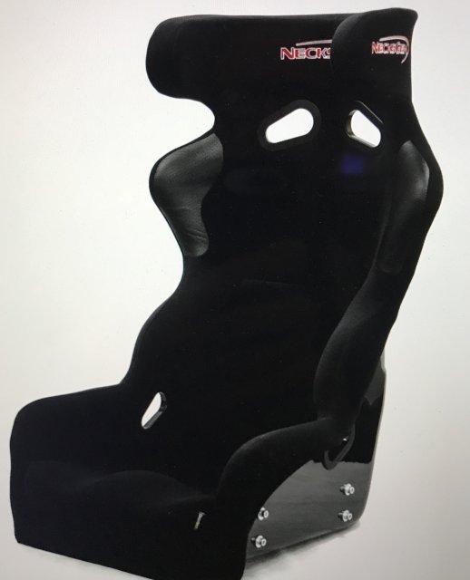

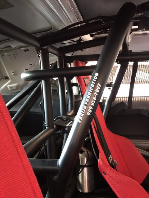

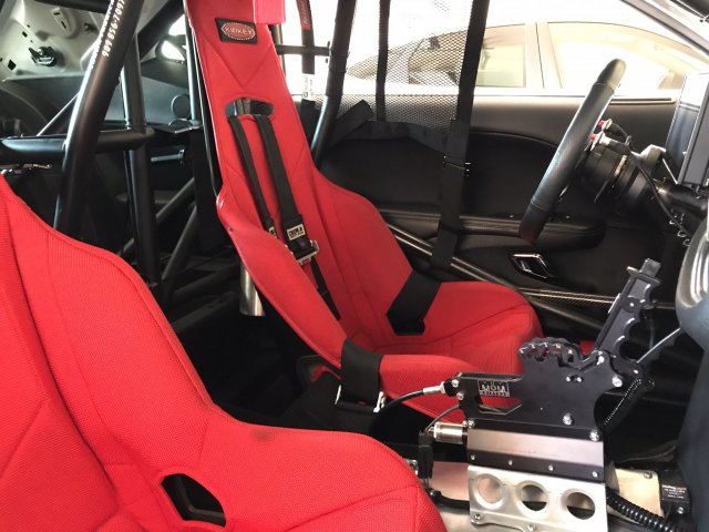

The money vacuum continues 😳. With speed comes risk and as much as I love my bright red Kirkey’s….. they gotta go. Once the 7.5 cert cage got the hoop, it added another concern. In order to leave room to get out of the car, the bar is right beside my head. It’s padded and I’ve got the best helmet money can buy but…. It’s a bar. I just purchased a new seat that will address that. If anybody is interested…. The Kirkey’s will be for sale in the future. 8F16A749-C7D6-400C-8FF0-03850D96ECE1.jpeg E72829B8-0211-49C5-AAB9-0B221CDB30F0.jpeg 7D8A4352-8F3B-4D25-A788-7107874395C2.jpeg E9BC8A5B-01A7-4843-BA53-726AED979D6F.jpeg 0E764C37-8474-49A2-BE30-8E849799FAB5.jpeg

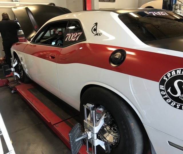

Car’s loaded and ready for In-N-Out Fest next weekend. One stop at the tire shop to balance the new Radial Pros and dial in the front alignment. Stinky is ready to kick some west coast ass. And enjoy a tasty Double Double after 🤤 3A54AC38-1B13-433A-9223-A27340E1CDF4.jpeg

At this point I’m making decisions based on the worst that could happen from a safety standpoint. If things go bad…. you’re going to want a bolstered seat that is as tight a fit as possible. Solidly mounted to the floor and roll cage in the back. No adjustability. Tight harnesses and neck protection in the form of a helmet tether device. The helmet should be as light as you can afford. I would suggest that you find access to the seat you’re considering and get into it to check fit. You’re not looking for long trip comfort that you can move around in. It’s a race car. I just purchased a drivers seat for side to side head protection from the roll cage that the Kirkey doesn’t provide. That’s the only reason I’m doing that. I found a close out deal on a Racetech manufactured seat that was last years model. The FIA certs are expiring so they are being rebranded as NecksGen and being sold at half price by them. They are a company that makes neck protection devices (nice ones). These seats are still being sold elsewhere for $1600+. I paid $900.
