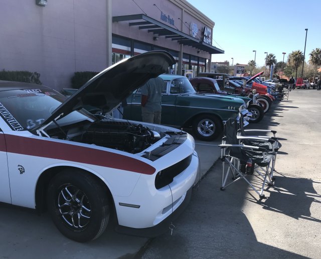

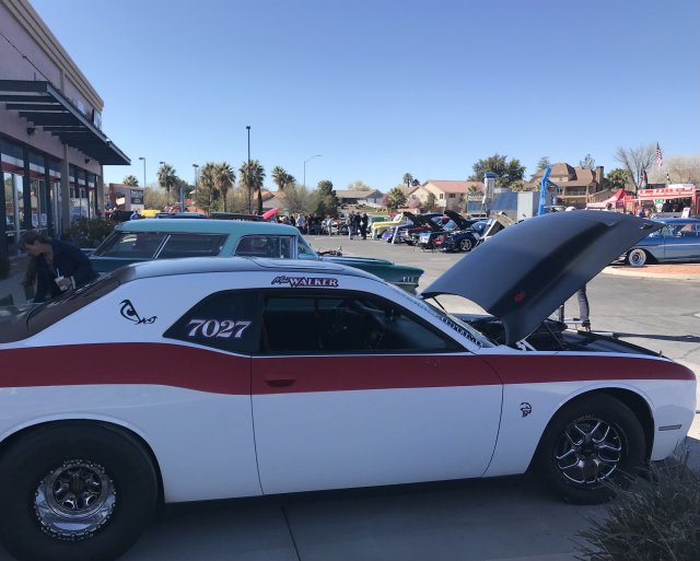

On the topic of not doing anything car related (fun), mine has been sitting in the trailer just as it left the track in Vegas. I was able to get it home today and decided to drive to the once a month car show. Big turnout! The children cried in fear, the men were humbled, and the women were… 😏 60BE31BC-A283-4016-83EE-34AAED10A982.jpeg EAE668E6-4B91-44C4-9FF8-6509B9E50B92.jpeg

On the topic of not doing anything car related (fun), mine has been sitting in the trailer just as it left the track in Vegas. I was able to get it home today and decided to drive to the once a month car show. Big turnout! The children cried in fear, the men were humbled, and the women were… 😏 View attachment 102285 View attachment 102286
Love the backwards Starsky and Hutch retro look its dope! Dam that drag pack sits up really high huh? Im guessing many here have no clue who Starsky and Hutch were but whatever......lol

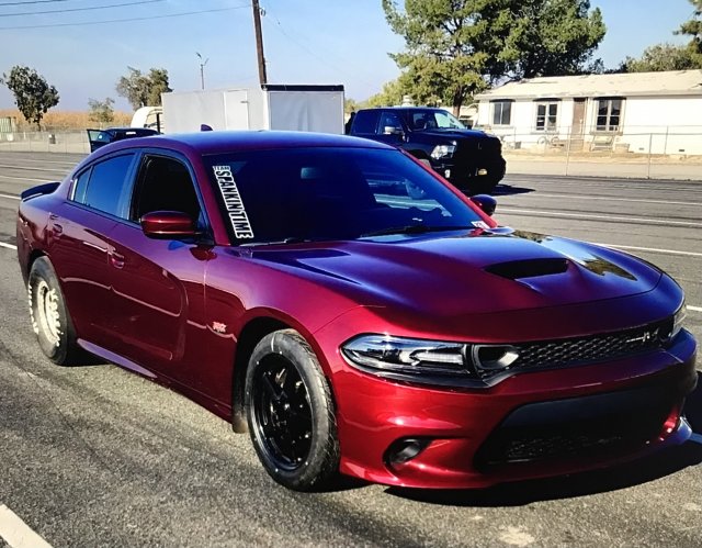

Shops daily driver ScatPak. Full weight SpankinTime built 392 with a 3.0 Whipple driven with the 6-rib serpentine belt. 9.31 at 150 mph. 😳 View attachment 94606
I may have missed them, but do you have details on this?
It’s still a 392 but built by Adam at Spankintime. E85, Forged Internals with Redeye heads and cam. 3.0 Whipple driven with the 6 rib serpentine belt. Hp90 trans, 3.09 gears, AAD, G-force axles with 15” conversion. Plans are to go to 8 rib pulleys to be able to increase boost. Belt slip is limiting now. C9A179AE-71FA-470D-9091-991BEB1133F9.jpeg

2,228
3,826
It’s still a 392 but built by Adam at Spankintime. E85, Forged Internals with Redeye heads and cam. 3.0 Whipple driven with the 6 rib serpentine belt. Hp90 trans, 3.09 gears, AAD, G-force axles with 15” conversion. Plans are to go to 8 rib pulleys to be able to increase boost. Belt slip is limiting now. View attachment 103258
Thanks
I'm digging the Super Bee WB that should be coming out at some point.
But I wanted to know what a Scat can do.
Low 9 daily works for me.

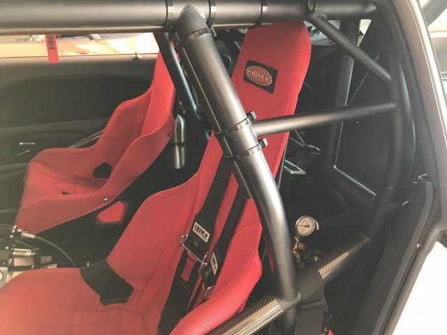

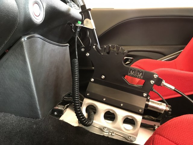

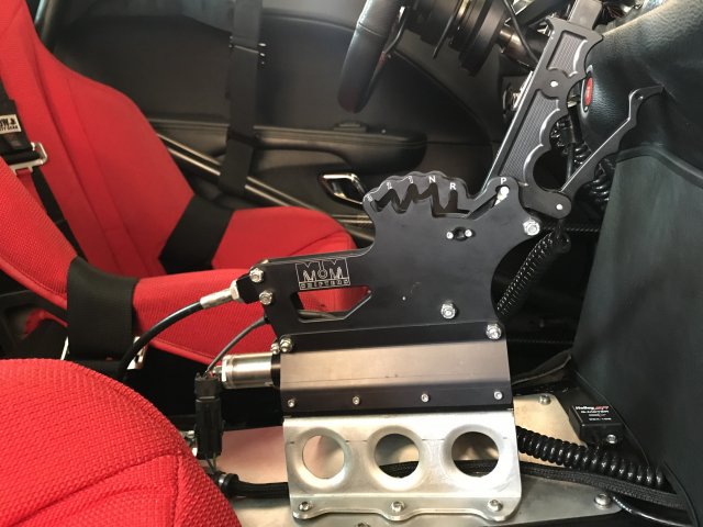

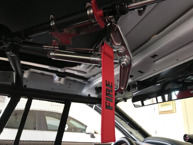

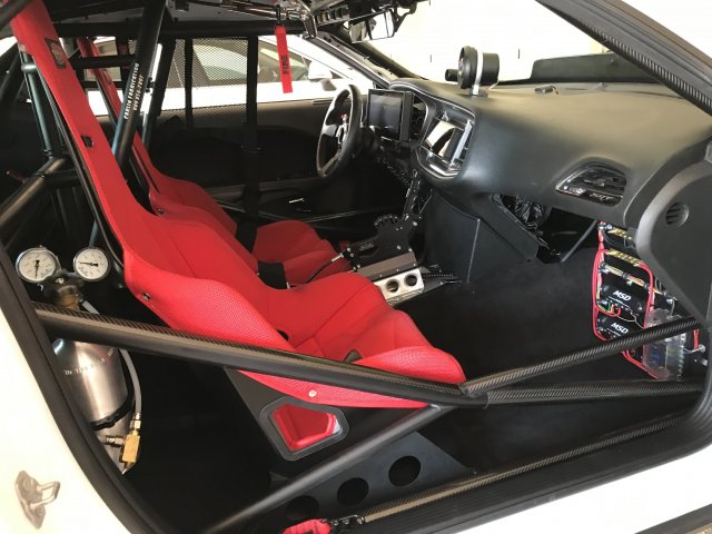

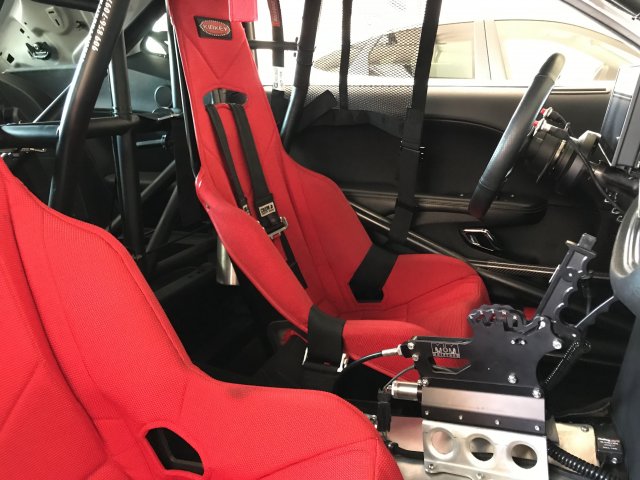

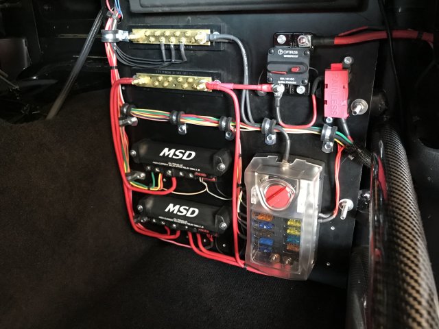

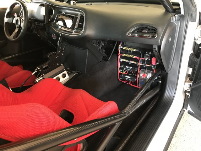

Interior has needed finishing for some time now with all the attention going elsewhere. I think I’m done ✅ DB901DF2-0EB4-4561-B278-E86EEBB5CF16.jpeg A9D02CC4-5A64-4ACC-993D-15C8E512A4DA.jpeg 05E76960-1DB9-4A07-9E32-6727FBADC327.jpeg 466F35BD-7F0C-47CD-9134-89E2491D8E04.jpeg 394EB42E-26BD-4D23-99C4-822E5FBBDD55.jpeg D3152477-64AE-437E-A964-AEAF6B179F8E.jpeg E132C8F2-73A3-47A8-B2F8-D288535B8177.jpeg FF59C3AD-5FF3-484A-8934-199C92F6096E.jpeg 75AE9A55-42D8-442B-A605-111EE9B4BE70.jpeg 2720422E-66EB-42BE-A295-99F8FA97A0AC.jpeg 0F680F6A-6FC1-400F-B62F-72AE2634A800.jpeg
1,539
3,854
bad-ass and neatly done
TNREDEYE
#1211
1,000
2,520
Shelbyville
2021 Super Stock
Looks really nice.

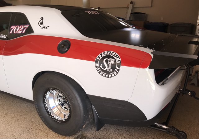

Thread Starter #1,320
