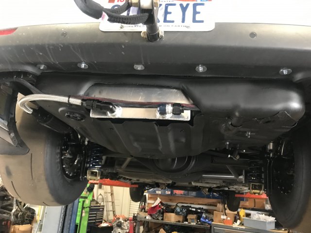

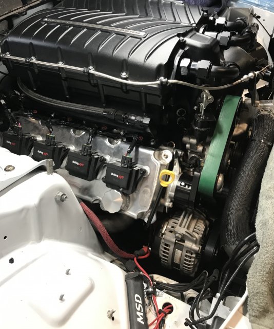

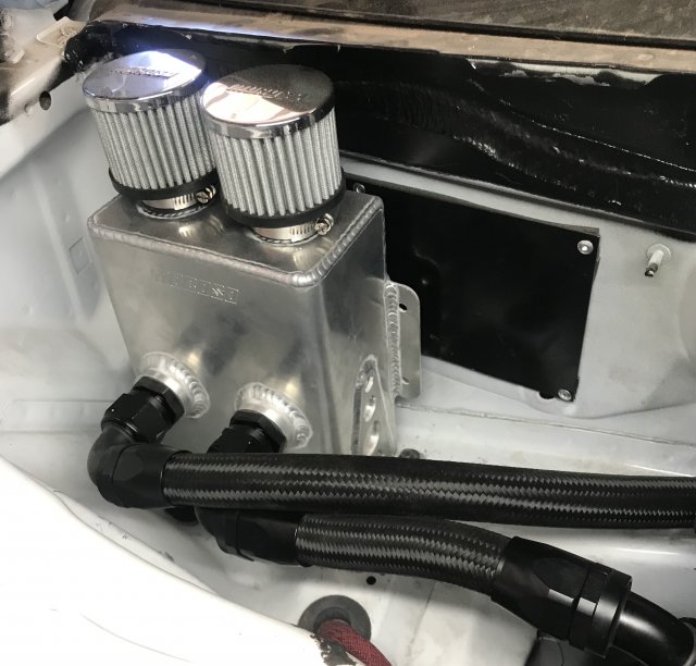

Lol. There is just so much work 😵‍💫. Believe me…. I spend a portion of every day asking myself why I ever thought this was a good idea. I made the decision to do everything as nice as I can, so when it is finished, it will be a quality piece. I’ve also been spending time at the rear redoing the fuel tank setup. Modified the facia and will be adding a custom aluminum cover that will dress this up and improve aero at the rear. 9E79477A-B080-42BF-B1CD-B1EE04D9013D.jpeg

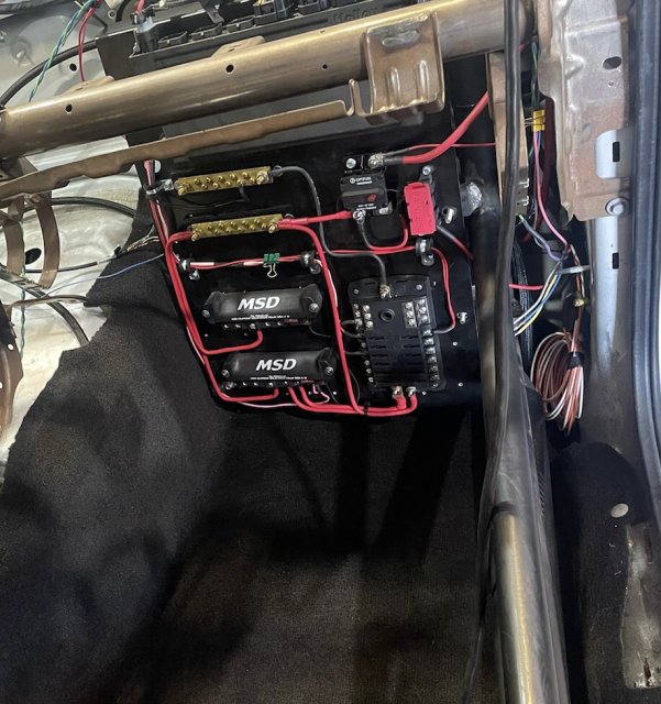

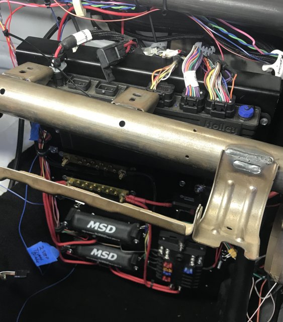

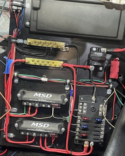

Just one picture but it’s a BIG one. The electrical panel is done. Harnesses are all connected and just some switches and lighting left to connect. Start up is getting close 🙂 816414F8-03D7-4FE3-9E9F-164C5E13A9C2.jpeg

Looks good! What’s with the green paper clip thing?
3,628
11,704
Thread Starter #1,125
That’s used to hold the wires together while they’re being strung out one at a time. Once it’s all finished and tested then those are removed and it’s all permanently secured. There’s a yellow one in the upper right. Good eye 🧐

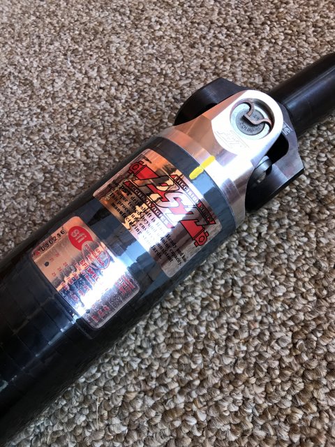

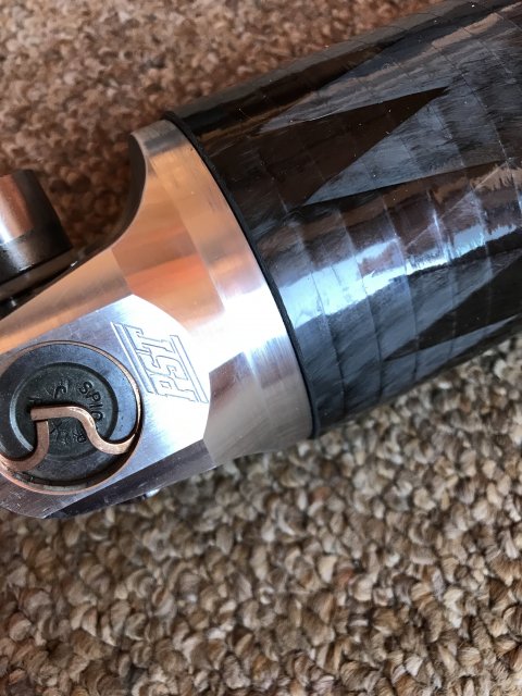

Ok! Not to get back on subject or anything…. I know that everybody likes to hear about who’s drive shaft isn’t worth a shit compared to _______ 🤨. Just arrived today!! This will put my aluminum Raven Engineering DragPak shaft into the backup position. New PST 3.75” Carbon Fiber “Drag” Shaft. Rated to 3000hp. If it breaks…. They send me a new one 🙂 378AF44E-3682-4331-9869-B1181715318E.jpeg 927CB033-C5CB-4450-B964-EEDD5271B1C2.jpeg

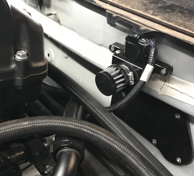

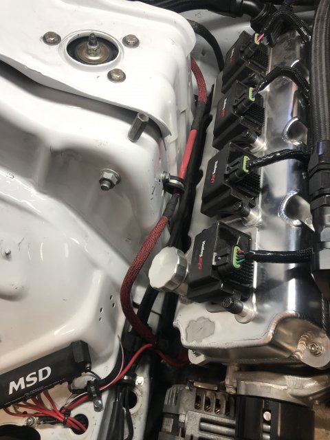

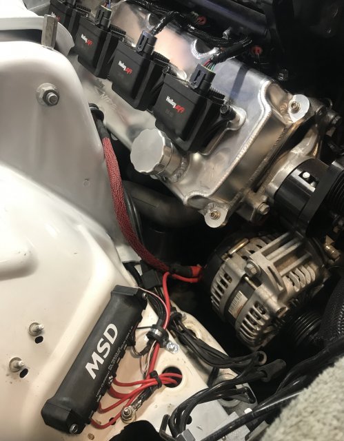

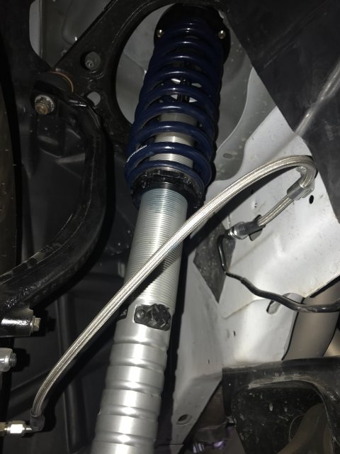

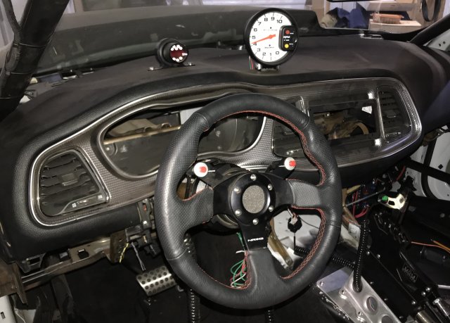

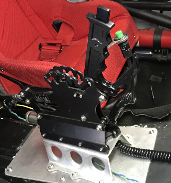

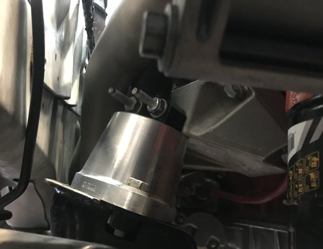

Just about ready to fire. Wiring is 99% done. Shifter is working. Billet motor mounts are in. Belts and pulleys are set. Changed the front coil overs. Just need to install the dash and set up the digital displays. 31C9507E-7CC3-4C2B-B4F2-8A8765D833E6.jpeg A1EB0077-94C6-41B8-99E1-7EF821560DEF.jpeg 27E298DB-8FC5-4A9F-8ECD-D88BD116962C.jpeg 42D10E33-78D9-4959-9DFD-EDABF5A7CC5B.jpeg B877CFC3-3221-4ACD-8AAB-FC0D2E3DD3B4.jpeg 48FDD648-A8DB-4685-B96F-393C16AFC74D.jpeg F7735770-EDA7-4A95-B89E-7214CE9667D7.jpeg D0BB3163-D98B-4D3C-9CE5-55C7612CEF1F.jpeg 7222D20D-3911-4FD7-B705-A2E88B4C7ABC.jpeg C87A1BC2-3879-456A-9432-215F72682BBB.jpeg

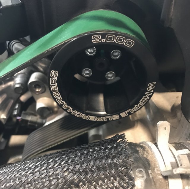

What made you decide on the 3.0 upper? Don't want to risk spinning it to hard? I'm surprised you didnt go 2.85
I had the 2.75 in one hand and the 3.0 in the other 🙂. The blue car ran the 8.0 last year on a 3.0. We decided considering that so much is new, we would sneak up on this rather than go yahoo on the first outing. It’s possible we might be on the track this coming Friday night. Plans are to end up with the 2.75 and we are fabricating a idler pulley bracket that will move that up to increase the belt wrap for that.
