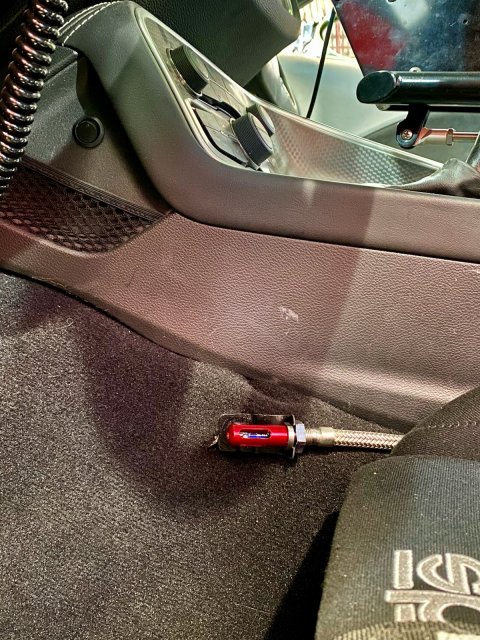

Actually…. It’s automatic. Fire suppression nozzle under the seat goes off if it gets too hot. Looks like this 😁 B24A1006-AFA9-4F9D-9441-91FDB9122EF0.jpeg
Looks a good ol' "Save the Family Jewels" nozzle. :unsure:

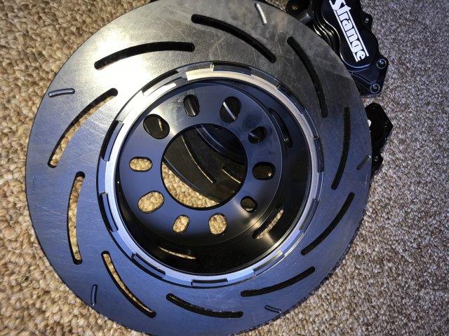

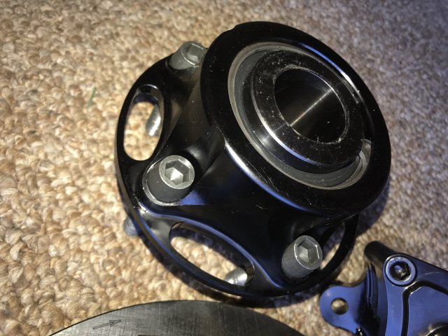

Here’s something 🤓. My new DragPak front brakes. Comes with the billet hub that have low resistance bearings. The calipers are also billet. The rotor and hat are separate and held together with the mother of all snap rings. Total weight with everything put together is 14 lbs per side 👊 BFD34883-74F5-4A82-8D35-49E886C94BD8.jpeg 4078C00B-E4A2-4ECC-B1FB-8FF64A6DEC03.jpeg 7451E856-8D0F-45F0-BBCF-70BEBA2FEAE4.jpeg 5275934B-AC98-4EF5-924E-7E1C1D608CF1.jpeg

The brakes on my bicycle weigh more than that.

I forget what the stock brakes weigh. They’re not off yet to weight them but over 30 a side I think for just the rotors. I’m also ditching the heavy M/T Sportsman’s for light weight Hoosiers and that will be an additional 10 less per tire. I’m thinking maybe 60 lbs of rolling weight total. That should be good 😊

The stock 6 piston brembos ....
Rotors = 34 lbs each
Calipers = 16 lbs ( loaded with pads and hardware )

Here’s something . My new DragPak front brakes. Comes with the billet hub that have low resistance bearings. The calipers are also billet. The rotor and hat are separate and held together with the mother of all snap rings. Total weight with everything put together is 14 lbs per side View attachment 60974 View attachment 60975 View attachment 60976 View attachment 60977
Does this fit on th stock hellcat ( set) knuckle ??

Wow. So a 36 lb savings per side (plus 10 each on the new tires) will be…. 92 lb off the front with a significant percent of that rolling! My day is made!😜

This is why o went with thre demon calipers, race. Brakes rotors , 17X4.5 wheels and Mickey Thompson front runners . I took 106lbs off the front when in race trim

No. The knuckles have to be changed. The original DragPak was based off the 2010 Challenger. That hasn’t changed. I also had to change over to the 2010 lower control arms to fit the Strange coil overs

Good info . Thanks

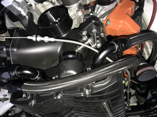

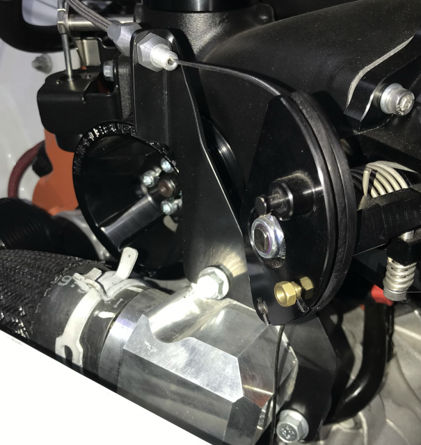

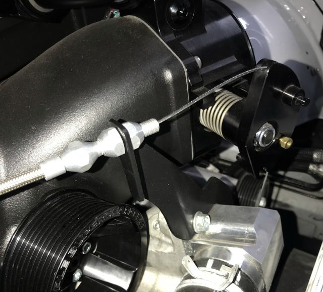

Grabbed a couple pics of some of the custom touches that require fabrication. You can’t buy this stuff off the shelf. It requires time and talent to make. The throttle body with the DragPak Supercharger is manually operated. So… a throttle cable has to be used and that requires a pedal and a bracket at the throttle body that have to be custom mounted for the cable. It would be nice if one could just buy this stuff, but….. 😑. I actually called the people building the Dragpaks to ask about purchasing one of their setups and they politely told me to stuff it.

Gas pedal…. 190B6F7C-FC8D-4CA8-A629-22F720AA508B.jpeg ACFCF13F-82C7-4D6F-9A59-D34A82E3D89D.jpeg 32EE8D4C-6384-4238-BD38-C312978A841D.jpeg B60EA2FC-C6E0-43D8-9B36-6D5B4480B7F0.jpeg

Throttle cable…. tempImagebLMyCx.png tempImagedDXLT3.png tempImageW3XQts.png

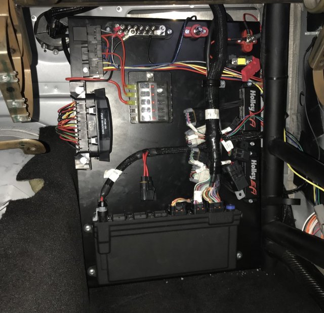

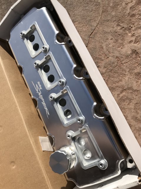

More pics of the electrical layout including the Holley Dominator ECU..... 77649648-15A8-487B-85AB-31EF46A74EA5.jpeg 5ED641E6-A48C-4C92-8FCB-E7C2D7A060E1.jpeg
