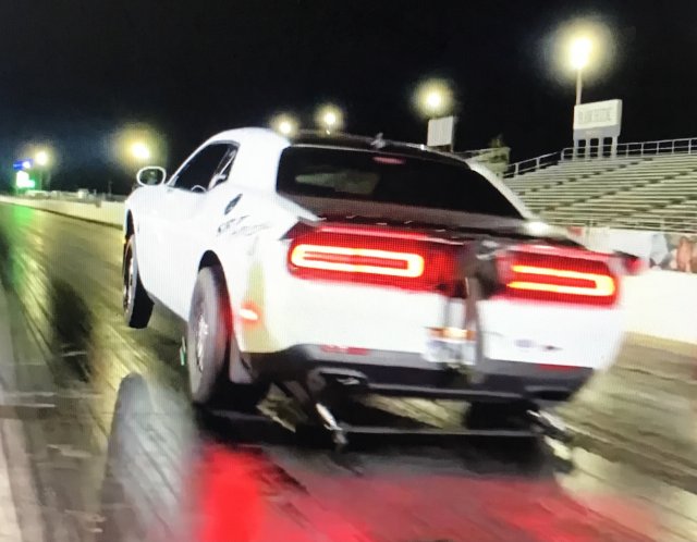

A9655B4F-5A2C-4189-B8E8-294F35ADF01D.jpeg 0685D2DD-9A97-48D4-B276-7CE00F6B8FA1.jpeg

This was the off the trailer leave with the “safe” tune to get data. 12 degrees timing , 17 lbs in the tires, and no ice in the box. Lol. I didn’t even do a burn out. Just going to “drive it” down the track. Left at 1200rpm. The bars are going to be a big part of the tuning on this thing. It would have stood on the bumper if those bars didn’t intervene.
3,530
11,380
Thread Starter #734
Check the lift that 4-link is providing. Look at the space above the rear wheels sitting at the line compared to launch. She comes up a full inch or more. That’s sixty foot right there!

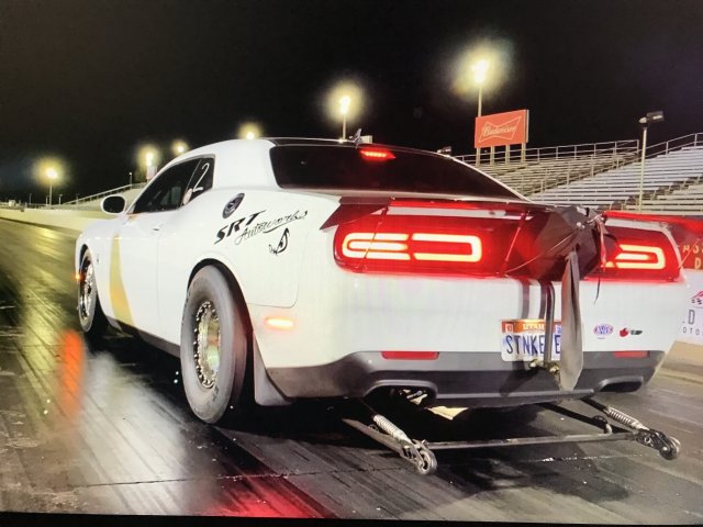

Glamour shot under the lights at the track. ED4F4173-85EB-4063-924D-3649783155BB.jpeg

that is the perfect stance for these cars(y)
It screams, "Don't fuck with me."
