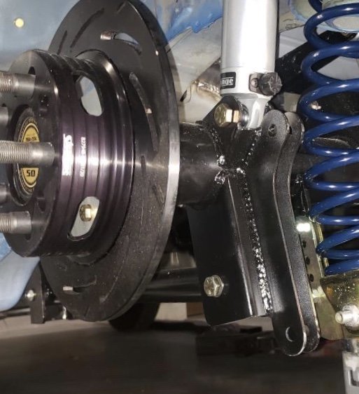

The new stance. 😬 BE8B2F18-49F8-43E3-9561-08802B89632C.jpeg 61F66F88-9DD4-4AC0-A3C5-BA46743C0B80.jpeg

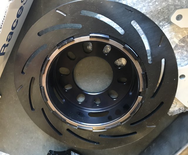

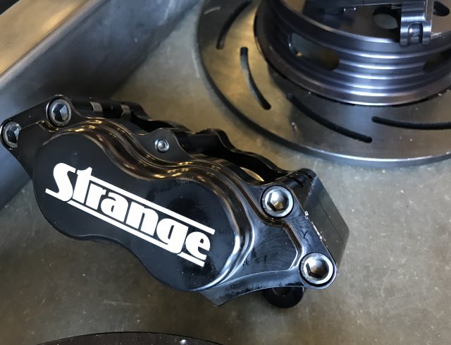

looks good, any plans to replace the heavy frt brakes ?
Yes but I'm not sure what to do yet. There was a company that came on here advertising a ceramic replacement that was going to be super light without reducing braking performance. I haven't heard anything on that for some time so maybe that isn't going to happen. Demon Performance has a lighter rotor package that takes a few lbs off but I don't think that bang for the buck is worth it for nothing more than a 15 lb weight reduction. I see the small drag brakes like from Strange as not good for a car at this weight. At 170 mph I want good stopping power so I don't have to depend on the chute keeping me out of the sand. Having the chute is good. I just donrt want to rely on it as a must use stopping deal.
oilburner
#1135
703
1,793
coboconk
I have rotors coming from racingbrake.com an demon calipers on order. was told somewhere around 35 lbs lighter(total) will see, at least it will be a weight saving on the frt.

How much do you weigh? I don’t think I’ll get below 4200 with me in it and I expect to be at 170+. That’s a lotta weight at that speed!!
3,630
11,711
Thread Starter #648
The light weight race brakes are super light. The Strange set I have on the rear are a two piece rotor design. Very trick! That’s so you can just replace the rotor disc when you wear them out every race. The disc is held in place with a big circlip. They are like ‘use once and replace’. No doubt they work if your car is 3500 lbs and you are willing to replace them on a regular basis just the cost of racing. 3572C801-8279-45FF-B9B6-81AA84658B57.jpeg B3B6EF1B-9EE8-4D4A-AC21-14467C23AECF.jpeg 3033DD49-4192-4B84-B3AB-C8D9A1BEF65E.jpeg

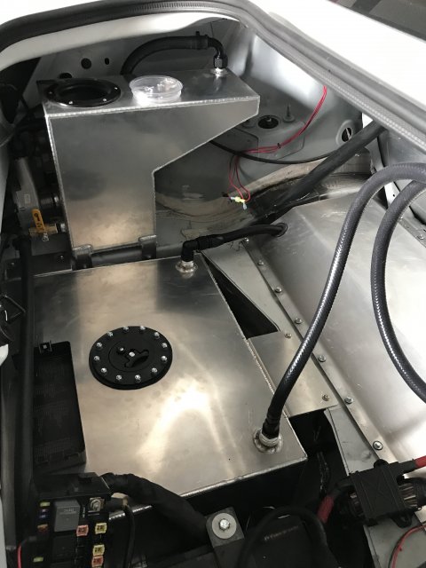

That drag pack is a real trick setup . How many gallons is the fuel cell ?

Nice . Stock is 17 gallon . So you can still go to 7 eleven to get your big gulp and make it home

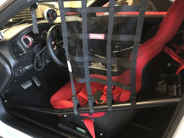

Something new! Stinky is warm in my garage and getting detailed. So time for some update stuff that got done..... checkout my new door bars. D09A7CE5-2126-4D0B-9F4C-9C6C34B2A82A.jpeg
