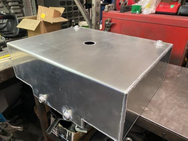

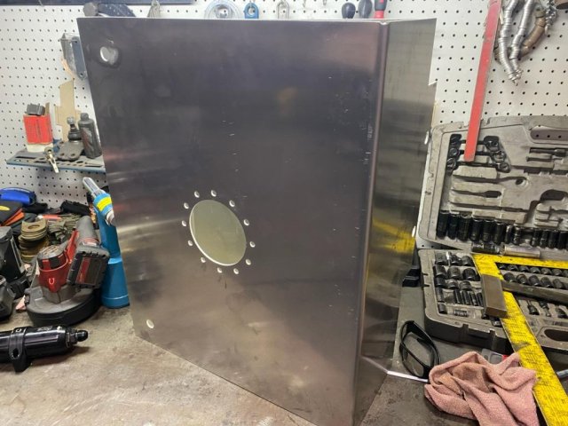

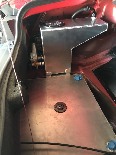

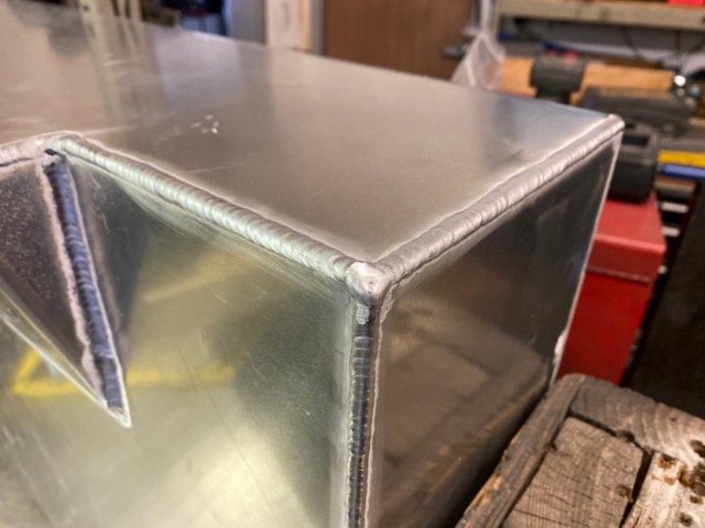

External. The 15 gallon fuel tank has a sump with two connections. One for supply and the other will be to drain the tank. This setup allows me to run less volume and not have any supply issues like we have with the drop-ins needing a half tank (weight) to not suck air. 79A8A3E9-06BE-44A1-858D-7656673B7B0E.jpeg 0E3D8F27-5B9C-4B1C-86AF-5FF60C5FF339.jpeg F3F1550B-7F7D-4134-BA9B-C01425AEEC4C.jpeg

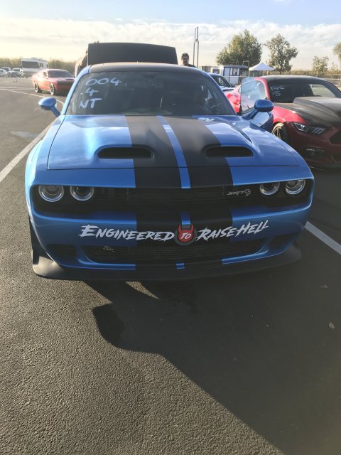

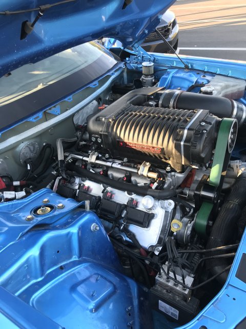

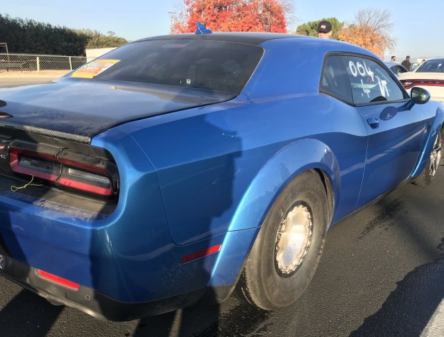

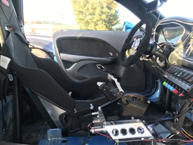

There are three of us crazy “out of the box” types here out west with me that are doing this. Joe is the other shop car (red widebody from Calif) ) and Brian (the blue one from here in Utah). Brian has really flipped his lid and gone full DragPak by gutting his 2020 Redeye. He got it on track for the first time two weeks ago in Calif at the Bakersfield event and made a couple get acquainted passes at low power just to see how the new rear behaved. He ran a easy 9.1 at 153 mph and said it was on a rail. He said it was the weirdest thing because it felt like he didn’t even need to have his hands on the wheel. I honestly can not say that’s how mine feels now (to say the least!). Looking forward to a more “planted” driving experience. I’ll add some pics of his car at that event. Got the spring height adjusted and it is looking real good. 3498A459-230A-46E9-9996-1E971D2F76E4.jpeg CDCF7E68-A36D-41C7-8AD5-6D24469F0170.jpeg 6A21713F-F355-4667-AC18-CAC01CC0AF45.jpeg CDF4F7BD-4938-4438-8F90-57A6777B91AF.jpeg

There are three of us crazy “out of the box” types here out west with me that are doing this. Joe is the other shop car (red widebody from Calif) ) and Brian (the blue one from here in Utah). Brian has really flipped his lid and gone full DragPak by gutting his 2019 Redeye. He got it on track for the first time two weeks ago in Calif at the Bakersfield event and made a couple get acquainted passes at low power just to see how the new rear behaved. He ran a easy 9.1 at 153 mph and said it was on a rail. He said it was the weirdest thing because it felt like he didn’t even need to have his hands on the wheel. I honestly can not say that’s how mine feels now (to say the least!). Looking forward to a more “planted” driving experience. I’ll add some pics of his car at that event. Got the spring height adjusted and it is looking real good. View attachment 33472 View attachment 33473 View attachment 33474 View attachment 33475
