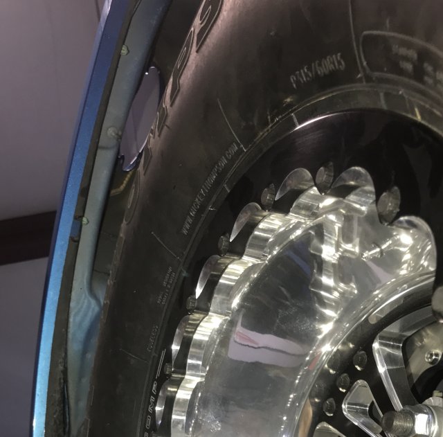

Yes it will. No more than mine. These are the same tire I’m running and to keep them inboard as much as possible, there’s a area that needs some aggressive attention with a saws all and the big hammer. Nothing that isn’t doable. 6A493DBB-6C60-4F58-BB5C-6091D39A98F2.jpeg 8C2C60D5-A360-46BF-B896-D2E1FF839B9C.jpeg E8A9B4E4-57DB-48C3-A1D5-72A67C913146.jpeg

That's not bad acutelly. I would have assumes some new wheel tubs

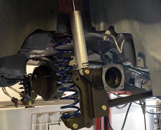

This is the previous (to the current) version that was in the Dragpak. The new ones are coil over now and that of coarse will be a option. When I buy mine, we will have that discussion. This is the first one that this shop in Calif is doing for us and these will be an evolving mod. I also like the setup on the new Dragpak just coming out that uses a wishbone to center the axle instead of a panhard bar.

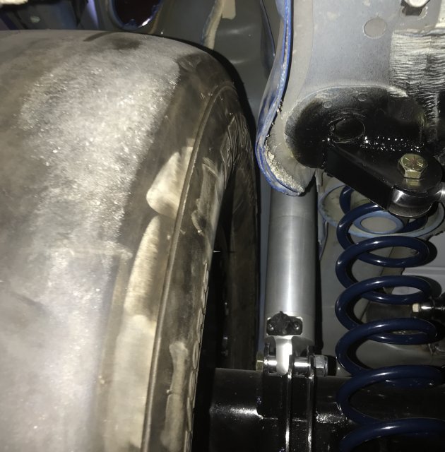

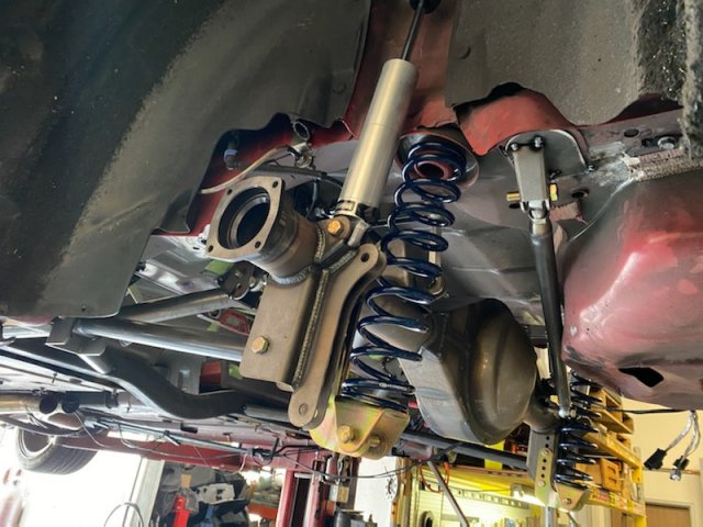

More pics of the 4-link. Damn. I’m starting to get antsy. Im starting to think about 7.90’s in a year from now. 🤔 E6478738-182F-48F0-B8B7-8AEE2A779325.jpeg 5A6BAB57-162E-4FD5-9F16-217AD1D060B1.jpeg B5669448-C1CF-4EE0-A9FF-68594431D2F6.jpeg

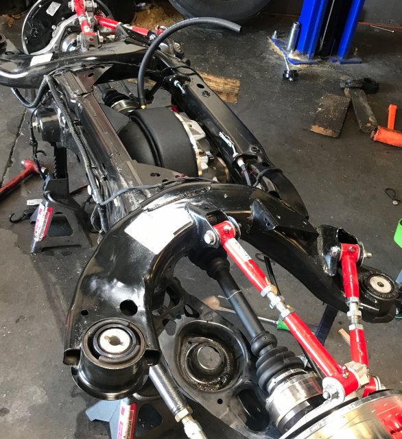

Don’t know what it will be exactly. 200+ at least just in the rear. Remember you’re pulling the fuel tank also and replacing it with a aluminum tank in the trunk. Plus With that you only have to run enough fuel to get down the track. None of the fuel pickup issues that forces us to run 10+ gallons in the stock tank. That’s 50 lbs right there. Wonder what this weighs.... 021366E7-939E-4F42-9A82-1BEE1A366812.jpeg

That's what I was wondering . That rear cradle fully loaded definitely weighs a few pounds .

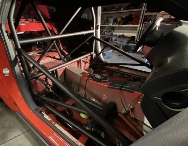

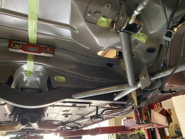

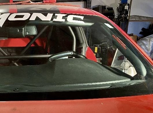

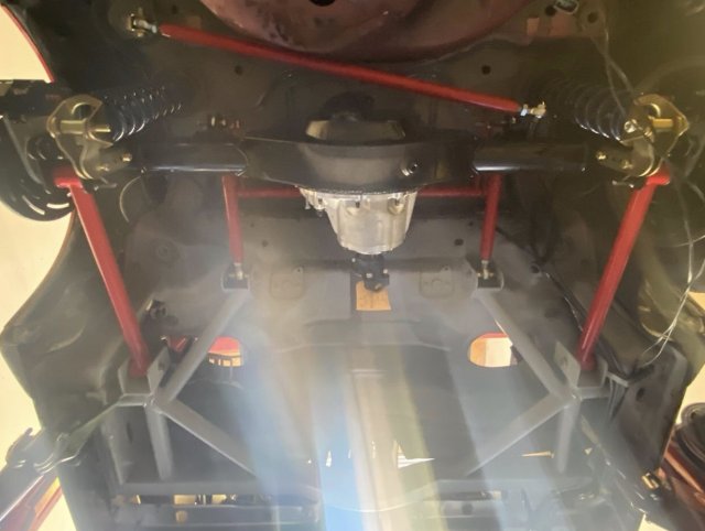

Within about two weeks now of getting this bad boy out of California and over to Arizona for the new trans and tuning. The cage is complete and just need to do the aluminum work. Going to have a lot better pictures for those interested, but here is one that shows how this thing ties into supporting the new 4-link suspension. 85D63B0D-C82E-487B-B54C-9597EAE48662.jpeg A4E59B79-BAA0-483F-89FD-7F57D219F366.jpeg
