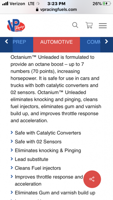

Octanium Unleaded formulated a bit different then past octane boosters, it does work well.
