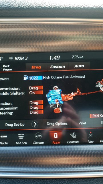

So far so good with everything. This Ho is handy with it detecting octane and turning itself on and off. My current HO tune pulls really hard and is honestly the fastest car have driven now. Mid and wot are just fast. The drag mode actually shut me down as it kicked out a bit far as it should. My tuner is a big part in this big power. Barth Tuning have been great in this whole process and my results show!
Please elaborate on what you mean by this.

Thread Starter #92
The stability is still on in drag mode but the traction control is not. I must of reached the peak of the rear kicking out b/c the computer straighten me right back up. First time it’s done that but I’m not out going crazy. I was enjoying part throttle power. :sneaky:
Could be handy if something where to happen at the track and you like to run with everything off.
