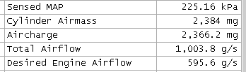

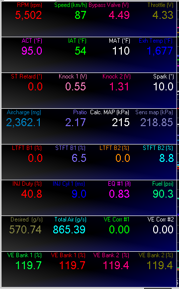

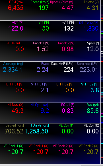

Well it was a good and bad weekend. I didn't get my transmission issue resolved but I think I'm on ther right path . But I did have a few good results . The new 315/50/17 street R's worked fantastic . No starting line traction issues this time . Also 145 MPH on pump gas ! I'm very impressed with that considering all the transmission issues I was having . I did not get 1 clean pass .
4,875
11,025
Thread Starter #1,968
As you can see from a few pics from my logs the car is consuming a lot of air . I'm running FIC1440 injectors and it peaked at 50% duty cycle on pump gas and 90 psi of fuel pressure .
Here is my theory in my transmission issue . The factory Pcm uses aircharge / airmass to calculate torque so with the large aircharge it's calculating more torque then the transmission is programmed to take so I'm hitting torque management on the transmission.
I guess I got a lot of research to do now on transmission tuning !

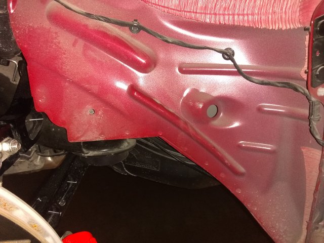

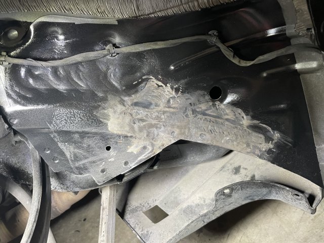

What magic are you using to get these to fit?
oilburner
#1135
701
1,793
coboconk
no magic needed , just a good hammer an heat gun an some spray undercoat when done.
or wheels that sit way out an look goofy.

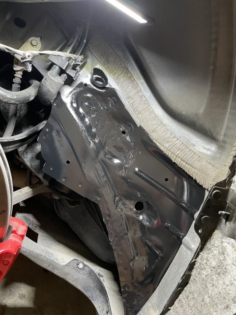

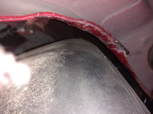

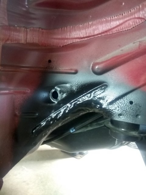

this is mine , before ,after an pic from below with tire in place
3,936
9,721
this didnt work for me, i beat the shit Out of the fender and used a torch.
4,875
11,025
Thread Starter #1,979
Like @oilburner said a decent hammer and a heat gun . The metal was the easy part I only "massaged" what I had too . The inner fender takes more time as it keeps popping back out .
I'm going to smooth out the metal and paint it so it looks factory over the winter . Then I'm going to give the stinking inner liners a good going ove too . I will take some pics when I do it .
3,936
9,721

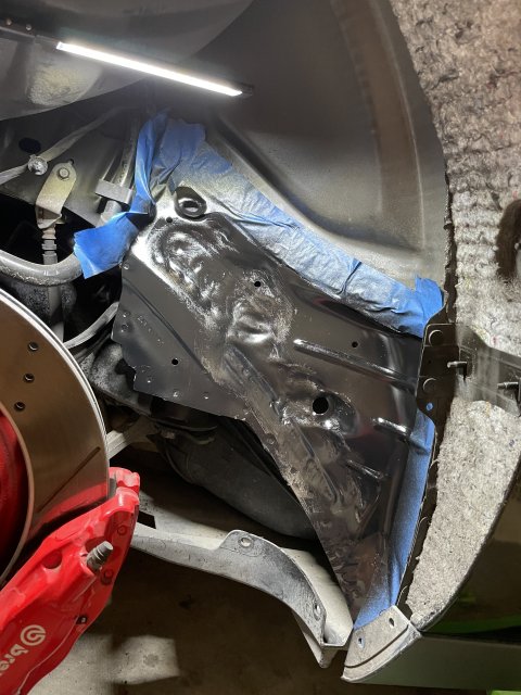

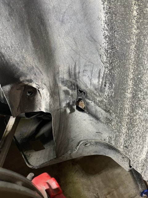

Did all this and still not enough room.
1E80AB55-1B28-4D85-8828-839971D3C53A.jpeg 41FB02E0-98F0-495E-AE3C-9010B6CF6B15.jpeg F4BE7A5D-5B72-4CED-A3ED-4683016FA83C.jpeg 01D0CC2A-C847-41CA-95C7-0634C1C31F84.jpeg
What else should I bang in?
