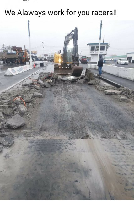

holy crap that`s a surpriseo_O looked OK on the weekend
Did you notice the cooling lines torn up.
Ronald did that almost 20yrs ago to cool the starting line on hot days.
yes I did an recall you saying about that on the weekend, they sure want repeat business, the whole family are great an make you feel important to them[thumb]

@Hpindy , @oilburner ,
If you look at the picture. It looks like the cement launch pad is getting extended down the track some. 60' maybe🤷‍♂️
So they are getting ready for me .....

The tracks website has them as open this weekend.
The cement will now extend 180' from the starting line.
Excellent! I love this track !

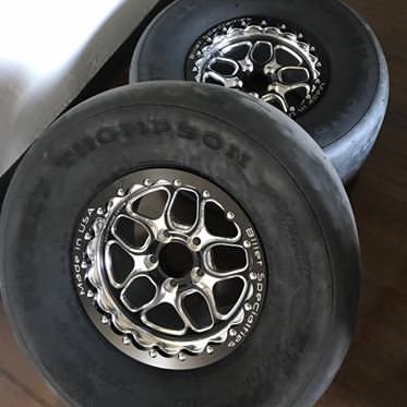

On the way home from the track my car asked me for some new shoes . Something more suited for her alcoholism .
