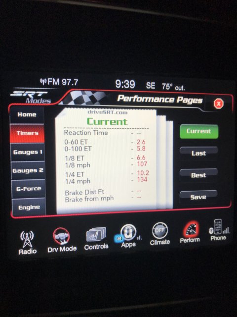

My hellcat thought it went 10.2 lol 92DACC3D-E74A-49A4-B70A-5BB95D6ED6B4.jpeg

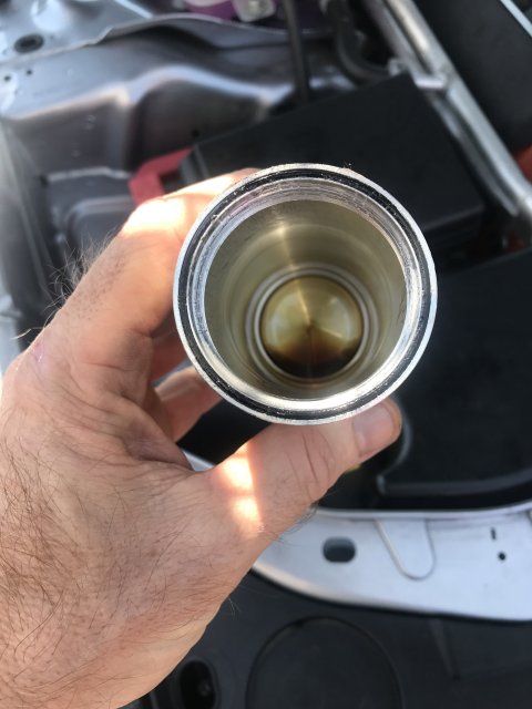

Not much blow by this is my catch can I just removed after running it this week 8EE220C4-34C5-4410-A5F6-E69144159730.jpeg
