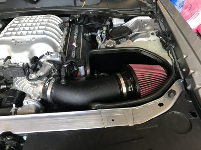

New jlt installed getting ready to install the cat deletes

I wonder if placement of the maf sensor is causing the iat to get cooler ,if it doesn't then id say because my stock blower is being spun at a faster rate now with the pulley change then its just creating more heat
