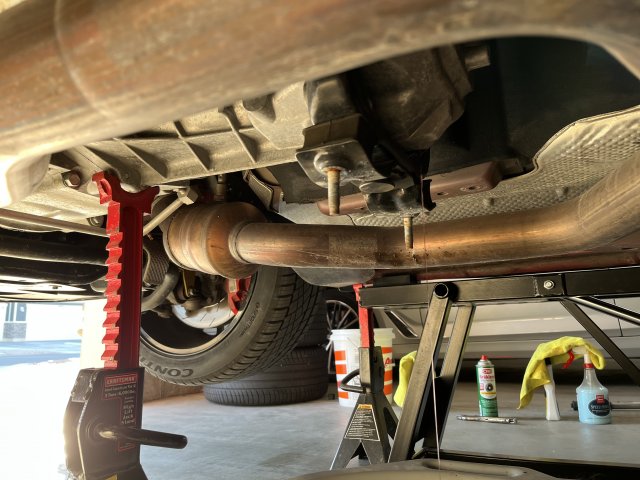

Well I changed the trans fluid this morning. My initial impression is - it didn’t make much of a difference in shifting quality. I think it did quiet down the trans a bit though. Have to put some miles on it before making an actual determination though.
I did the clutch bleed procedure too, which just consist of pumping the pedal. Service manual says “up to 200 times”. Didn’t seem to make any difference either.
Definitely remove the crossmember, makes life so much easier and almost no mess. 6 bolts, 4 x 13mm and 2 x 15mm, torqued to 45 ft lbs. I supported where the it mates to the bell housing with a jack stand, worked fine.
And if you’re wondering what that other jack stand is for, well that’s just extra insurance for Mom and the kids if the Quickjack failed somehow.

While youre under there add the skip shift eliminator.
I probably will. Out of town next week but I’ll be back under there doing the oil and diff fluid the following week.
