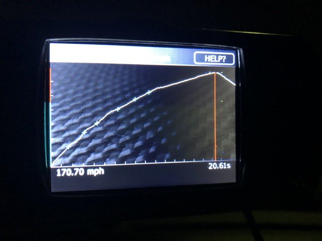

No, the damn TPMS sensor came apart. Recent burst to 160+ a couple weeks back most likely did it. Time for new fronts anyways. If I’m going to risk rim damage breaking the tire down to change it mine as well start with fresh front skins for the summer. Was a fluke find, thank God I got a bug up my ass today to change the oil. Think a shop changing the oil would have caught this??

Nope, still works just fine. Even with lasts nights trip to Mexico.

There’s many a loud car and bikes that run that bridge, it was the damn turbine wine that gave us away, could hear it screaming literally a mile, I mean 10,000 miles away :)
