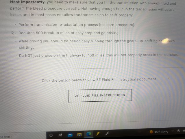

So I think I am out of my element here. Last night we installed my Pure transmission. We got it all buttoned up, did the fill procedure and got it ready for driving. We are following the guidance here:
https://www.puredrivetrainsolutions.com/break-in-process

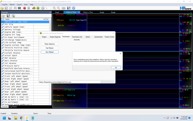

Mike's Wi-Tech couldn't locate a relearn procedure to run. We switched over to HP Tuners. Cleared all TCM and PCM DTCs. Reset all adaptives and then did the Fast Relearn procedure. Mike said it went through all the gears. Drove it home and it went into limp mode. Would not get out of sixth gear. Stopped in a parking lot let the car reset after turning it off. Went into limp again and got it home. Today, reset all adaptives, reset all the DTCs and attempted to do the Slow Relearn this time. HP Tuners gave me this error:
Attempted to do the Fast Relearn and nothing, same error.
Reset everything again and just put into reverse, backed it out of the garage and drove it. Went right into limp mode again. I'm kind of at my wits end with this car. I don't know what to do and I can't put any more money into it. I have reached out to Pure and hopefully they will get back to me soon. But if anyone has advice please don't hesitate to chime in. Tune, log and error codes are attached.

they are attached in the text file:
0x7E8: P0430 - Catalyst System Efficiency Below Threshold (Bank 2) (Permanent)
0x7E8: P1206 (SES, Pending, Current, Permanent)
0x7E8: P2096 - Post Catalyst Fuel Trim Sys Too Lean Bank1 (Pending, Permanent)
0x7E8: P2098 - Post Catalyst Fuel Trim Sys Too Lean Bank2 (Pending, Permanent)
0x7E8: U0140 - Lost Communication With Body Control Module (Permanent)
0x7E9: P0716 - Turbine/Input Shaft Speed Sensor A Circuit Range/Performance (SES, Pending, Current)
0x7E9: P0732 - Gear 2 Incorrect Ratio (SES, Current)
0x7E9: P1D90 (SES, Pending, Current, Permanent)
0x7E9: P1D95 (Permanent)
0x7E9: P1DF3 (Permanent)
0x7E9: U0001 - High Speed CAN Communication Bus (Permanent)

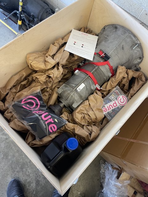

Spoke with pure again today, was told there were two, one ounce quarts and the two gallon container. Evidence A: crate opened upon delivery.
notice no two additional quarts.
I sent them the current tune and a log, they claim the TCM file was not stock, okay Ill play ball. Loaded my stock TCM file on. Same thing. Evidence B: my current tune and log file.
I don't know what to do at this point. Mike is coming over after work with his witech and see what he can do.

So they don’t allow the trans tune to be modified?
And you said you verified fluid level regardless how many quarts they sent , that why I like to get converter with mine so I can prefill it and I over fill it on purpose so all that needs to be done Is drain some out after test drive and resetting adapts and quick learn , but you’d be surprised how many do not get them filled correctly

Only 8 quarts was put in? That seems... short by a lot if the trans was completely empty. Invalid question, striking out.
Were similar procedures followed when fluid level was checked? See attached.
