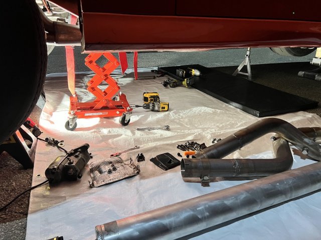

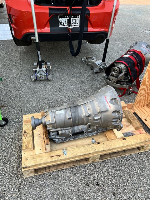

At TX2K this year in the parking lot, I used a Harbor Freight low profile trans jack on jack stands. I just needed to lift the front high enough to slide it out from under the car.

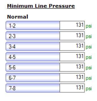

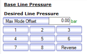

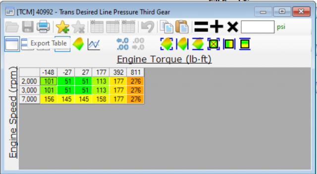

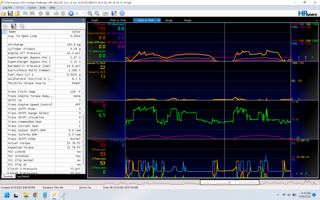

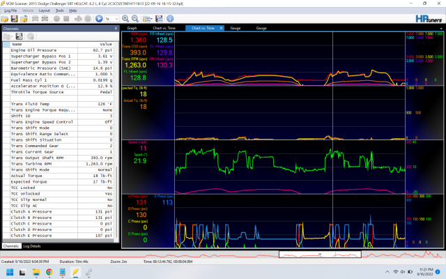

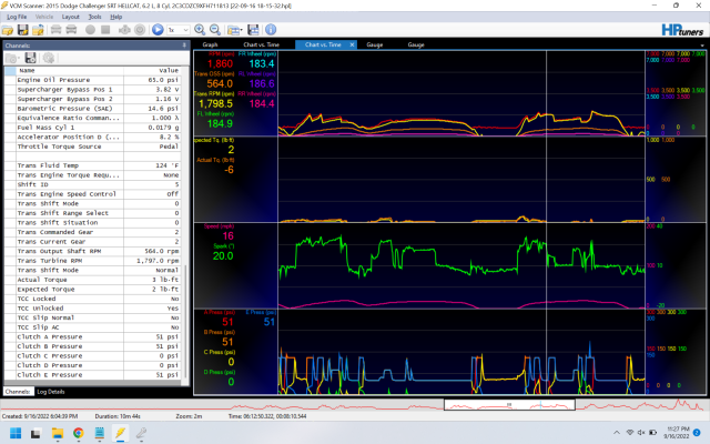

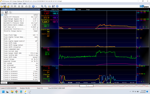

Losing my mind here. So Pure claims that the car needs some additional fluid, got the additional fluid and put in about two more quarts before I made a good mess on my garage floor. I started the fill as the car got to around 120*. Once buttoned up put the car in reverse, went in like butter. Reversed it out of my driveway, drove to the stop sign down the block, 1-2-3-4 smooth as butter, came down in gears just as smoothly. Then as I keep driving I noticed that as I go from 2->1 it bucks hard. Then it starts banging off 3rd gear again.
So some theory on transmissions and our clutches. We have 2 brake and 3 clutches, Brakes AB and Clutches CDE. To get gears 1 through 8 it is a combination of the clutches, for our purposes we will talk about gears:
1: ABC
2: ABE
3: BCE
If you want to find out what line pressures you will be commanded when in gear I suggest in HP Tuners you look at the following sections
So as an example we look at gear 3
If I spot check this in my logs, checks out:
So like I said everything was fine, car was going 1-2-3-4 no problem. Then I noticed as I started driving that it would bang off gears... Here is the transition from working to non working...
The log cursor splits it, on the left great, past it on the right, all hell breaks loose. Lets dig deeper...
Current Gear 1
Commanded Gear 2
A: 131 PSI
B: 131 PSI
C: Offgoing clutch, no pressure
E: Oncoming clutch, rising in pressure
where does this static 131 PSI come from?
All right so everything is tracking...
Current Gear: 2
Commanded Gear: 3
A: Offgoing clutch, no pressure
B: 131PSI
C: Oncoming clutch, rising in pressure
E: 131PSI
BAM, bangs off 3rd for no fucking reason....
Goes into limp mode and then it just a god awful experience. I am for sure now at my wits end with this. I have reached out to Pure as I don't know what to do. I'm ready to put it up as a roller for 50k, everything but trans, come grab it, drop in a trans and you'll have a 8 second car for sure. Log is attached.

So Pure and I have been in contact. They are very supportive. When the transmission was going into limp mode I started to log the limp mode fields in vcm scanner as it would just send the trans into limp mode randomly. After reviewing logs it seems P2227 has been prevalent all along. This code is the following:
Trouble Code: P2227 (6.2L V8 VIN 9 Auto) BAROMETRIC PRESSURE CIRCUIT PERFORMANCE Trouble Code Conditions: Print this code data  The Powertrain Control Module (PCM) detects that the Barometric pressure value differs from the other TOP Sensor by a calibrated threshold. Possible Causes: PCM SOFTWARE UPDATE POWERTRAIN CONTROL MODULE (PCM)
After speaking with a lot of people on the matter I went through all four of the map sensors. Cleaned and then reinstalled, even replaced o-rings as necessary. Couldnt get viton green so black neoprene will have to do! After doing that, cleared all codes, let the car sleep for an hour and it started the car. P2227 instantly and then limp mode again. So I sent out the two spare PCMs I have to be unlocked hopefully this might be a fix. Fingers crossed, if this isnt a fix then it has to get dropped and sent back.
