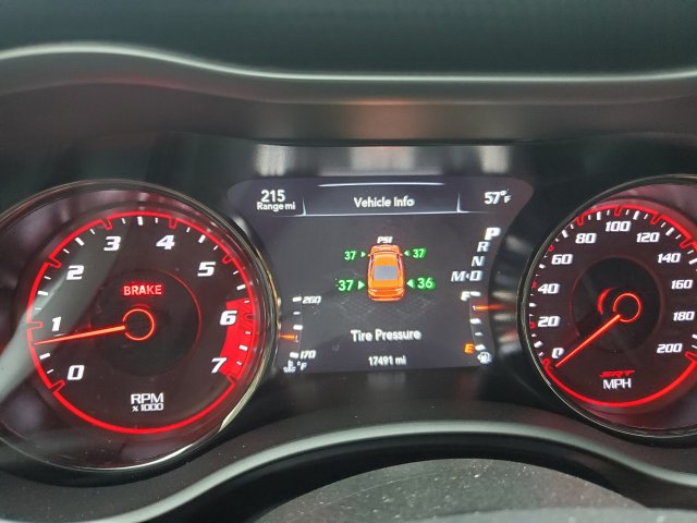

Drove for 45 minutes before work. Was able to cruise at various speeds between 80-90 mph, smooth as butter. Here are my tire temps when I got back and it was 57 degrees out. I mentioned some road noise when at 85 mph vs 75 mph in an earlier thread, but this morning was smooth throughout the 80 mph band. Have a great day all.
