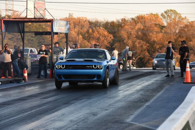

Made some clean passes at the MSHS final over the weekend. sadly ran out of fuel system and could not push it any harder, when I tried to get out of the hole harder it spun. ill spend some time this week researching and upgrading my non return triple pump setup. But 8.45 @163 boost only on a Whipple 3.0 so far. more to come when I have the fuel to go fast.

Making some progress here too. hope to get into the high 2's before the season is over. hopefully with some better DA

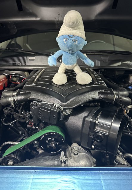

Took the training wheels off. Time to see what she will do with some boost. Haven’t been over 20psi on the new engine. So this should be fun!

Is that a nick Williams throttle body on the whipple?

How do you fit a 130mm on a 3.0???? Maybe you have a 3.8 that’s the only one a 3.8 bolts to with no adapter.
3,629
11,708
That is a 3.8. You can see where the snout steps out at the TB.

Just upgraded to the 3.8 this week.

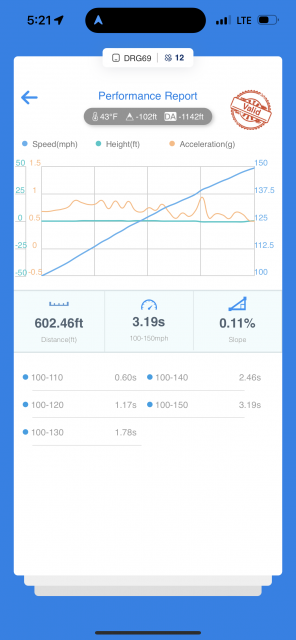

Have u tried that 60-130 on the street? Interested in what it does there.
I don’t do any street racing. Last time I tried was something terrible like mid 4’s with all kinds of power pulled out and spinning. I attempted a 100-150 on the street with some power but kept spinning. I think best on the street for that was like 3.75.

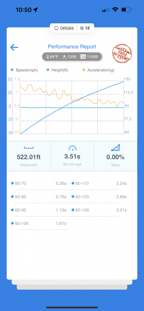

I'm getting closer to 2's. this was on the street last night. spun until about 115, then same problem as Saturday at the track. oil gets pushed into the spark plug tube and it starts to break up. the cornerstone covers don't work with the Stnake stabilizers. they hit keeping the cover from sealing around the spark plug tube.
