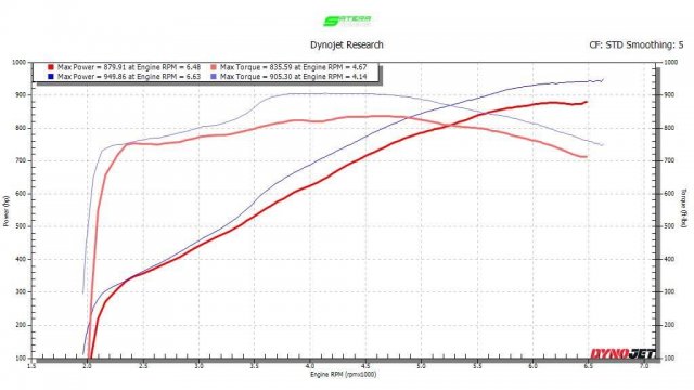

Full graph

Those are impressive results!

Nice. What is the difference in the tune of any between runs one and two if any? It was 108 here today and although the Tucson track opened last week I think I will pass for now.

Nothing. Just the blower swap

Not sure why anyone is surprised by the results of the Jokerz ported blower. I already posted my results from the Jokerz ported blower a few months ago here on this forum and it was very similar. I actually made more power with a 2.85 pulley and Jokerz ported blower compared to the stock blower and 2.65 pulley.

It really shows the capabilities of the 2.4
I’m sure we could get close to 1000rwhp territory with some ignite red.

Agreed, I thinks its possible to get 1000whp out of the 2.4.
