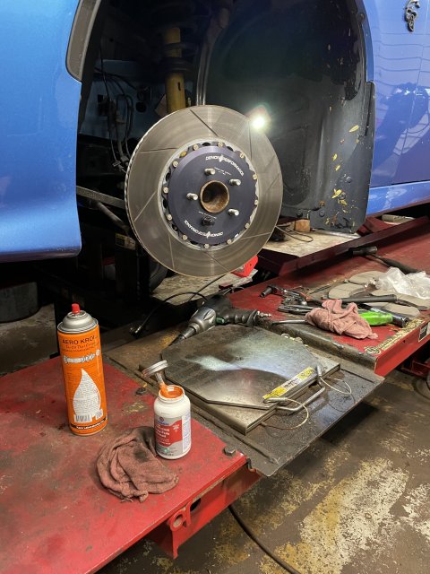

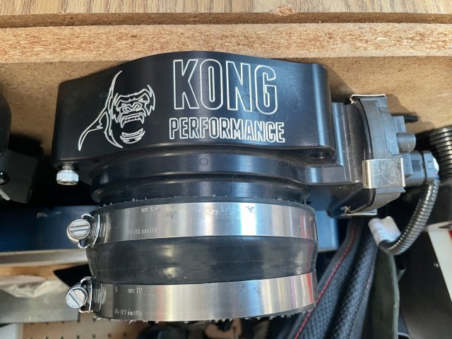

Preparing for the “off season”........I removed the front sway bar -15lbs with hardware and added these -12 up front as well. 30lbs off the nose should be nice for my next hits.....in April......😭

Always nice to remove weight, especially in the front, so those are the Demon rotors, did you have to do the Demon calipers too, with the rotors ?

They are an OEM replacement from Demon Performance. They are same setup as stock, but lighter by 6lbs each.
