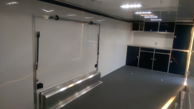

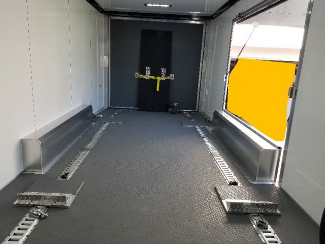

Almost none of the trailer side doors are low enough to open your car door. You will have to build up the floor to raise the car a few inches or get the aluminum trailer $$$ like Dave K has with the gull wing door and a removable fender. In any case, you need an open trailer. The 3.21 rear kills you. If you expect to tow on interstates at 70+ mph, you should still plan to get the adjustable load distribution hitch and maybe the additional anti-sway device.
My ATC is a great trailer. Tows like a dream. I'm actually pulling it right now heading home from Bradenton. I highly recommend 1 of these trailers or an Intec.
Don't forget to figure in about $5K in accessories that you're going to need for the trailer. I had to get ramps installed because the Charger is low, generator, spare tire setup, fuel can holder's, etc.

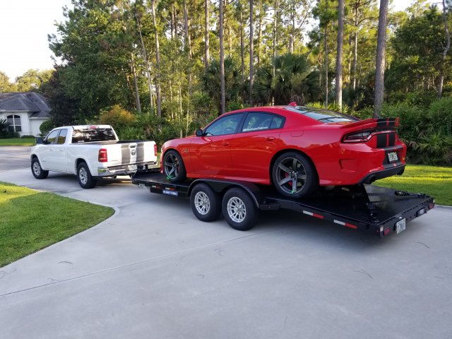

I don't like towing with a 1/2-ton at all, but if I must, this is about the upper limit. DSCN4642[1].JPG
This was a good setup with the 3.92 and the etorque. Not for the enclosed trailer.

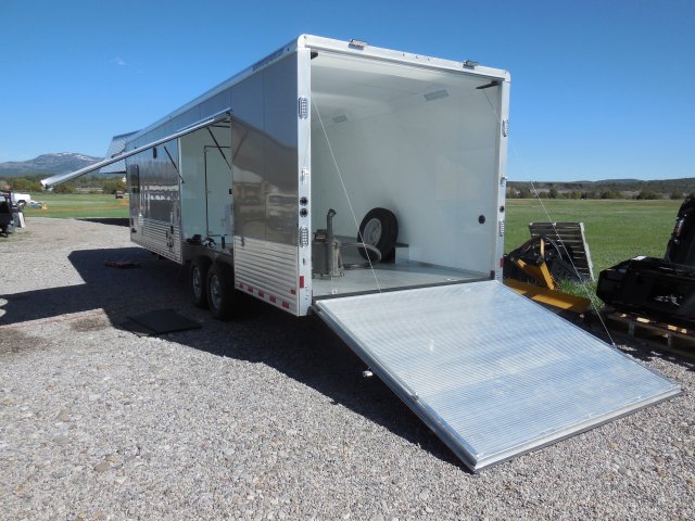

While the 4" taller than stock trailer makes the door of the Cat clear the fender, the rear door has nowhere near the correct approach angle, and even the breakover angle is much too high. Need about 8" of extra height.
Recently bought Race Ramps, but that seems to have been a mistake. Not only do those not like sitting on gravel (which I knew), but when I asked them about putting a small piece of plywood on the step for the door, they said I'd be on my own if I did.
Tried to explain that spreading the load of the door's edge couldn't possibly be a bad thing. Then I asked if it was somehow better to put the door directly on the ramps, like in all their photos, to which they said that I would be on my own doing it that way, too. Needless to say, those ramps are still in their unopened box. DSCN2629.JPG

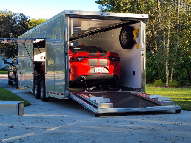

Look at the folded up ramps on my trailer. I had to get them installed because the splitter was getting torn up going in and out.

GOOD LUCK finding an enclosed trailer in that price range ! Trailers hold their values really well. If you're looking for a quality aluminum trailer, This 2017 ATC Quest 305 trailer was $23,000. I would probably get the same price because the new 305 trailers are near $36,000 now. If you're looking for a trailer with a side door, not all the wheel wells come out the same way. On an ATC trailer the well comes out without tipping it in first. If you have to tip it in with the car in the trailer you won't be able to get it out
Yeah, yours are what got me thinking about this again. Do you know what brand they are?
At this point a pair of 8x8x18 blocks of wood are looking appealing. Set the door down on them, then regular aluminum ramps (which I have) on the portion of wood that sticks out past the door.
Four more things to tie down somewhere, but at least the cost is minimal.

I just dropped it off at storage. They're called Pit Pal or something like that. I'm going to try a search.
You want to do this right. The splitter on the Charger got ripped getting caught on the edge of the main trailer floor trim strip.

My open trailer was a Suretrack with the diamond plate deck. Towed smooth behind the 1500. The ramp angle was a little steep so we had jack it up some so the splitter would clear.
Last I looked, it's now $8,900.
