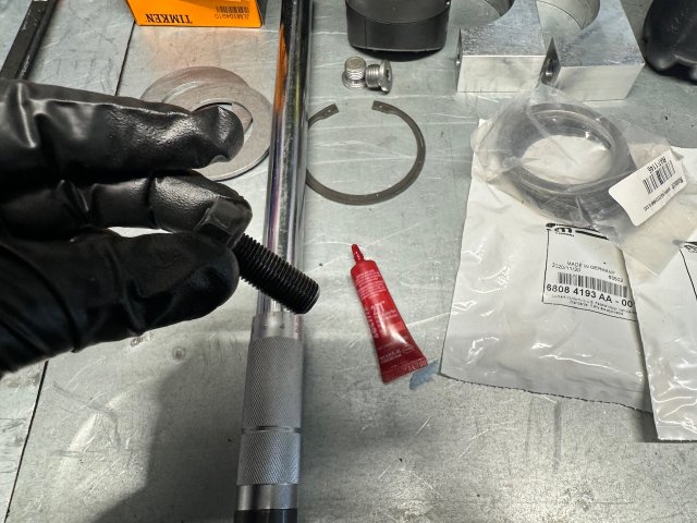

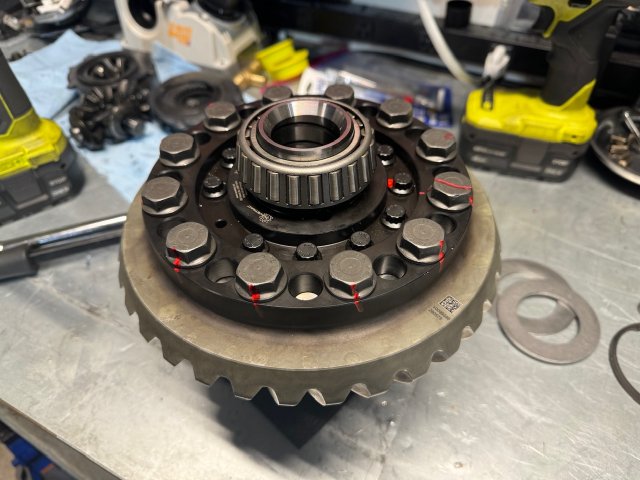

There are no published torque specs for ring gear. It got red loctite and ugga duggaz.

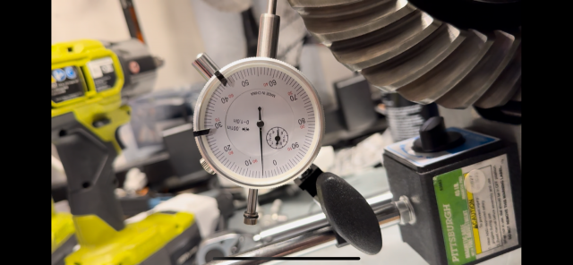

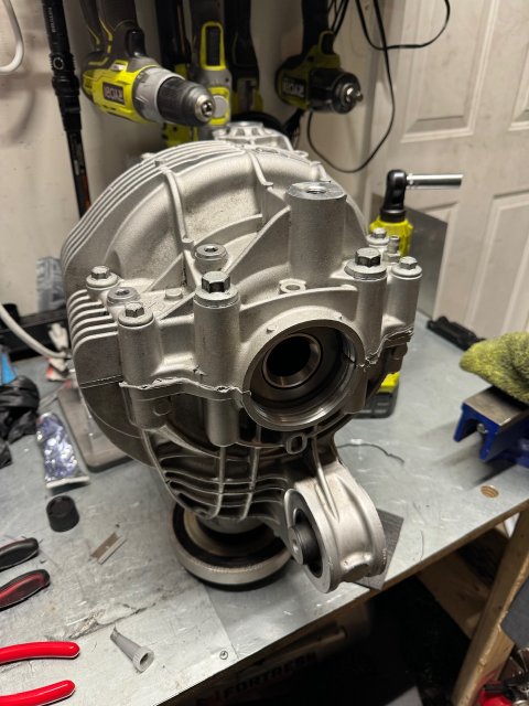

For reference and reference only. The original outermost shims must remain the outermost shims. To get close to the .004 backlash I went with one medium shim and two thin shim on the passenger side. One medium shim and four thin shims on the drivers side. Be generous with the rtv. Tighten a little and let sit for an hour. Come back and final torque. Small bolts 40ft/lbs, big bolts 90ft/lbs. Let cure for 24 hours.
Final backlash reading, couldn’t be fuckall bothered to try and get .004.

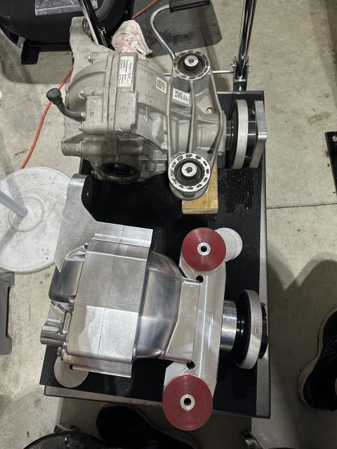

It is not in the car. The rtv is curing. I also don’t know when it will go in. I don’t have a lift and installing on my back on the concrete floor is not happening.
right now when i spin by hand it feels tight but keep in mind no fluid and lubrication cycles yet.

I use my harbor freight $100 little transmission scissors jack to change out diffs on the floor, it’s not too bad with one of those.
Tight, tight evenly everywhere or tight spots? Evenly everywhere probably ok. Did you check back lash in more than one place? Like 4 places at 90 degree increments?

Back lash in one spot, it is a circle, if the backlash is out in another location, whats the recourse? Add/remove shims and throw the original reading out of whack? Considering you have to do the caps every time, it gets annoying after try three.

Checking it every 90 degrees would be to just check the gears mounted runout on the new carrier. If perfect would not change, if out well depending on how much, .001 ok, 2 ehhh, 3 I’d have to fix it. It’s probably perfect, it’s just me, and he’s my “gots ta know” ways that would have made me check for run out.
